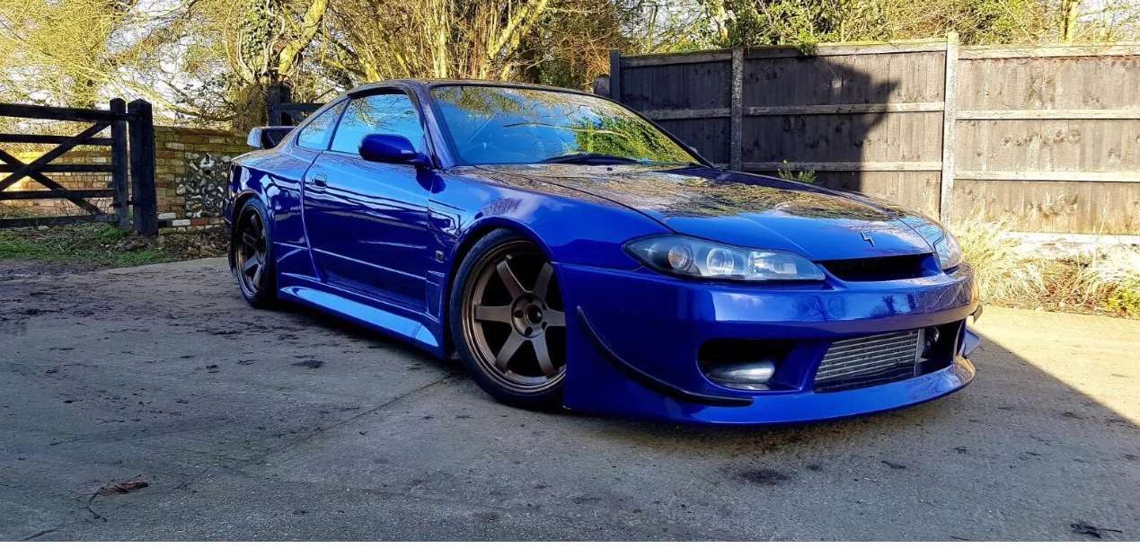

Hi, I’m finally an owner of a S15 Spec R! Thanks to everyone for the advice that I’ve received.
Loving the car so far, spins the rears in 5th in the wet, quite a scary car! �� (tends to always be wet in Blackpool)
Got a few things I need to do. Sort the front drop links out first of all. Some better rear tyres so I can actually go in a straight line occasionally.
Taking it to RB Motorsport for a tweak on the map, try and sort the idling issue and it's running quite rich. Also speaking to them about strengthening the bottom end and getting a G4 Link in the future.

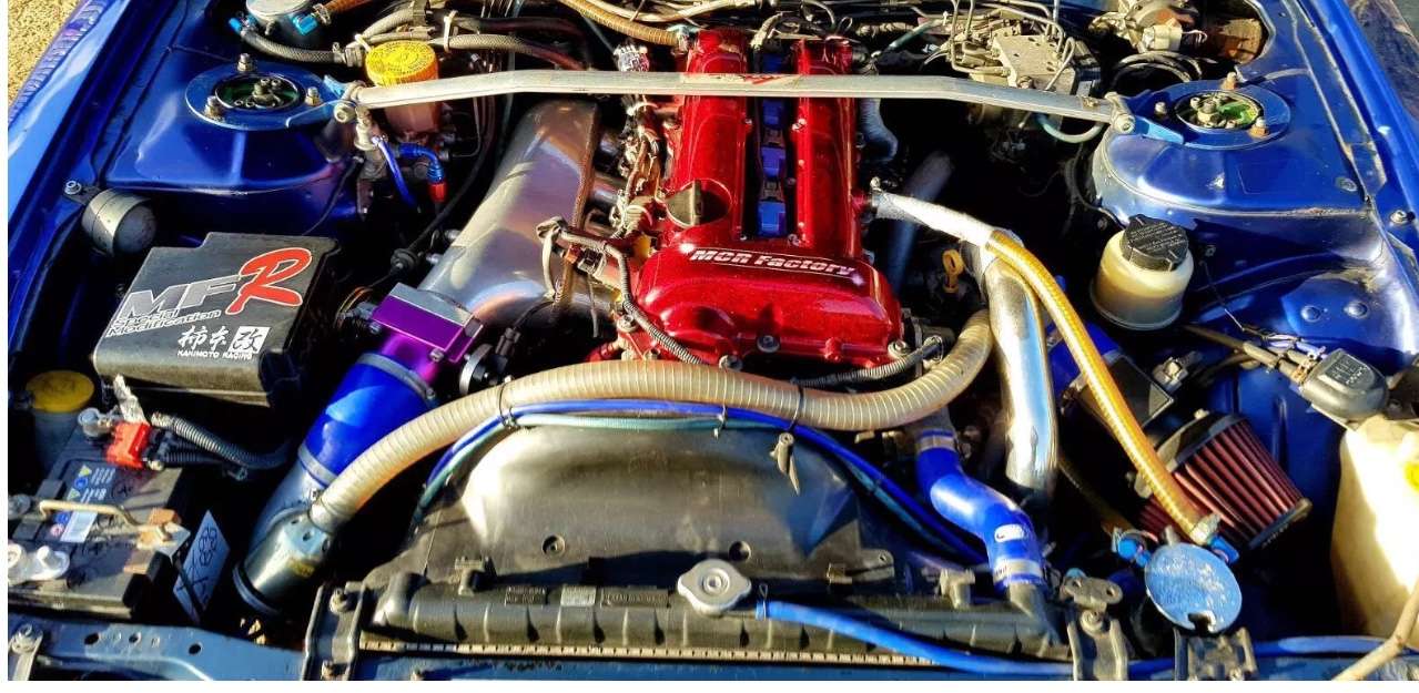

Engine
HKS super sqv bov with recirc kit
Hks fuel pressure regulator
HKS GT-RS ported turbo kit
HKS adjustable actuator
HKS EVC VI boost controller
HKS intake hard pipe
Densp iridium sparks
Sard 850cc injectors (screw m5x0.8x16)
Nismo fuel pump 4.1L/min
Nissan z32 AFM
Tomei ras kit
Tomei extreme exhaust manifold
Tomei N2 oil block
Greddy large alu baffled oil sump
Greddy pulley kit
Blits NUR spec r cat back exhaust
Moonface MF-R chamber pro (elboe/front pipe)
Sard ATC active torque control (replaces cat)
Samco rad pipes
Apexi power air filter
Apexi power fc with hand commander
Cusco oil catch can x2
Spitfire coilpacks
Spitfire DI bridge
Spitfire ground wire kit
Nissan z32 fuel filter
Fuch/silicone pro s 5w-40
Power enterprise super Kevlar belts set
Power flex poly-Urethane exhaust hanger
Tomei Type A valve springs
Tomei poncam type R 256deg 11.5mm lift ex/in
Supertech valve stem seals
Brain crower Ti spring retainers (BC2200)
Cosworth MLS head gasket 1.1mm
ARP 204-4204 engine head studs bolts kit

Anyways, hopefully I’ll be able to get to some meets local to me. I’ll also be down at Santa Pod end of March.
Some of you know this car, but here’s Blue :)

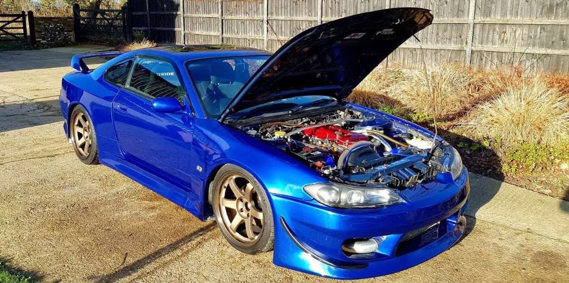

Well. After checking the car over a bit more thoroughly, it was the strut brace loose which was banging... saved me money there at least!
Getting used to the car, really can’t put the power down like he Subaru, but fun none the less! Gets noticed and looked at a lot more too I think.
Body work needs attention as you can see where the kits bond.
Sorted my washers out today as they’d been split and disconnected... probably because the washer bottle had a hole in it...
But that’s now sorted and a bit of rust has now been fixed.
Calipers have been touched up in black, along with a few other engine parts that had started to rust.
Interior lights now all sorted too, along with fixed rear light and an awful wind deflector job that decided to smart snaking my window down the motorway!
Updates will keep coming :)
Loving it :)

Had it in at college the other week. Fuelling is everywhere and drops boost. Only made 358 at the crank.... which was disappointing.
Need a Link ECU and then I can't run mafless, as the decent maf was taken off at some stage and a standard one put on. The actuator needs upgrading too.
I've sorted a nice cold air intake to the induction kit, so hopefully bring the engine bay temperature down.
