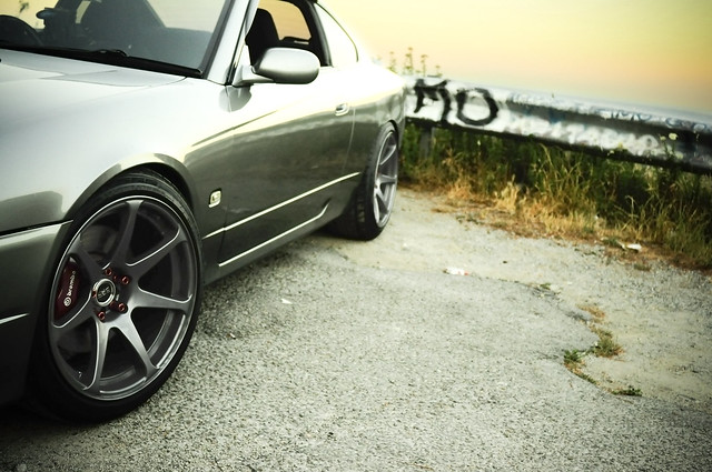

Anybody can tell what size wheels and offset are these??

Hi, Here's the beauty... I want this wheel setup so bad....:smitten:
have you got wide front and rear arches/fenders as if not then it doesn't matter what the offset is, they won't fit your car ;)
for info they look like rays volk racing te37's.... if you are rich then buy them, if you aren't so rich, rota do a design based on the te37 called the grid drift, which would be 3 times cheaper at least unless you got a massive bargain on used rays wheels....the downside is the rotas are heavier and not forged, plus they dont have the stickers to prove how minted you are :D

hope that helps. comfortable offsets for standard arches are 9.5 rear et30 on 255/35 and 8.5 front et30 on 225/40. some people run a 9.5 front with a stretched tyre but i don't know the exact fitments. this is what the 9.5/8.5 setup fits like
