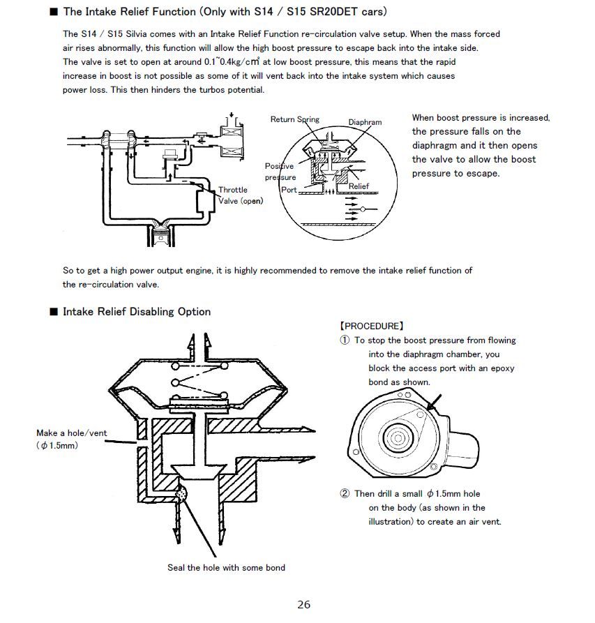

sorry didnt see this, its a breather hole to allow the diaphragm to operate as it should after blocking off the boost side bypass hole.
Its a thing i discovered that tomei instruct all people who install there uprated turbos when running other factory components like the factory BOV
this will explain it, its from tomei and comes with the new arms turbos

Hmm that's interesting, I fail to see a need for it as all you are doing by sealing the stock hole is allowing the system to hold higher then stock boost, that's what that bleed hole was designed for to bleed off excess boost pressure . That's the first time I have seen that procedure..
