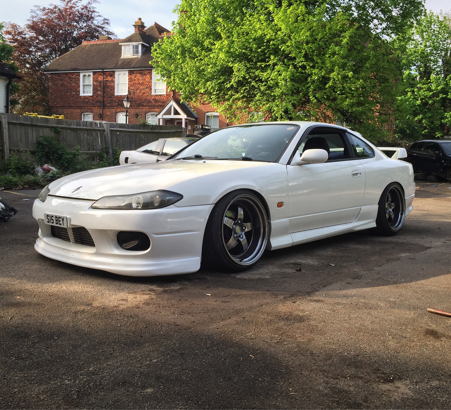

This is how the car sits at the moment with a 25mm spacer on the front. Will probably drop the spacer down to a 20/15mm with the new tyres.

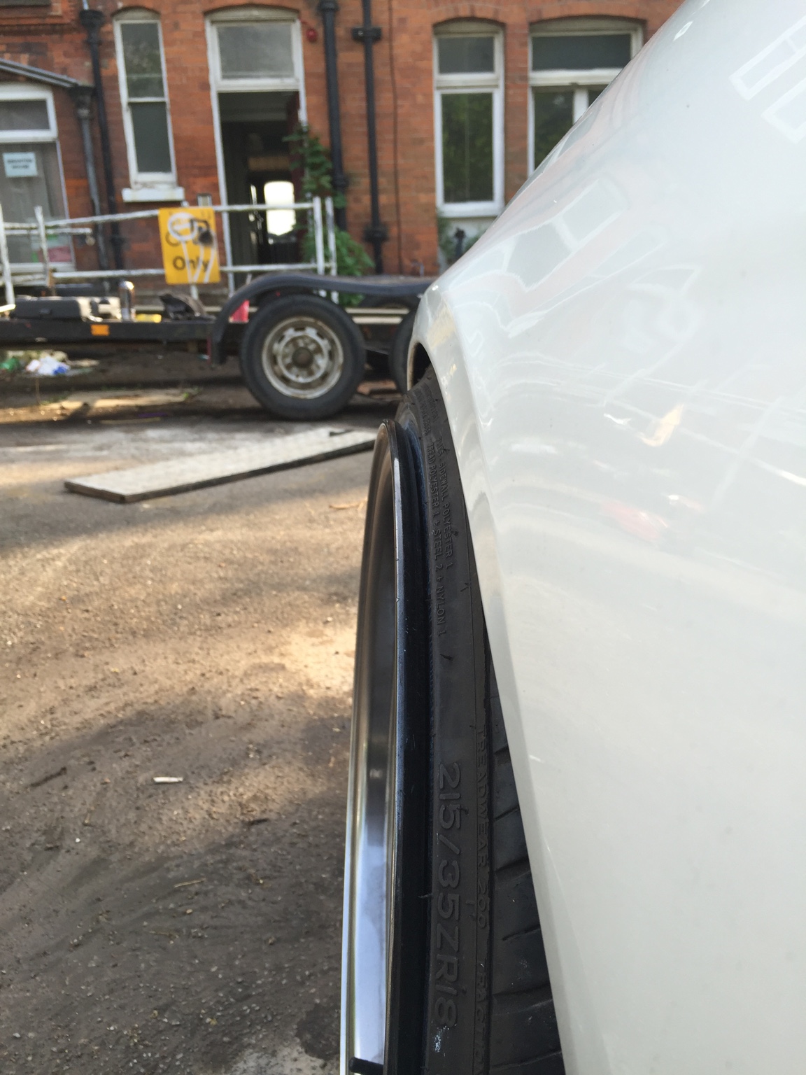

Little update incase anyone has a similar query in the future. A mate had some 215/35/18s kicking about so thought I'd try them on. The stretch is a little obscene however it's allowed me to drop the front suspension another inch and I now have no clearance/scrubbing issues whatsoever.
225/35s would probably be just as good with a little less stretch but these will do for now.
