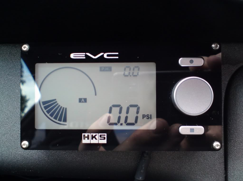

Started fitting my EVC6 today and still trying to get my head around all the settings. It seems like a really good bit of kit but I think it may take a while to get set up exactly how I want it :)

:) I've been playing a bit already! It looks really nice on the dash, and it isnt even mounted properly yet! I got mine from America so it came with English instructions. I'm yet to wire in the TPS, speed and rev sensors aswel. Not sure if the speed one will work well as my ECU thinks its going a lot slower than it really is thanks to the speedo converter messing with the signals. TPS should be enough on its own though.

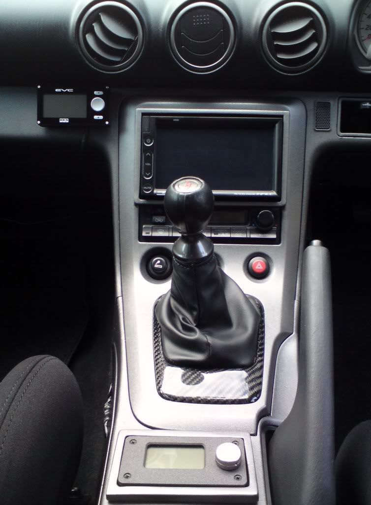

Still trying to decide where I'm going to mount the controller permanently. I popped in to see Martin at LittleKnocks on the way back from the remap with Jez today, and he suggested doing away with the cup holders and mounting in underneath the TC controller which seems like the best option. Could make a CF backing plate for them too! hummmm!! :)
