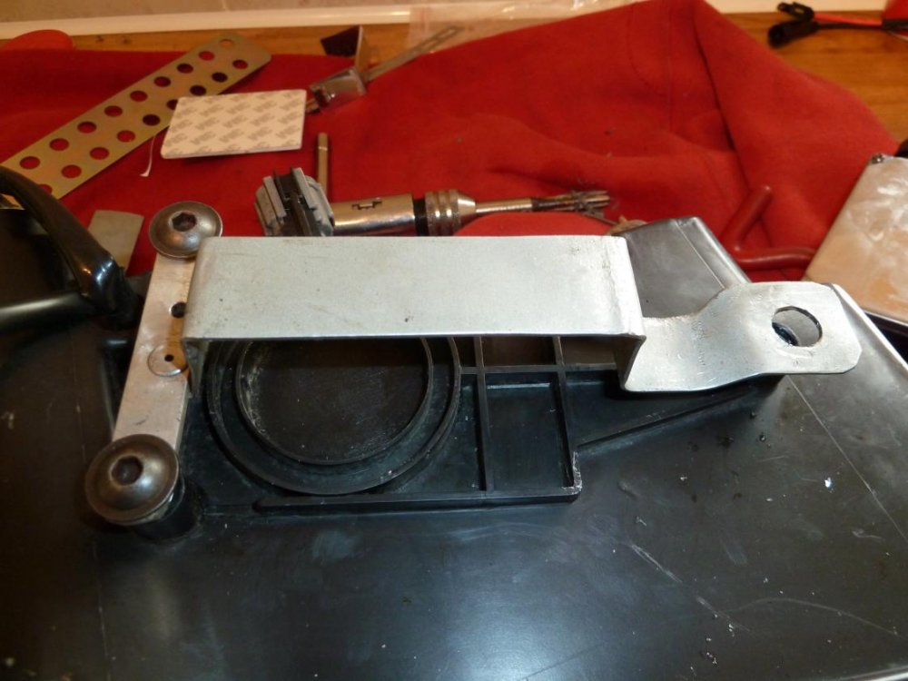

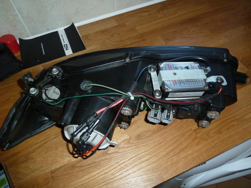

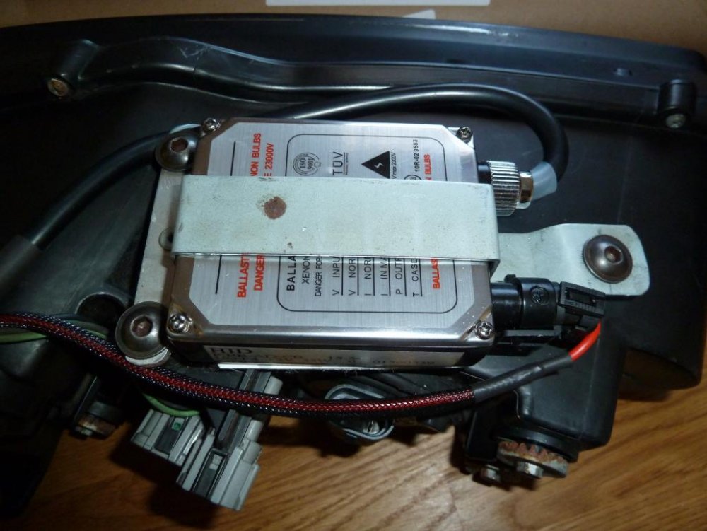

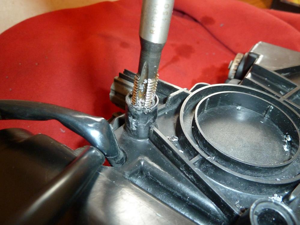

Picture 1/2/3 shows the underside of the headlight and the fitting of the hellicoils..
here's one of the bolt's fitted in the threads..
And a pic of the bracket fabricated from the metal strip.. pretty obvious how to make it I would think..
