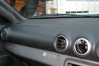

I actually have a three gauge holder from border, it's not the CF one though and it was made for the S15 but I am not sure if I want to use it on my setup, I like how the gauges look by themselves, more racer I guess but I am wondering on the running of the wiring for the guages, I don't wanna drill the dash. As for the S14 pillar pod I have I am keeping it for the project vehicle I have. The plan for the project car is to remove the air bag seyup and use the top of the air bag (cover) and create a mold to house the Defis in and have them angled to the driver and then also have it motorized so when the igntion is in the 'ON' position it will lever the stock air bag cover upward and reveal the three defis underneath. Yeah it is a little wild but it will retain the stock look when parked and would not attract anyone. I will be using A/C vent motors or sometihng of the sort for the levering of the gauges.

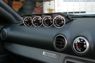

how about this CF gauge holder? it can be positioned on top of the airbag hole although its not covering the whole thing. but probably not easy to get since its from a small company in japan (FeizDesign).

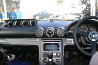

I understand what you're trying to do TriniGT, the pic explains all. Done by OK racing in Japan
The problem I see is if there's enough room at the bottom of the dash to allow the airbag cover to lower the gauges down.

Man ichi-go that is what I am looking at and thanks Yakozan the SAT NAV idea is perfect it will rotate exactly as I would need. Yeah and thinking about it the defis are daisy chain so there is only need for one pair of wiring to run back to the unit as the the sensor wiring runs from the unit itself, sweet. Also, the room underneath where the AIR bag is located should be more than enough for my setup as I am only housing three gauges in there and also the air bag location is deep enough I think. Will keep you'll up-to-date on this project.

TriniGT, didnt check if they flip down, guess they do. But one problem though, what are you going to do with the airbag light? Dodge it up(pull or totally mask the airbag bulb)?
