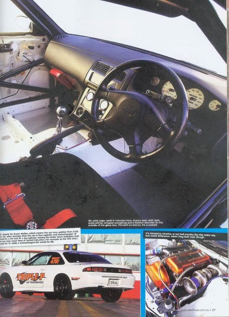

True but it would be heaver if you left that all in, in a fast fours article a guy saved 80kg out from his S14 by removing basically everything you are doing or are going to do.

ill see if i can find that article and scan it for posting.. it might be rather helpfull im sure the guy was making a drift or track S14, it had a list of all the items removed for weight
