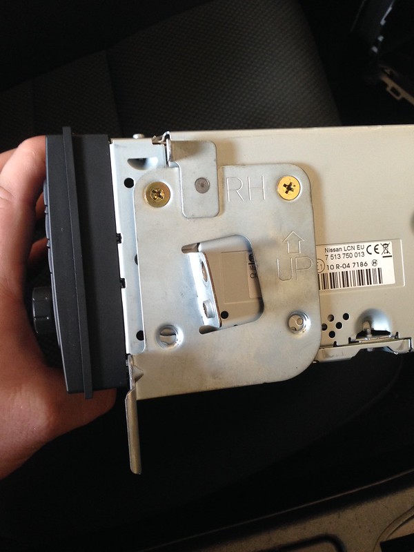

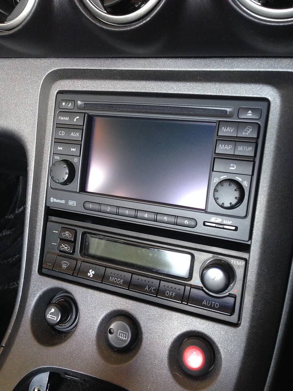

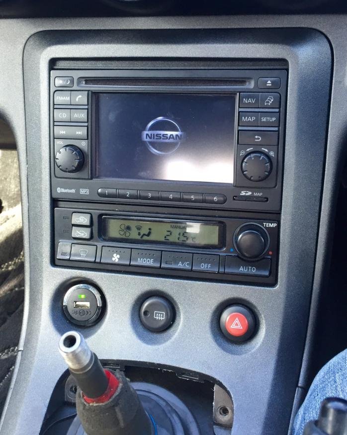

Awesome. I have mine in too, but GPS barely works due to the antenae location. I stuffed it in behind the headunit and there's just too much signal blocking metal in the way. Also, the FM signal is fairly weak. I would have pulled it out and sorted it but I've been getting on with other things so it's a job that needs to wait. I haven't bothered with the Microphone, but glad to hear you've managed it - I am kinda tempted.
Didnyou find your your headunit took up all the available space? Mine is slightly smaller so I had to get a piece of plastic cut down to make a small blanking plate. It does look the business tho, really sets off the interior and modernises the whole thing without appearing modified.

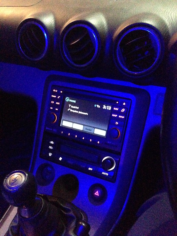

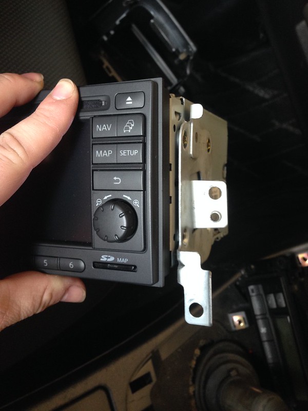

I didn't get many pictures but i completely installed it tonight and it all works still except for GPS. I installed my mic in the factory A-pillar boost gauge and it works great. Since my car came with two aftermarket headunits (one was gps and the other was a normal stereo) the bracket that held them in worked great on the new headunit, the way i mounted it i have a 5mm gap between the head unit and climate control. I plan to get a piece of black trim to place in between.

Ah wow, that's interesting that you mounted yours with the gap below and I went with the gap above. It looks good. Where did you put your GPS sensor? Or have you foregone that part for now? My GPS works, just not very well but when I get time I'll fix that. I'd love to see how you went about the creation of the microphone piece! I haven't bothered with that bit, but then I connected up my phone and it sounds really good through the stereo so I thought of you doing it and started to want it a bit more :D

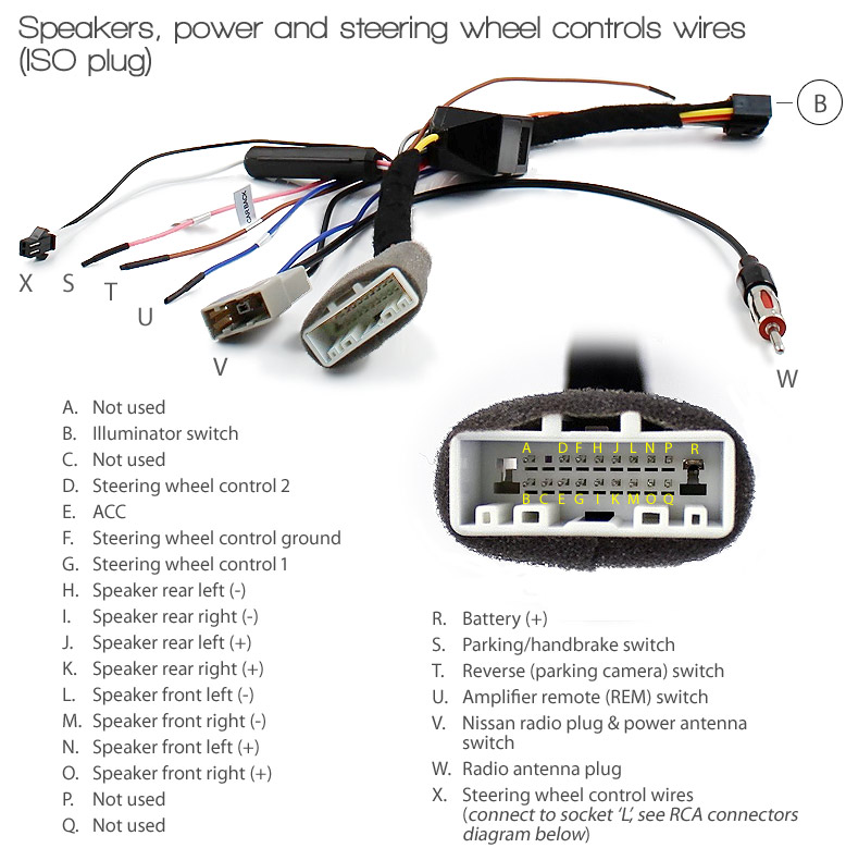

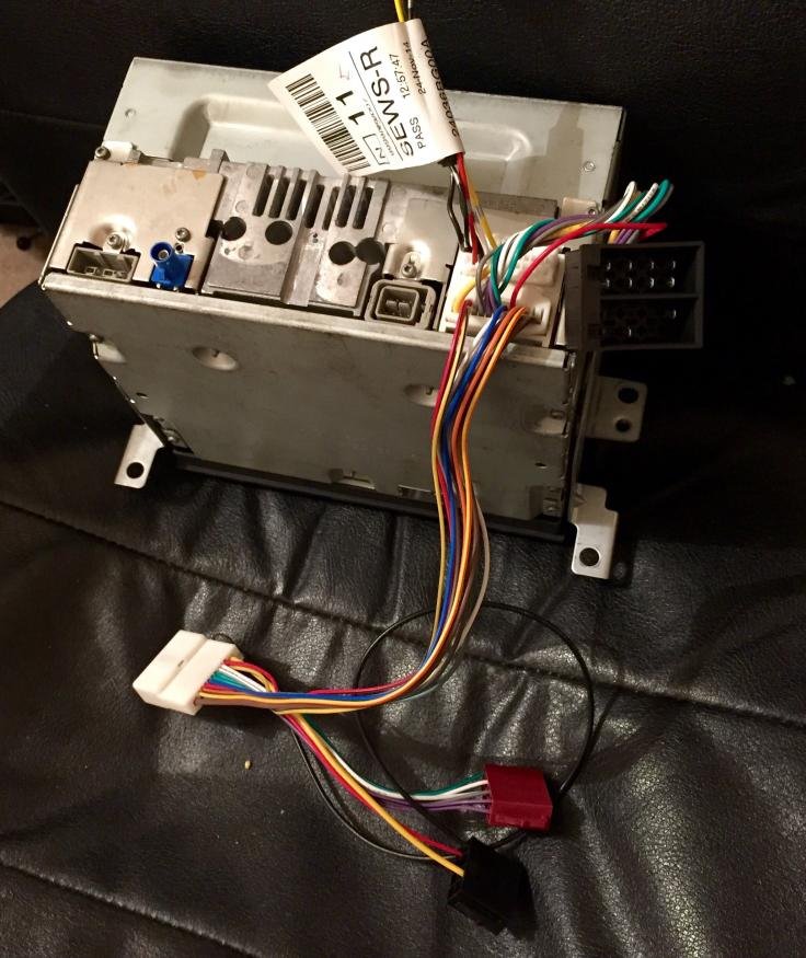

Hmmm. Can't seem to get illumination. Ive had GPS working, but only inaccurately so I'm not sure what I'm doing wrong with the antennae. I've placed it behind the speedo to see if I get better results there, you never know.
I think that although I have connected it up and can get sound and function from the unit, I must have the wrong wiring adapter kit. Can you take a look at the pic and see if you remember using the wires that go down in the pic? None of those are used in my configuration that I have which seems odd.

I will take a look on my headunit and see which wire i used for illumination, i remember some of the wires being labelled. I have attached a pic of the wiring pinout i used for our headunit, i'm about to go plug away at the car so i will pull the headunit out and take some pics!

I might have celebrated prematurely. Counting up the used/necessary wires it seems like I have as many pins needed as used. Hmm. If you get some pics I'll be super grateful. Would be good to know how many wires you think are needed in total. It is possible my headset is just broke but it looks like the buttons are design to be illuminated fosho.
im trying to work out the colour of the wife leaving my stereo for illumination. Isn't the yellow one? Gonna have another look tomo I think. Beer time now.
