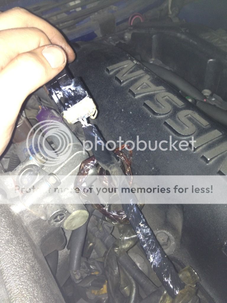

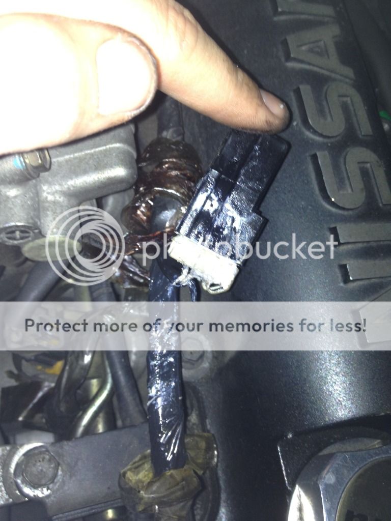

Also when I broke down I started checking the obvious like boost pipes etc.... Then I came across this, but I can't work out what it is? It's full of **** though, got like a slimy white paste over it and round the connections which I know isn't good. Here is a pick?
Any idea of what this is and what else I can check?

have you cleaned the maf?? other thing it could be is o2 sensor try unplugging it and seeing how it runs.
i ran mine with it unplugged for a few weeks while i was waiting for my new one. overfuels a bit but mine did the same as yours and when i unplugged it it ran ok

The O2 ? Yeah bro same issue I had with mine order a new one from the states was about £60

Yep? It caused it to stall, not start, smoke and back firing a lot! Lol

make sure you cable tie the connector well out the way! Dont want it melting!!!
Glad its sorted it will just run a bit rich ;)

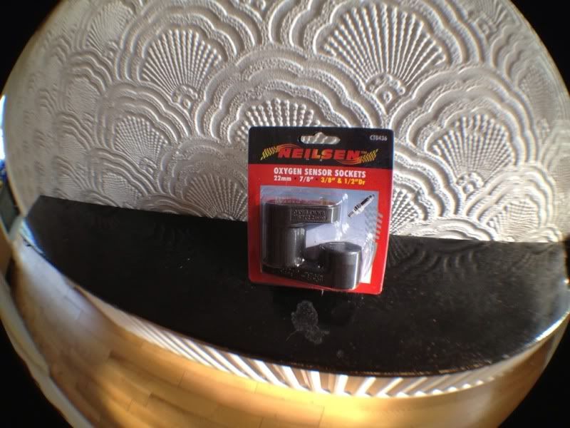

as for getting a new o2 sensor, i bought a brand new bosch unit for £80 from my local motor factors.
and i picked up this at the same time which made removal of the old one and fitting of the new one unbelievable easy in situ.
