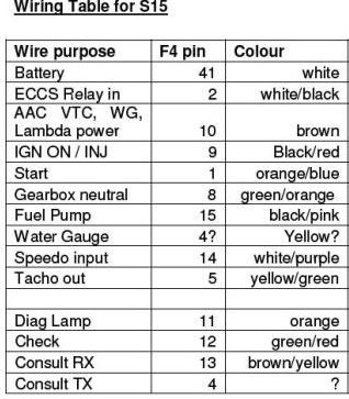

ECU pinouts ( im not sure if this covers the NA or just the Turbo only)

Also looked at the wiring table you sent definately doesnt match the ECU that I have as pins 5,8,10,12 and 14 are not used. I will most probably have to fit an aftermarket ECU and am looking at the Microtech LT8s with coilpacks.
