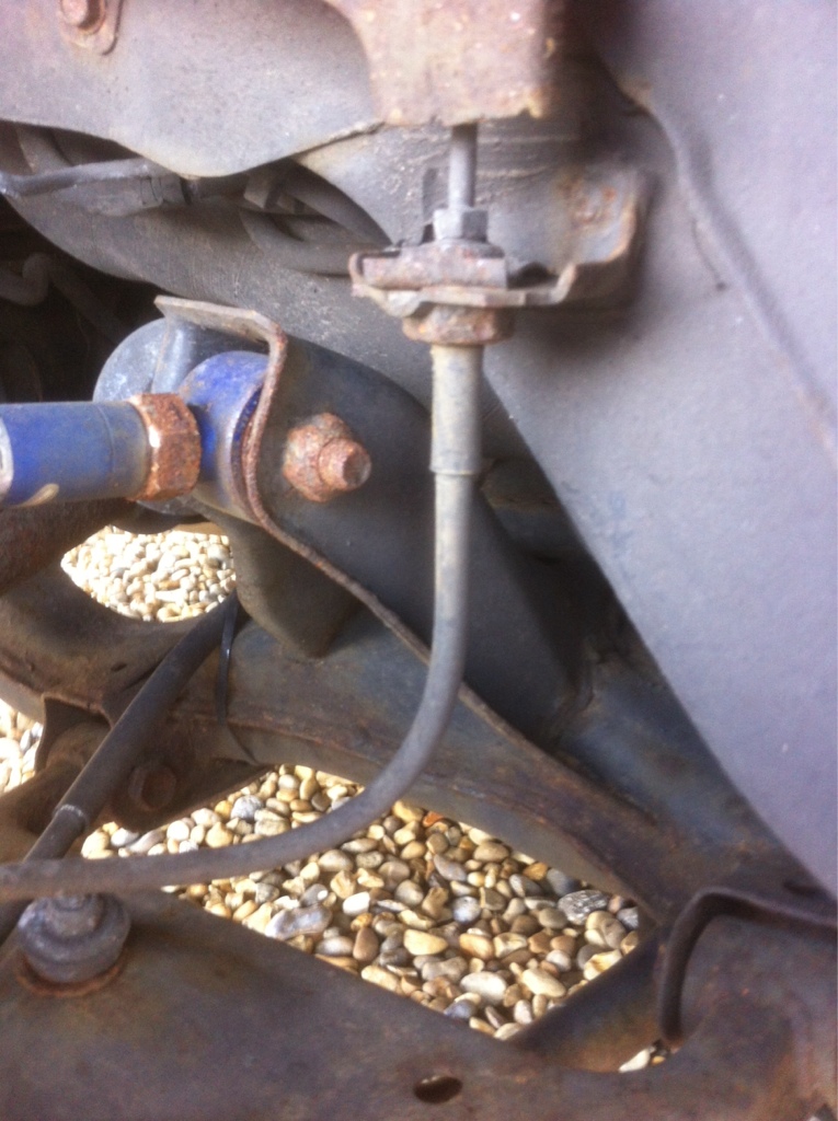

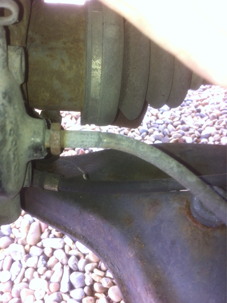

I've got r33 GTR calipers on the back of mine, pretty sure it's just a flexi but I can get a pic tomorrow if it helps?
I would be interested in a picture for each of the last two posts if easily done? Thanks for the info both of you in any case.

year mines the same, i just use a bit of hardline do direct the flexi line completely out of the way of the wheels
