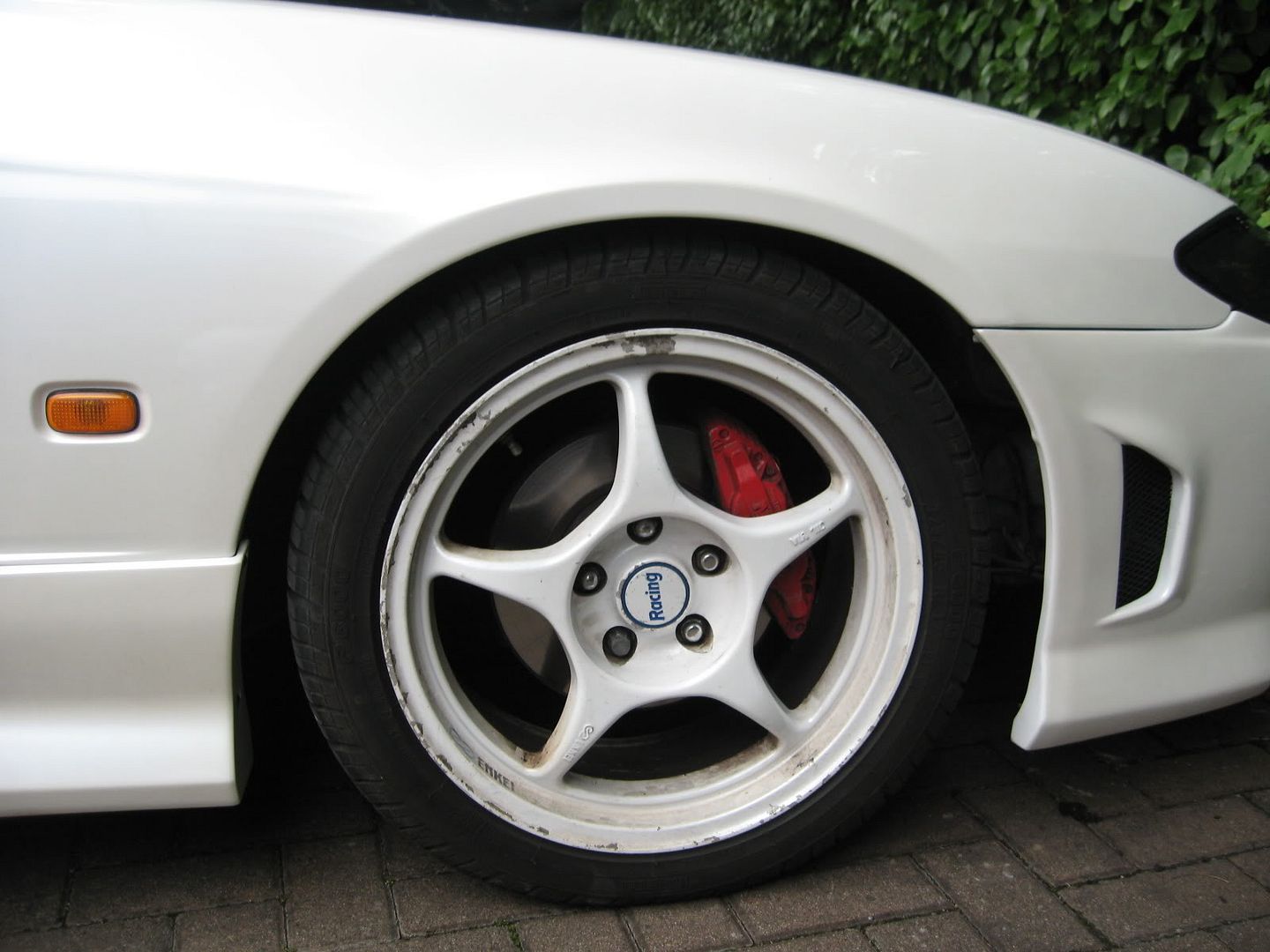

clearance at full lock with 17" alloys
new wheel
S15 SILVIA
You sure your car is running standard suspension?
I've got nismo s-tune on mine(20mm drop) and yours looks lower? Looks like you've got scrubbing going on already. I run 17s, with no clearance problems at all!
You shouldn't really have any huge clearance problems with 18s on standard suspension, so long as you don't go stupid widths or offsets!
What size are your current 17s? What tyre, wheel offset, width etc.
Also what size and offset ate your new 18s?
They do look lovely tho, so understand why you want em on!
Mike
M
miller81
I have 18x9.5 front with 215/40 tyres and 18x10 rear with 235/40 tyres fitted with plenty of stretch and lowered a lot on tein coilovers and dont have any issues with them..
mate, somethings wrong there.......as was said are you sure its not been lowered?
i run a 225/40/18 on the front of my car on an 18x8.5 (et30 offset) and its been lowered a fair old bit and could go further - the gap in your arch looks bigger than mine. i've only ever had it make contact a couple of times going over a railway crossing without slowing down and thats it (but that could also be thanks to harder damping/less travel).....
i'd have a look at the wheel width and offset and the alignment, theres no way running a mild combination as you say should normally cause problems unless somethings amiss with any of those three.
if you look at the arch gap, it makes sense why i think theres a problem :)

Few side shots of the car.
To have it that low you normally have to run coilovers. If you take a wheel off and post a pic of the strut we'll tell you straight away. If you already have coilovers you just need to raise them slightly so it doesn't rub.

S15 SILVIA
That has 100% been lowered.
Wheither it's by the means of coilovers or lowering springs, you would only know by looking at the struts themselves! If they have thread on the struts and adjustable platforms, you've got coilovers.
Also take some shots of the suspension arms, so we can see if you already have some uprated arms fitted already!
Usually with a drop like that you would need arms to avoid uneven tyre wear and sh!t handling.
At a guess, if you were to put your 18s on that as is, you would most likely need the rear arches rolling to avoid any serious contact.

To have it that low you'll almost certainly have coilovers. Lowering springs only tend to lower the car by 30mm and yours looks considerably lower than that. If you find you have original shocks you could fit a set of Tein lowering springs, which would raise the ride height from what you have now. If you have a standard setup at the moment, they are probably going to be cut springs.
