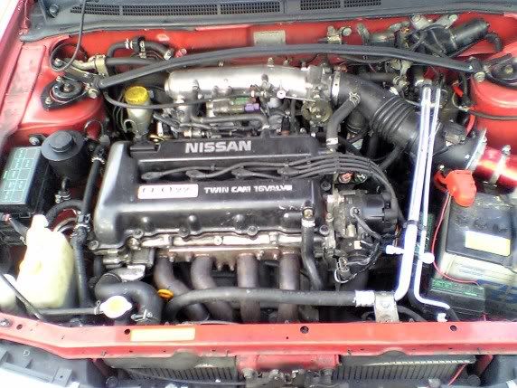

Its a mystery why Nissan dont propagate the NEO VVLs like Honda did with their V-Tecs. The NEO VVL N1 are only 1000 in production and is extremely rare. In my country the SRXXVE half cuts are in high demand transplanted into B13, B14, U13 and Y11 which are plug & play. I have only seen one SR20VET going into one N13 in my country. The down side is the some VE parts are equally rare.
Here's the local boyz passion for the VET... pardon the local language, its the pictures we are keen.
