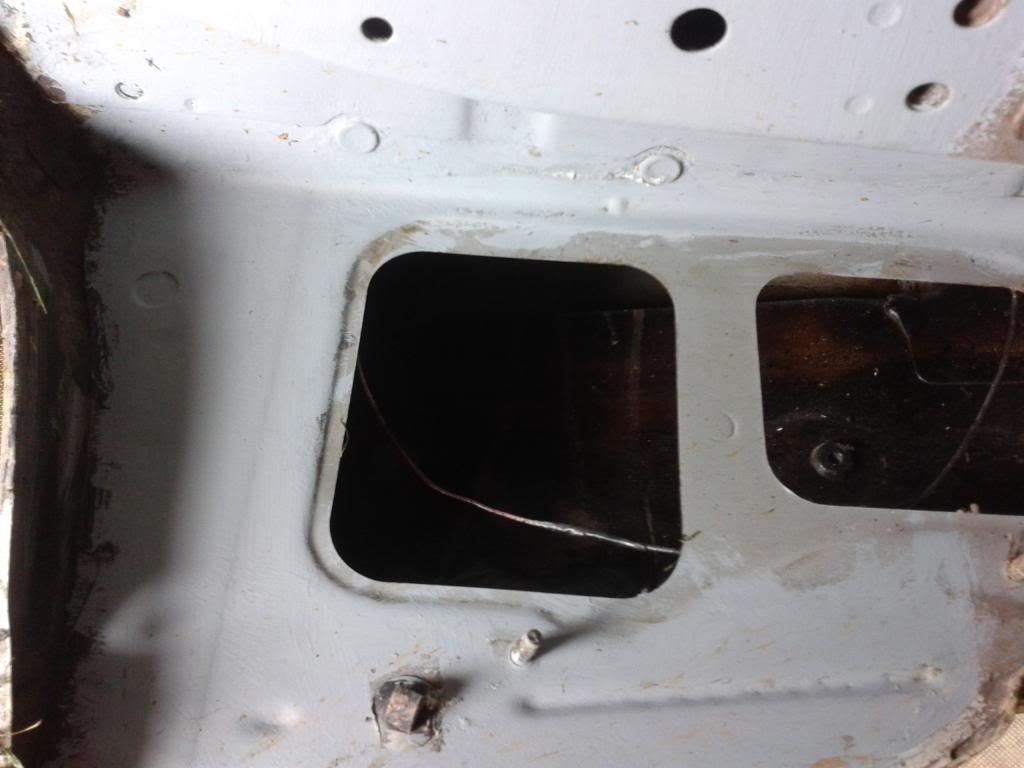

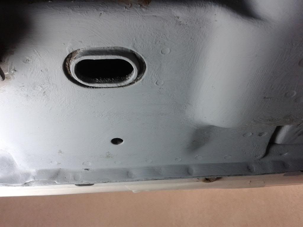

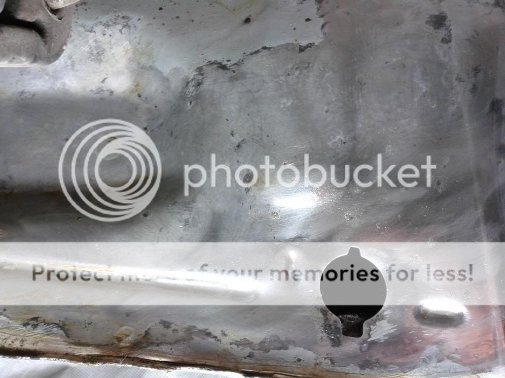

The inside of the boot looked like it had just a little bit of rust so i started picking at it.....before you know i had the dremel out and after i got rid of every bit i was left with this
Several coats of galvanizing spray
Primer

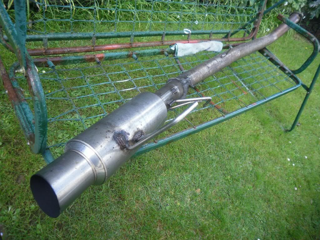

Picked up a few bits-
Pearl rear bumper
Aero skirts and spats

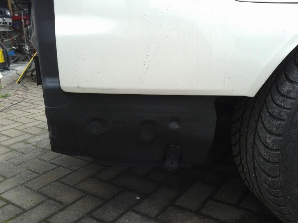

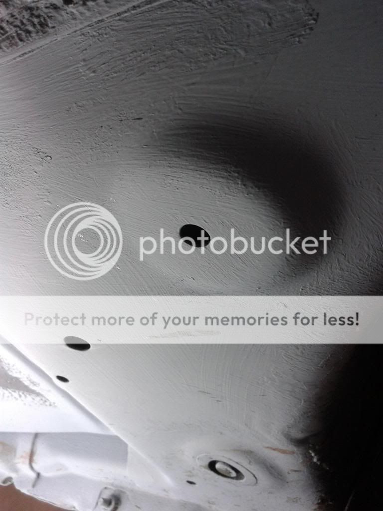

Decided to fit the rear bumper and whilst it was off thought I would paint behind it
I removed the old paint and gave it a coat of white, the bits you can't see were given a layer of stone chip
The number plate light was caked in paint and you could barely see it at night

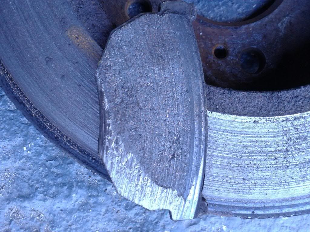

Replaced the rear brakes as they were well worn lol

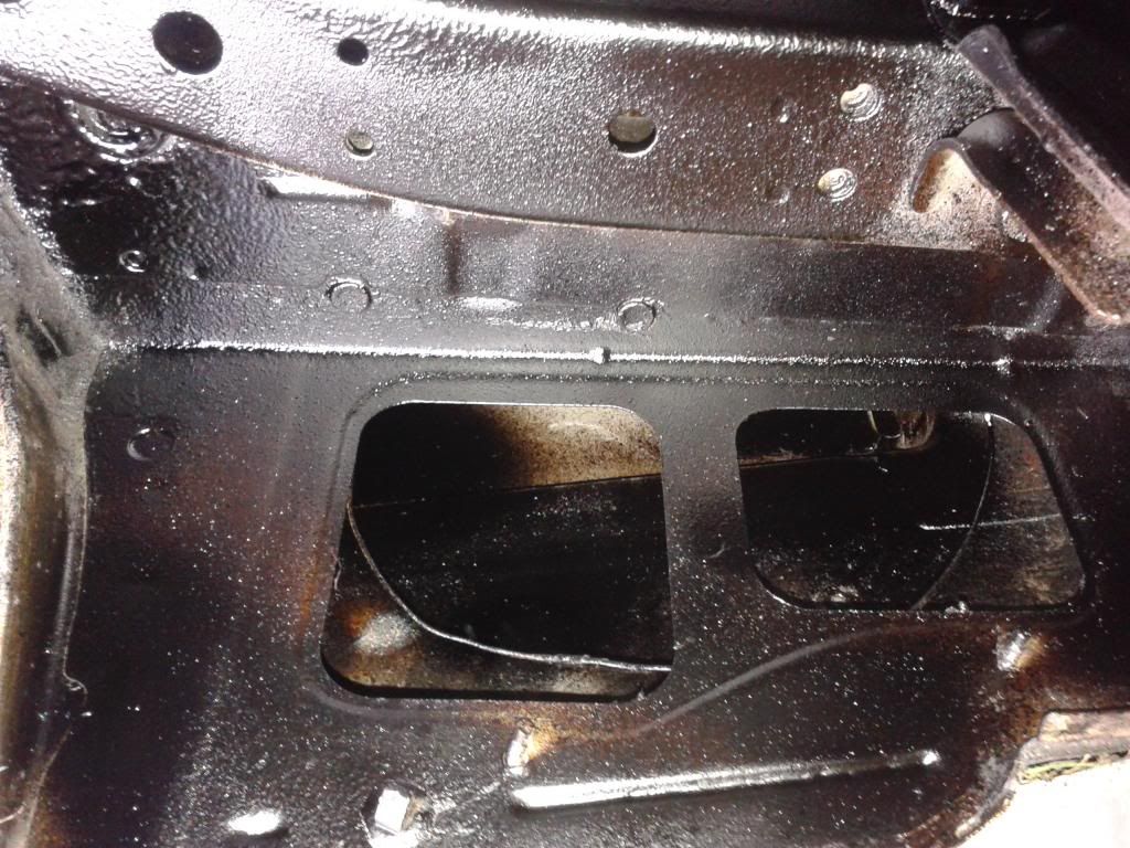

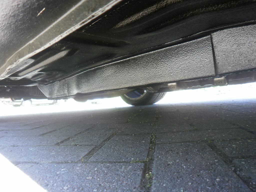

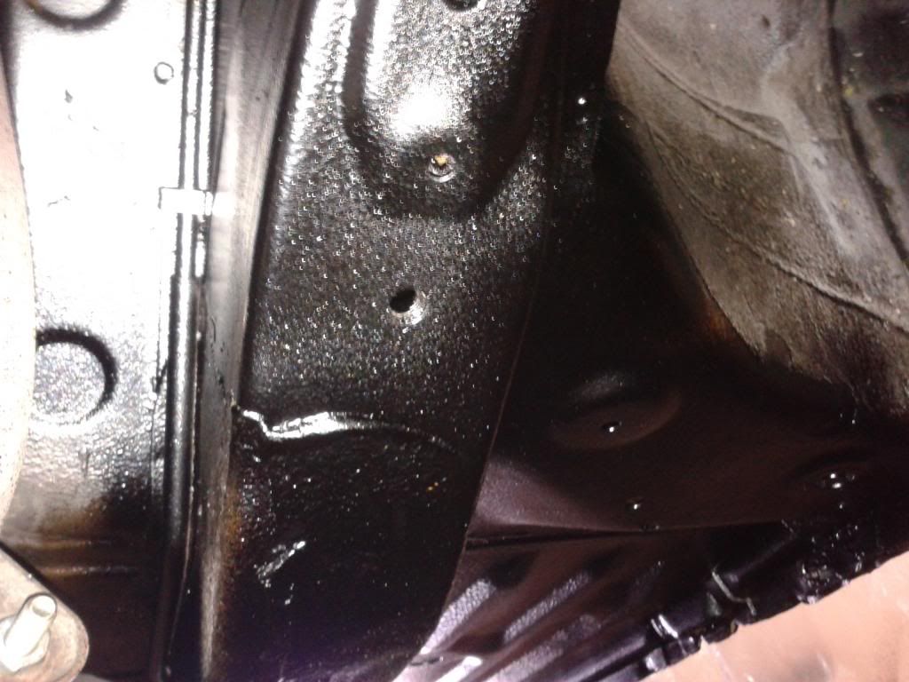

Thought it was time for some proper rust protection
Its only been on the road for just over a year so its still pretty clean underneath
4,636
44
Fair play for getting stuck in! Car looks tidy will be super clean when you are done with it , keep up the good work
25 March 2014
63
cornwall
then 2 layers of underseal
Had to take pics with my phone but you get the gist of it

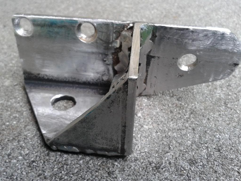

Over the past few months I've been slowly collecting all the spec R bracing
So some of them are off to the powder-coaters.
I'm going to try and put them on one at a time to see what difference it makes.

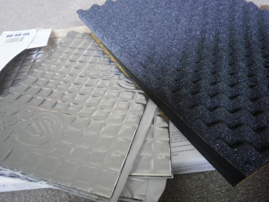

Bought some Sound proofing :ghey: :ghey:

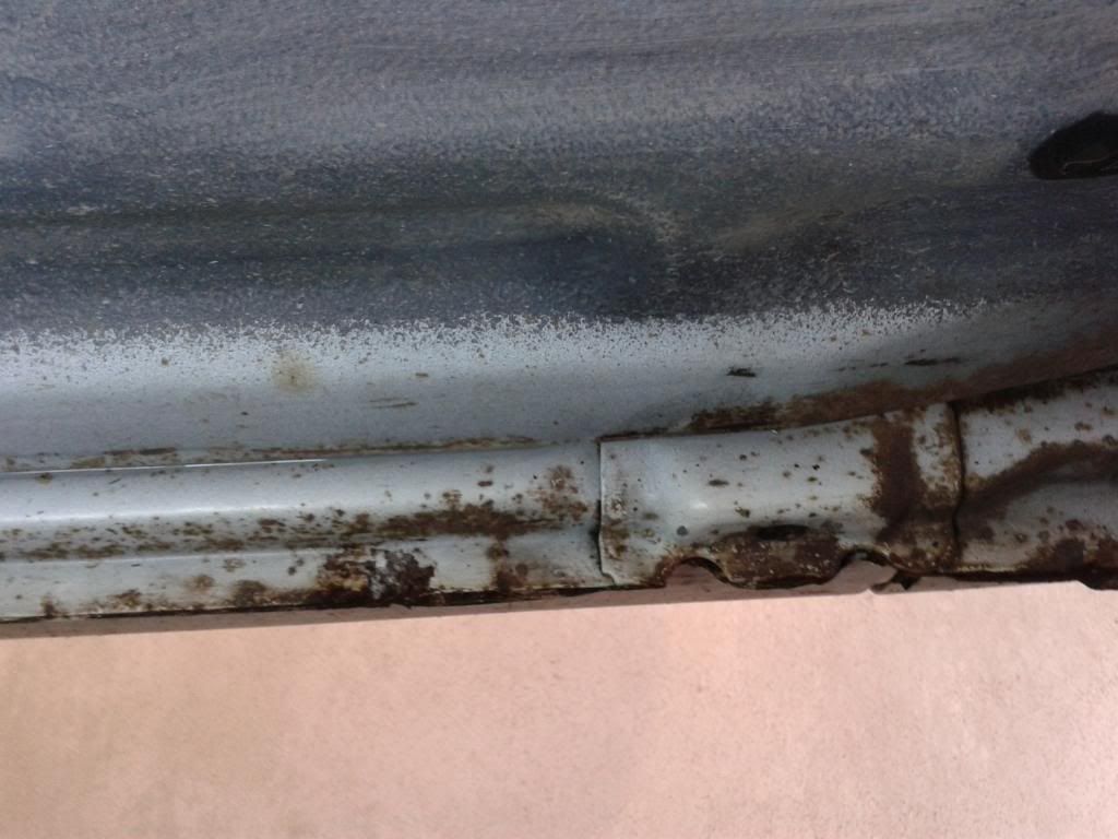

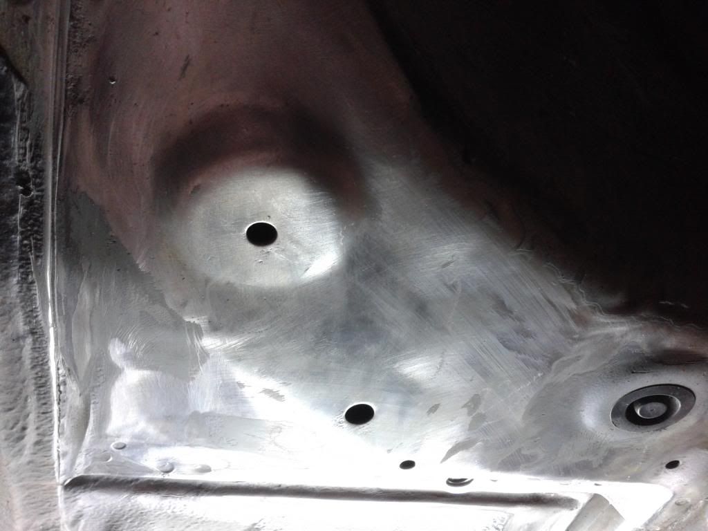

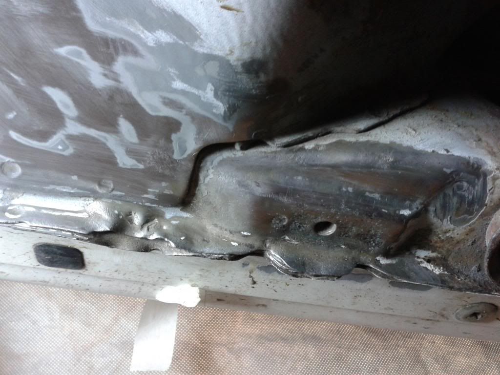

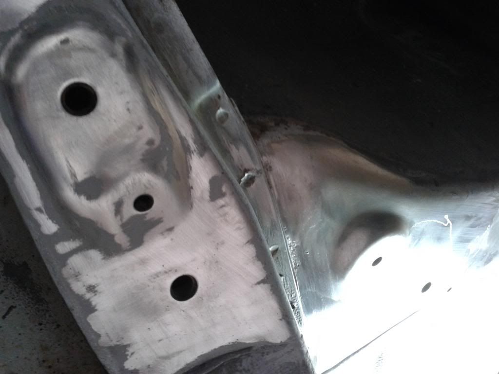

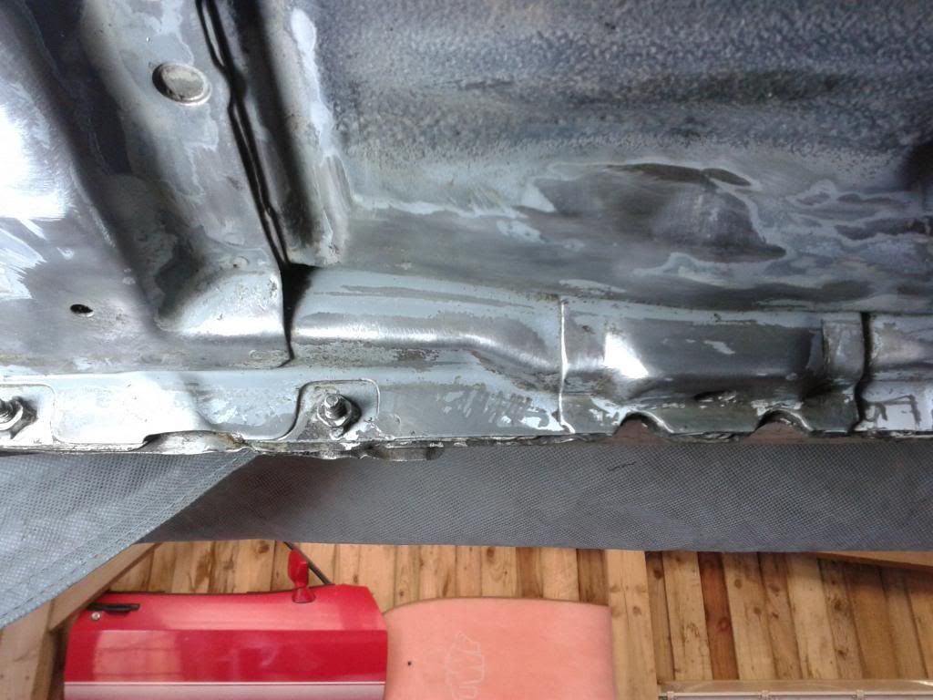

I did a spot of rust proofing as I had access with the trim out, The back of the sill is probably the no1 rust area on s-bodys so it would have been stupid not to.
Took what I could back to bare metal then applied several coats of galvanising spray.
There was just a little bit of surface rust there which was dealt with but you can see how it would spread, I highly recommend if you have a car that's been it the country for a while to do a spot of rust prevention in the sills to safeguard your weapon.
Will put some cavity wax in there next
