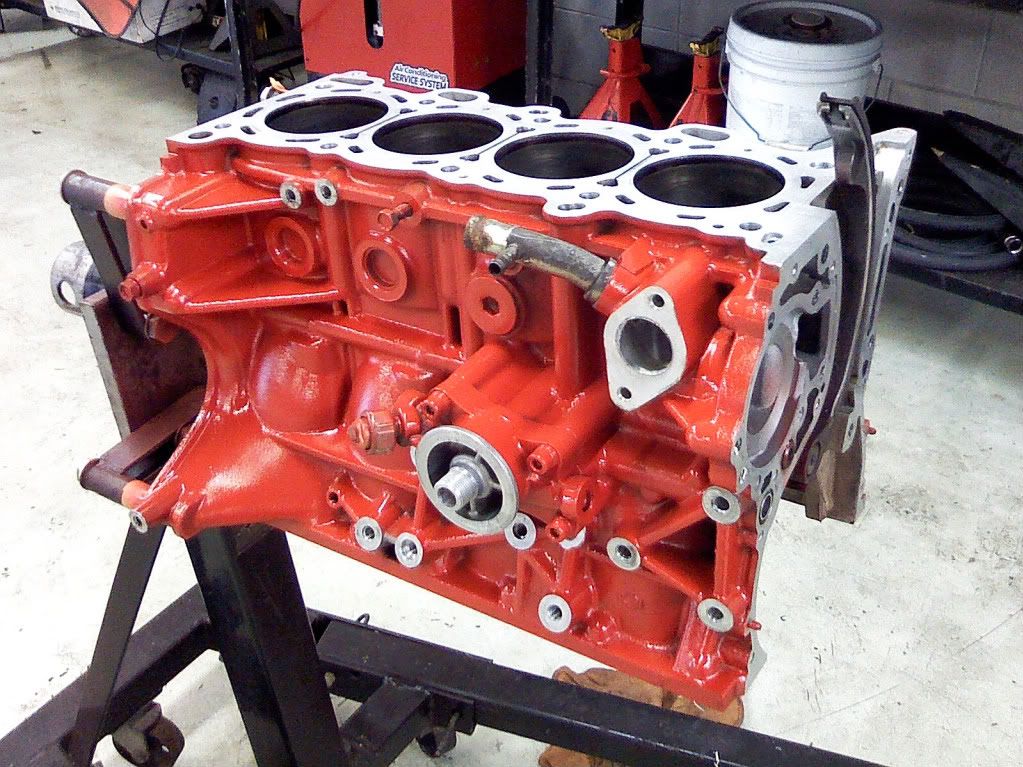

Benne Joined 11 December 2008 Messages 198 Reaction score 0 Points 0 Location Germany Country 6 July 2010 #1 I want to install a second knock sensor and need some pics of S15 engine blocks - right side, the area where the stock knock sensor is mounted. Can anyone help? thx! Benne

H Hypnotik Joined 13 June 2010 Messages 240 Reaction score 0 Points 0 Location Pisa, Italy Website www.flickr.com Country 6 July 2010 #3 This is the best I can do. The bolt sticking out at the top toward the middle is where the stock knock sensor goes. Last edited: 6 July 2010
Benne Joined 11 December 2008 Messages 198 Reaction score 0 Points 0 Location Germany Country 6 July 2010 #4 Thanx! Is it definetly S15 or maybe S14? What year?
H Hypnotik Joined 13 June 2010 Messages 240 Reaction score 0 Points 0 Location Pisa, Italy Website www.flickr.com Country 6 July 2010 #5 It's a S14 block but as far as I know there are no differences. Not sure on the year, it came out of my '94 but it wasn't the original motor.

Benne Joined 11 December 2008 Messages 198 Reaction score 0 Points 0 Location Germany Country 6 July 2010 #7 Are you sure? This is the thread right from the thread where the knock sensor is mounted: On S14 blocks it´s a plane outer diameter as you can see on Hypnotiks pic!
