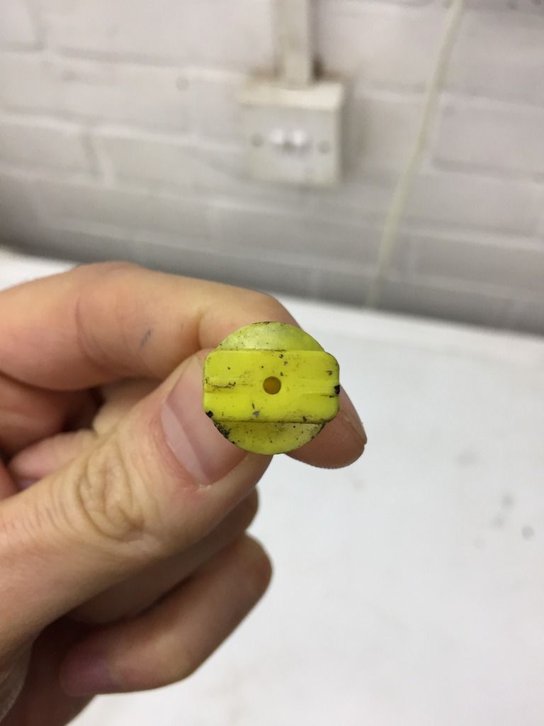

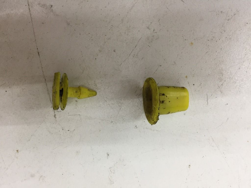

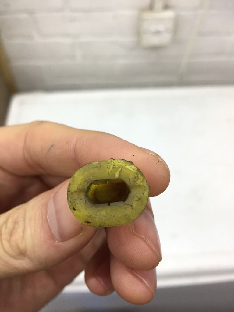

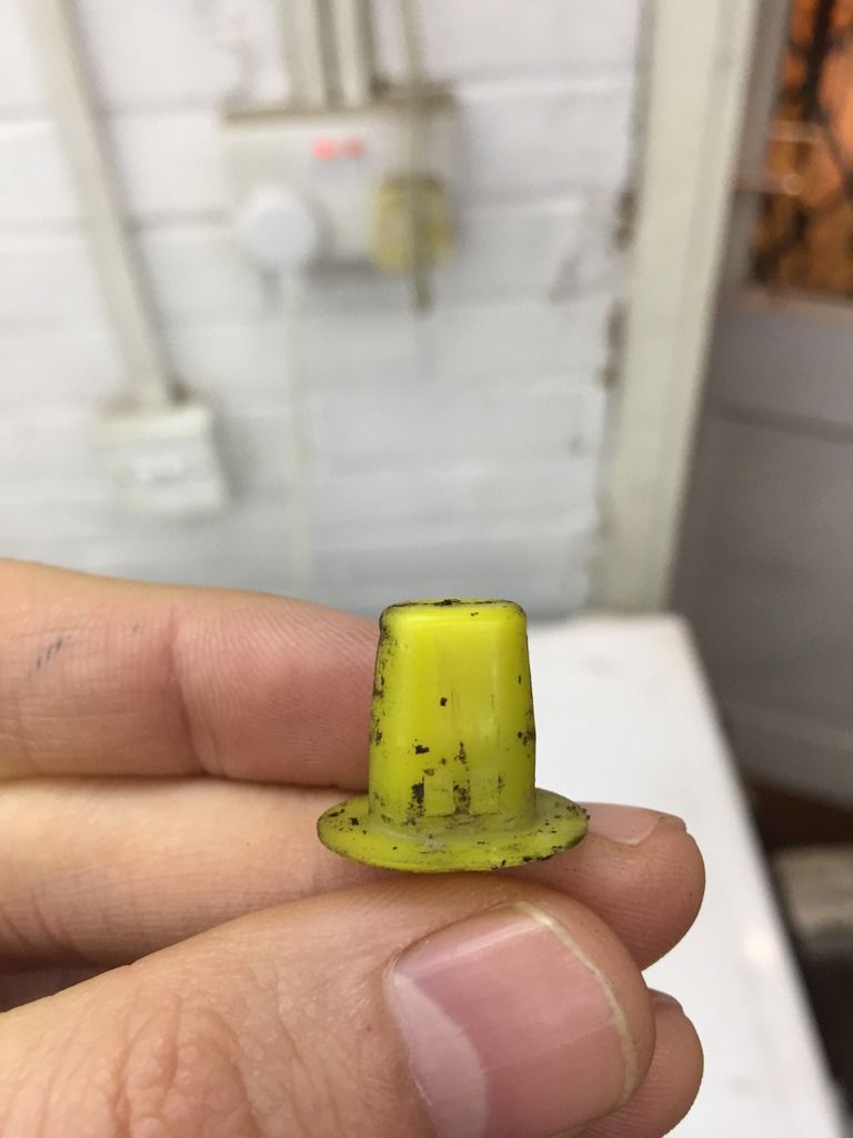

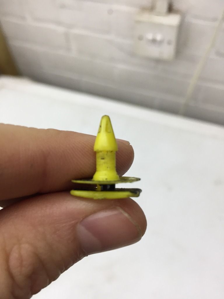

@4ndy_hunt
The oem ones look like this. so an oval hole but I'm sure there must be a newer kind that is round.
14 September 2007
360
Essex
@4ndy_hunt
the yellow ones seem to be in the wings and rear quarters but a round gray type along under the doors
