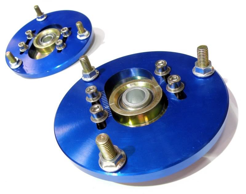

I asked the guy at the skyline garage I take my car to about suspension options, and mine being a daily. He said avoid 'pillowball' as it gets rid of the rubber mounts ontop of the struts, so more vibration.
Max
31 October 2010
445
Cornwall
Well, I'll be avoiding pillowball anyway.
Max
31 October 2010
445
Cornwall
As I understand, essentially where the top of the shock is rigid, like:
whereas ones that have rubber look something like:
images.jpgso more comfortable. Doubt you will get as much performance out of the non-rigid one though, but less noise and vibration?
