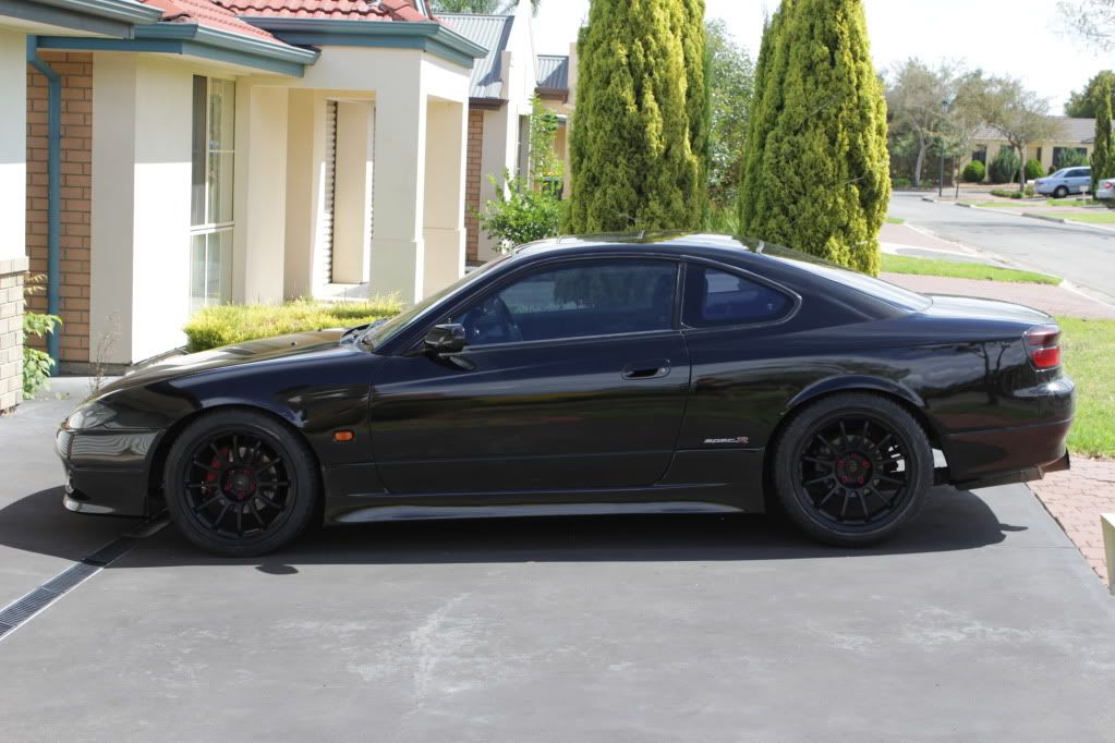

Right, after a day of working on the S15 iv'e come to the decision of losing the rear overfenders.
As finding oem rear panels to use the arches is a no go being in the UK, + stock arches offer very little wheel options, what other options are there?
i have seen a few stock body S15's on the internet with extended rear arches but not found out any info on what arches were used.
only picture i have of an example of what i am going for is this pretty poor one.

no dude i'd want to get rid of the overfenders and graft an arch onto my oem rear quarters, similar to the blue one ^^.
i do like the overfenders, but i think it would look a lot cleaner done like the above S15. it's just deciding on what donor arch to use.

i still think that blue one doesnt have stock rear arches though, looks like they overhang far more than the other examples you posted Jay. imagine it without the big side skirts, over a 3rd, maybe half of the wheel would be sticking out of the body. i like

I like your fenders Dave! I wouldn't change them!
The rounder arches just look odd, there are no round bits on a 15 so for me they just look abit meh!
If you wanted those arches defo go blue ones but abit bigger, the black one for example just looks silly! But blue one looks like custom arches made out of metal!
