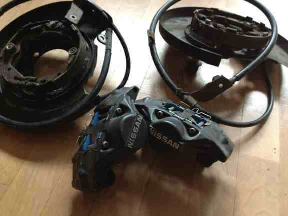

What's missing in this?
2 September 2012
180
Norwich
Am looking to for these to my car. They are off a z32.
I'm missing some bits (handbrake) not too sure what else!
Thanks!

Also will the R33 GTR handbrake cables work? Or does it have to be R32 or s13?
Cheers

I don't see any back plates? I'm not totally sure tbh Krish as I've never done it and only read about it when researching what you need!

As said you need the backplates, but you can use s13 ones. I used r33 gtst cables. There's a guide on jull.co.uk

We're talking about the rear backing plates that hold all the handbrake mech on :)
