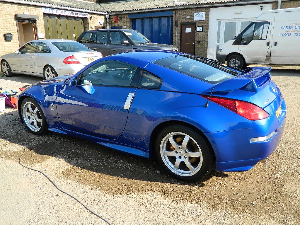

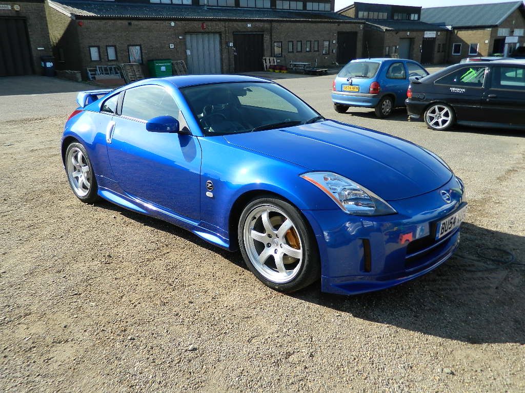

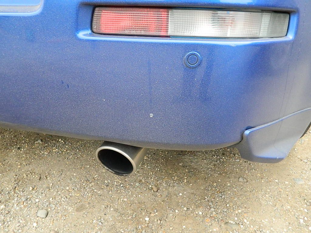

Yesterday it was the turn of this 350Z to have a full detail with some wet sanding thrown in for good measure!

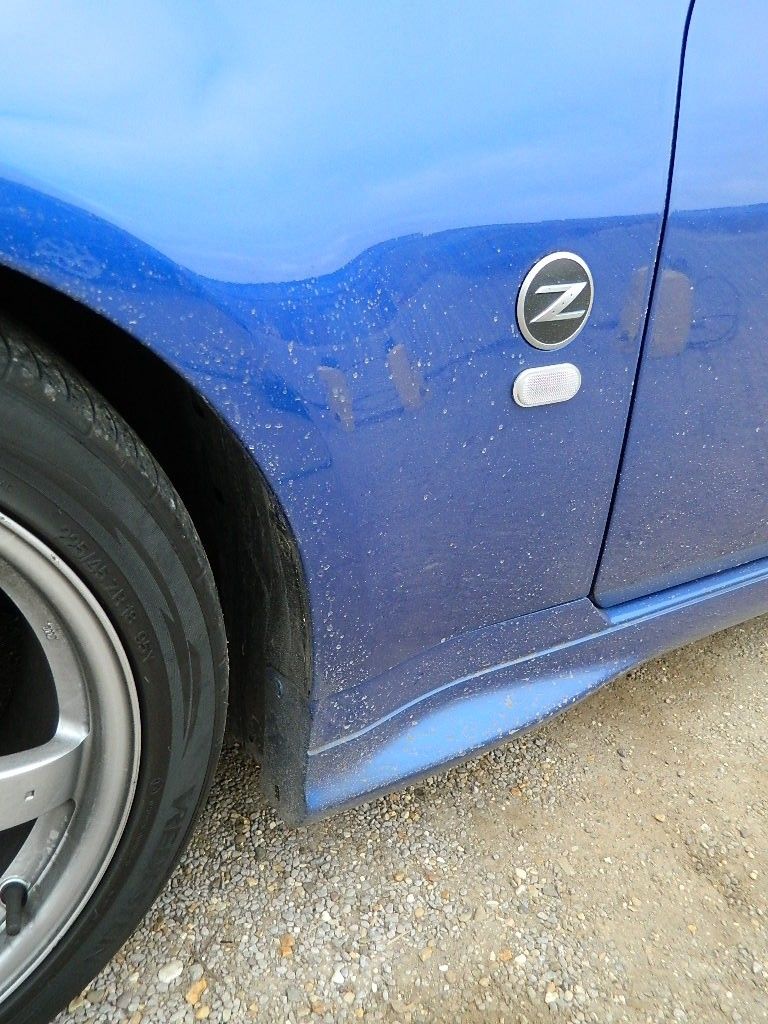

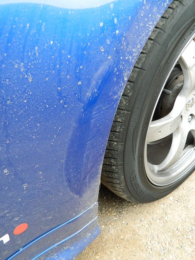

The car was a pretty typical case of swirly and lightly scratched paint, and needing a clean too:

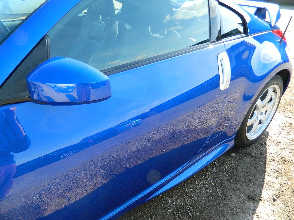

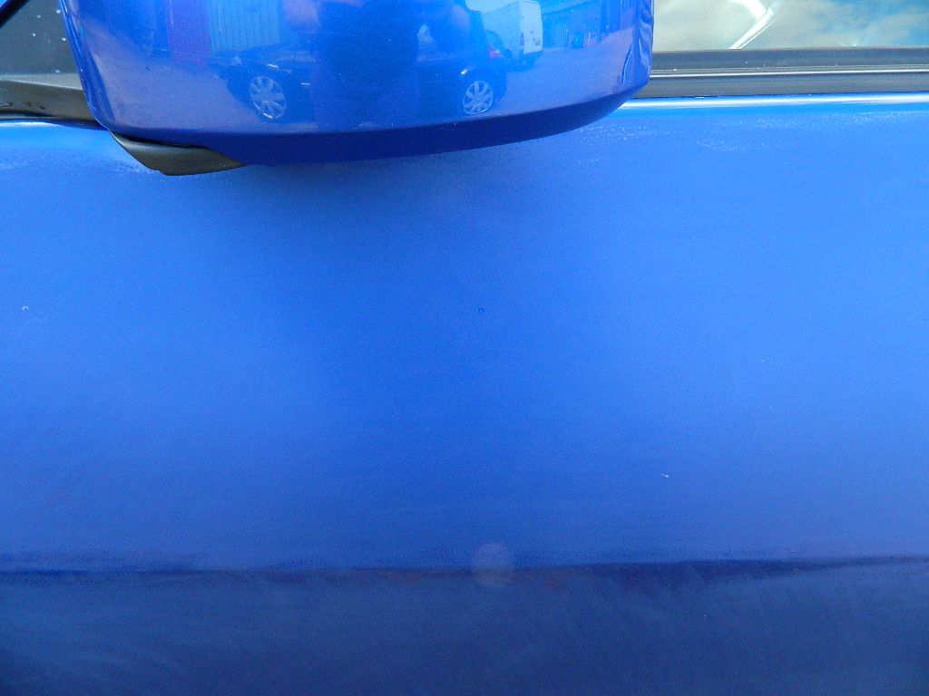

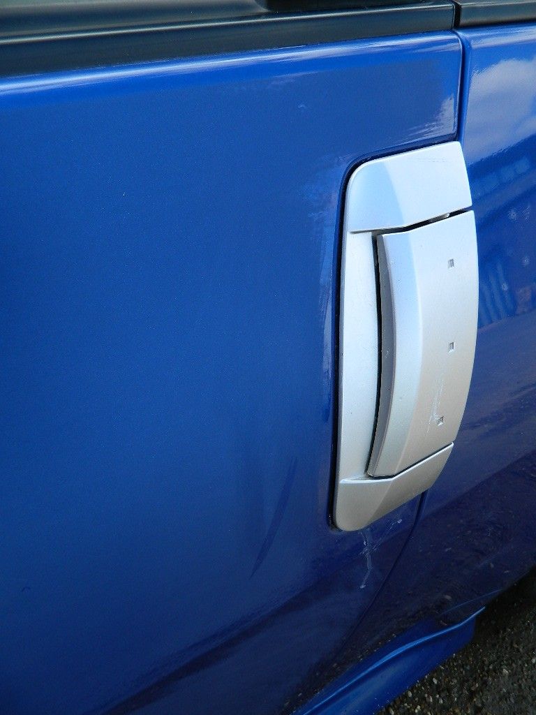

One of the problems was the passenger door had been repainted and left with a lot of orange peel:

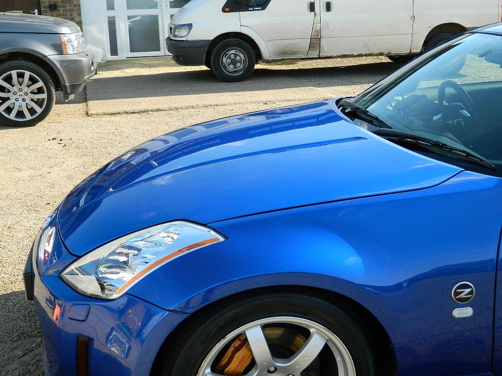

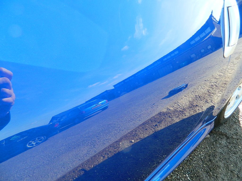

So out came the wet and dry paper, yes I know, I'm meant to make it shiny!!!:

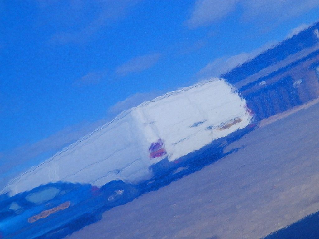

And once it was polished back up. I deliberately didn't remove all the orange peel otherwise the door would have been perfect and the rest of the car would look orange peely, so trying to leave enough orange peel to match the rest of the car was the order of the day:

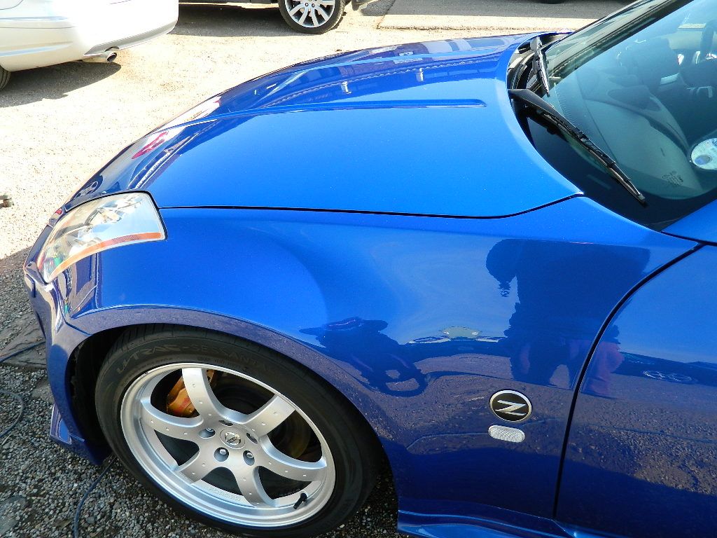

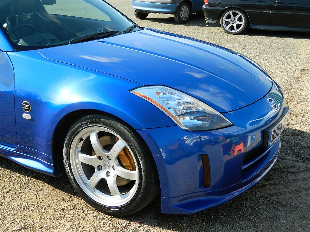

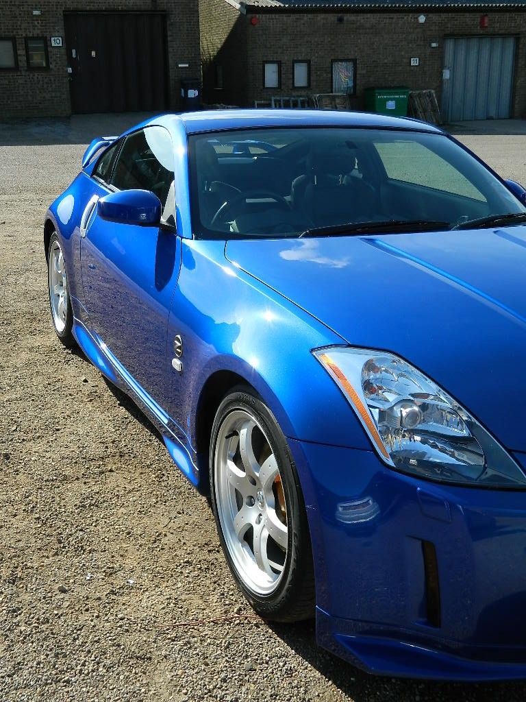

Then after the rest of the car had been polished and protected this was the result:
