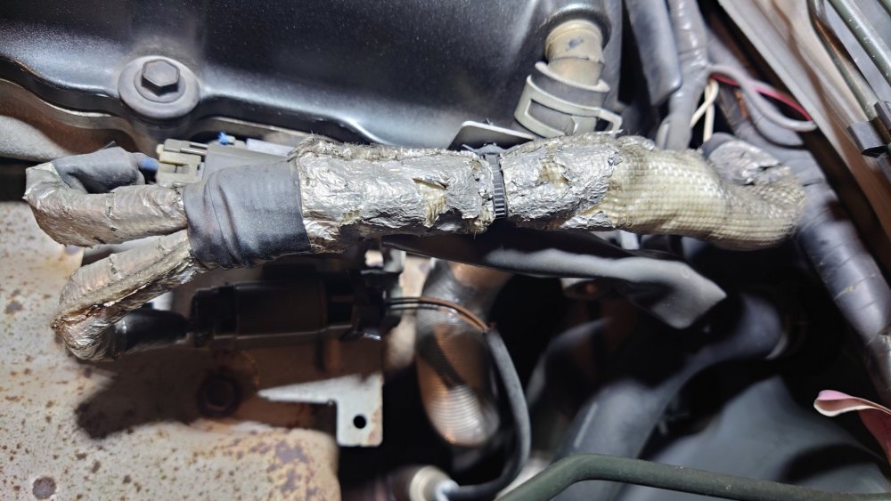

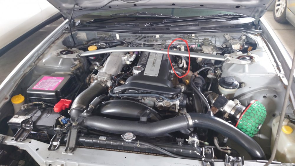

Hey..I'm feeling like this part of the harness is getting a bit tired...I would like to replace it with some new heat wrapping ECT... anybody have a parte number? It connects to the 02 sensor and a few other places..any ideas? might be part of the main harness it's pretty hard to tell..any insight is appreciated Thanks!

My S15R is also torn up with damaged connectors in that area due to engine heat.

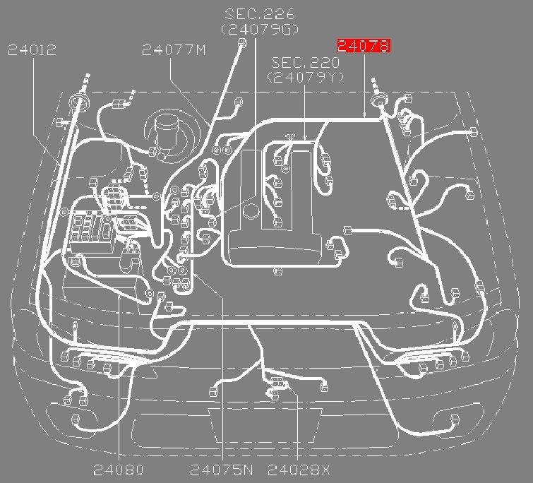

The part number is probably either 24011-85F00 or 24011-85F10. (It is an expensive part and is no longer manufactured in Japan).
If you remove the stay on the engine side and move the connector to the ABS side, you may be able to reduce the heat effect.
If you wish to purchase and repair only the connectors, you may be able to obtain them by consulting a Japanese store. (I do not know if they ship overseas.)
