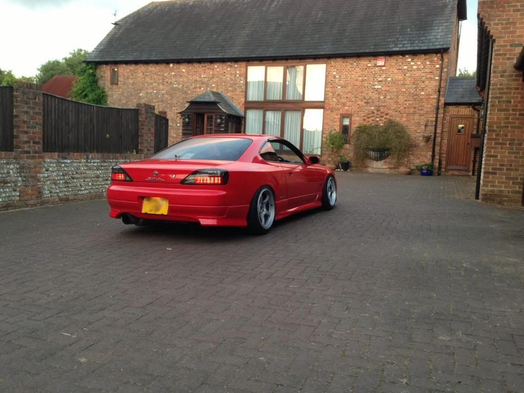

Somewhen I might get around to actualy doing a build thread... but atm here's a picture from last weekend.
My dirty daily , Currently producing 451.9hp with Pulsar ITB's a HTA 3071r on a link g4 :)

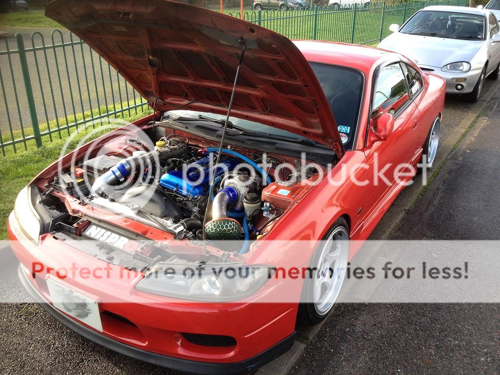

That looks like a fantastic setup dude. What's in-tailed in the pulsar inlet swap? think its the first time seeing that done.
Love to see some video's of how she goes

how close did you come with that intake to the bonnet.. nice work with the quad throttles, looks mean

Lovely car!
Where did you get the grey/black front splitter?
Its off a Honda dc2.

The pulsar conversion is a ball ache to say the lease. The engine origininated from my old PS13 and it came accross from japan with it already done. But after fitting it into the s15. i can say there would be a lot of work involved to recreate it. (mainly the fact you haft to cut the whole plenum off spin it 180 and tig weld it back on for RWD).
Could more pics i dug out :)

180sx or ps13 engine :D
Looks sweet, is that a standard block or have you done any internal work? What gearbox and clutch combo are you running? At least you wont have vvt rattle :D

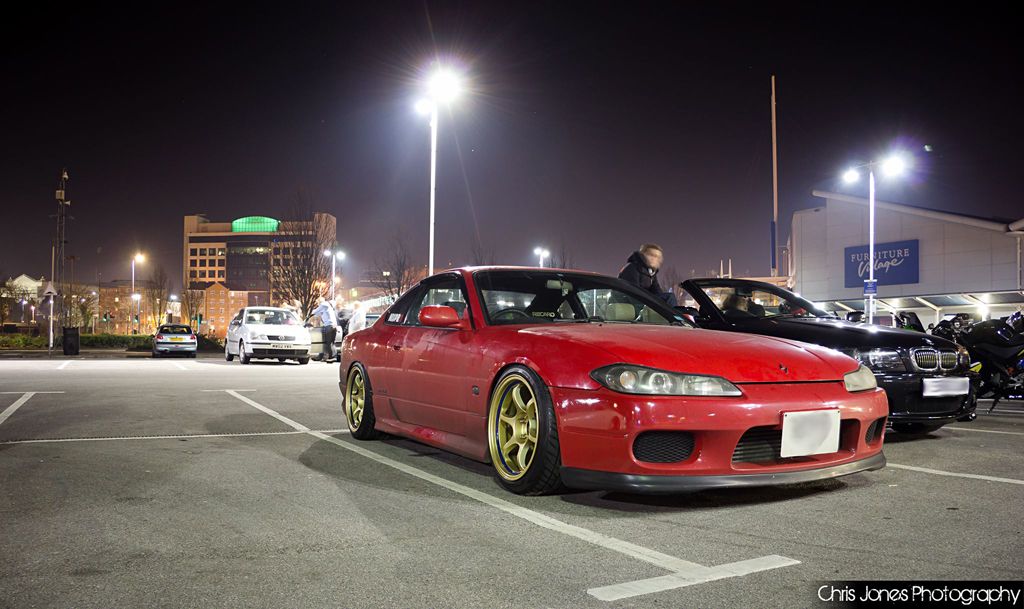

God those wheels..... Wanna swap for some 18" rays engineering??? Lol. What size and offsets are those? I need a set in my life!

Arp headstuds
Aftermarket cams
Acl bearings
Cosworth MHG
H-beam rods
Arp rodbolts
Uprated valuetrain & RAS
Currently running a s14 5 speed gearbox (iv got a rb box lined up but no conversion plates as of yet)
Ats Carbonetics carbon super single clutch.
