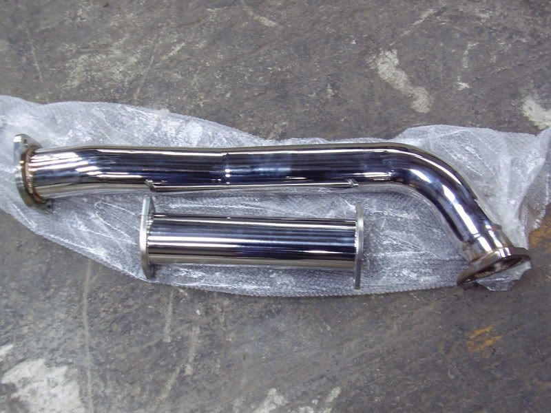

Look what arrived for me today?
No not the CAR!:D
Plus got the apex gasket kit and flexi oil line the other day!

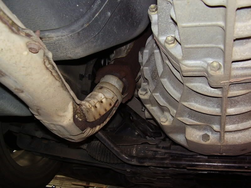

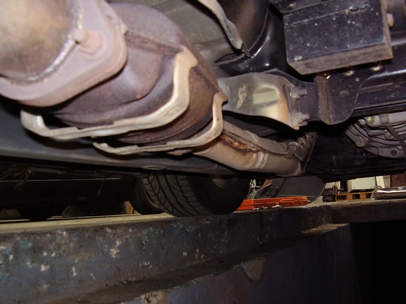

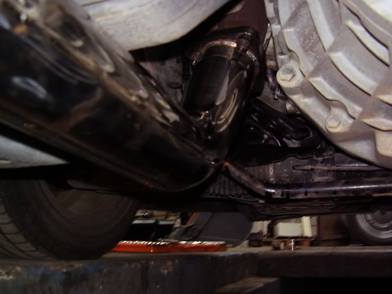

so built the mani and elbow onto the turbo on the bench and the flexi oil line.
Before:
After:
