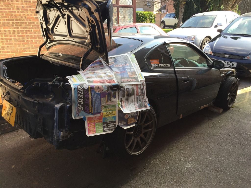

Turns out that the fiberglass body kit was also hiding a few surprises. Like... the doors being shaved to kit the side skirts (means they have separated at the bottom), its had a replacement drivers side rear quarter. its taken a knock on the passages rear end, the front bumper support had been cut up to fit the aftermarket front bumper. The drivers side headlight had been split and not scaled properly. The body kit was screwed in to the metalwork with self tapping screws instead of using the proper fittings and in some places even screwing through the fitting points.there are lots of other things I could list but I cant be bothered any more.

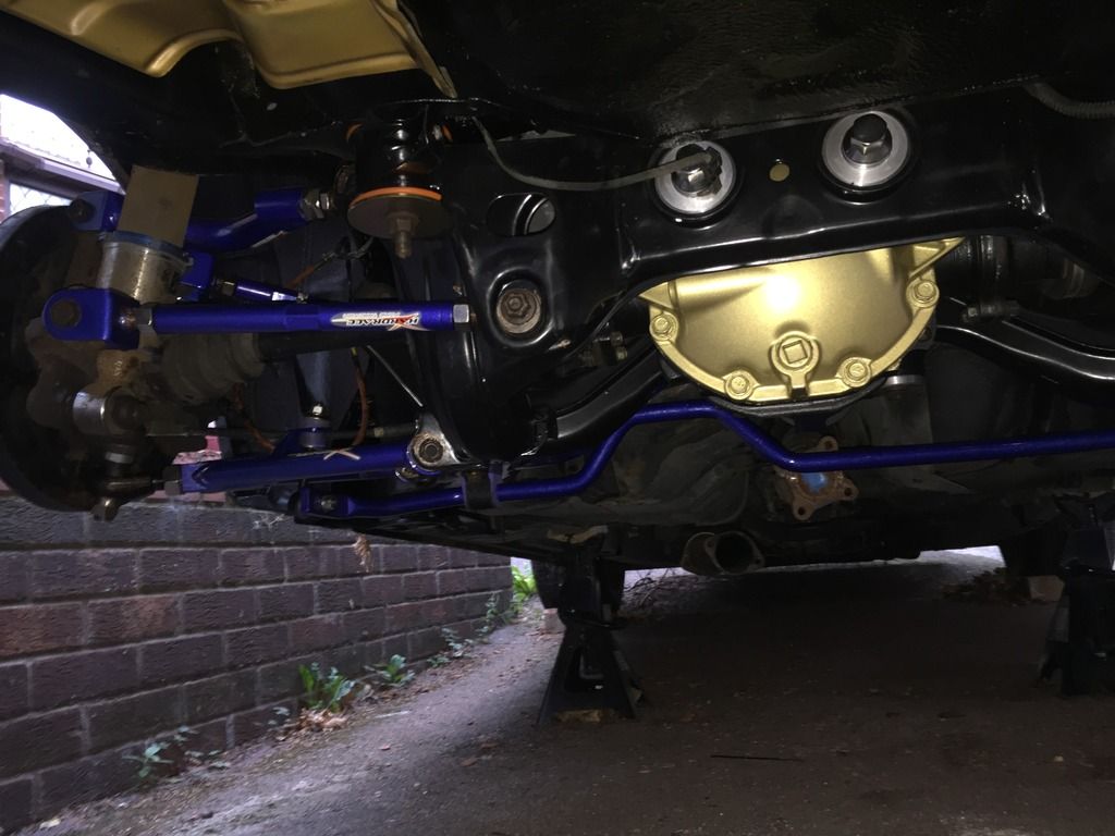

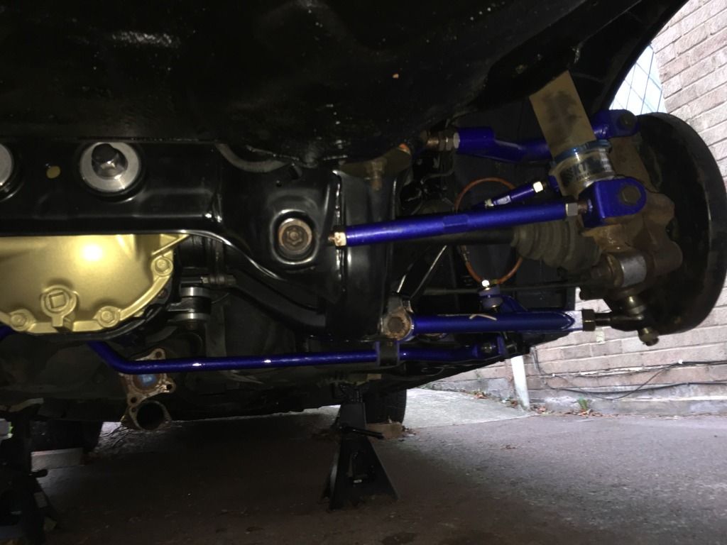

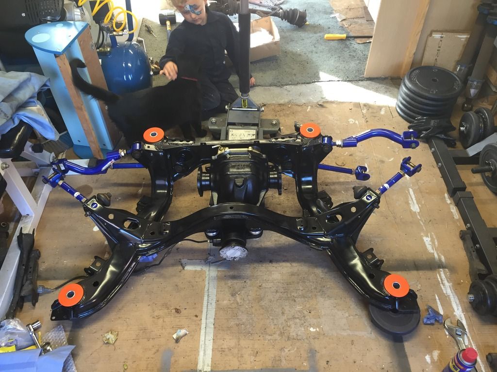

The good news is I have now stripped the underside and under sealed, refurbished and powder coated the rear sub frame, put all new hard race arms on and managed to get a full OEM areo kit together.

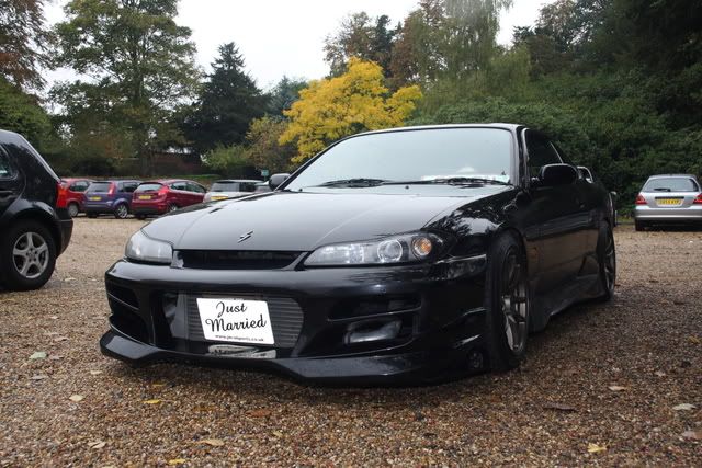

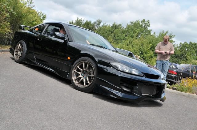

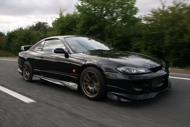

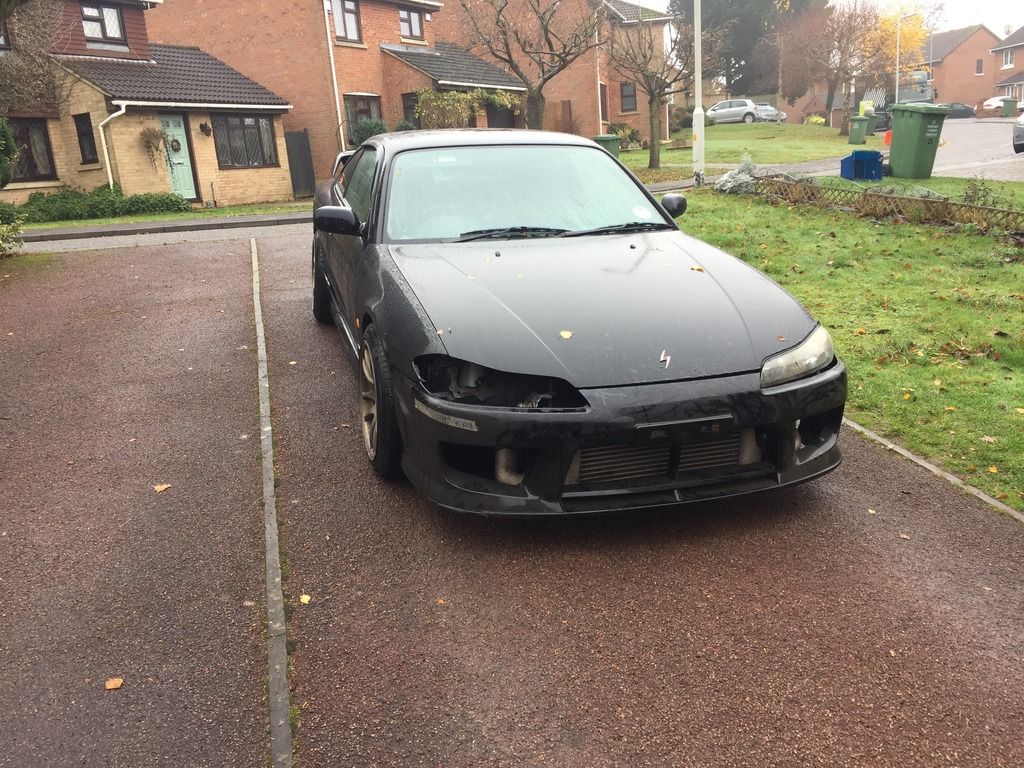

So in no particular order some photos of her from the last year or so.

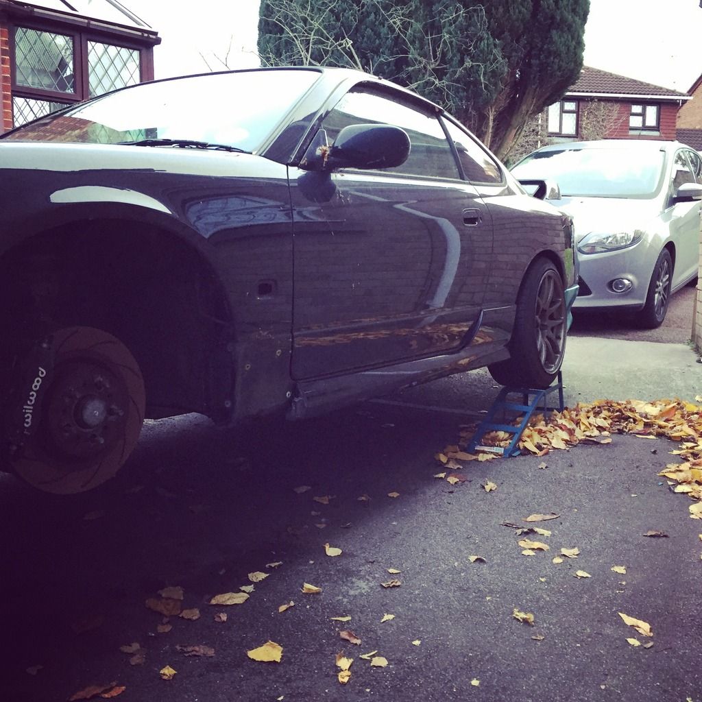

and how she sits currently...
Anyway thought I would share, onward and upward to 2017! :thumbs:

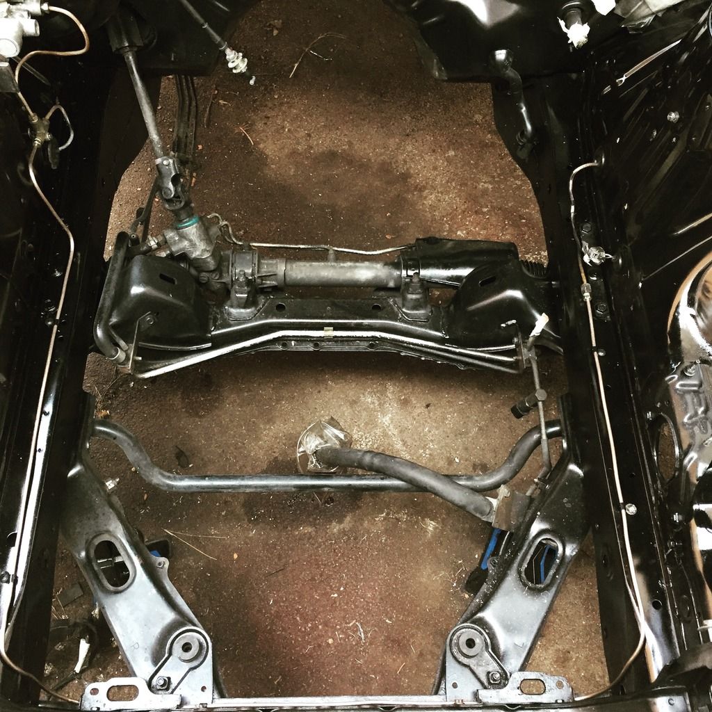

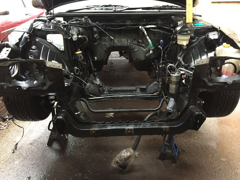

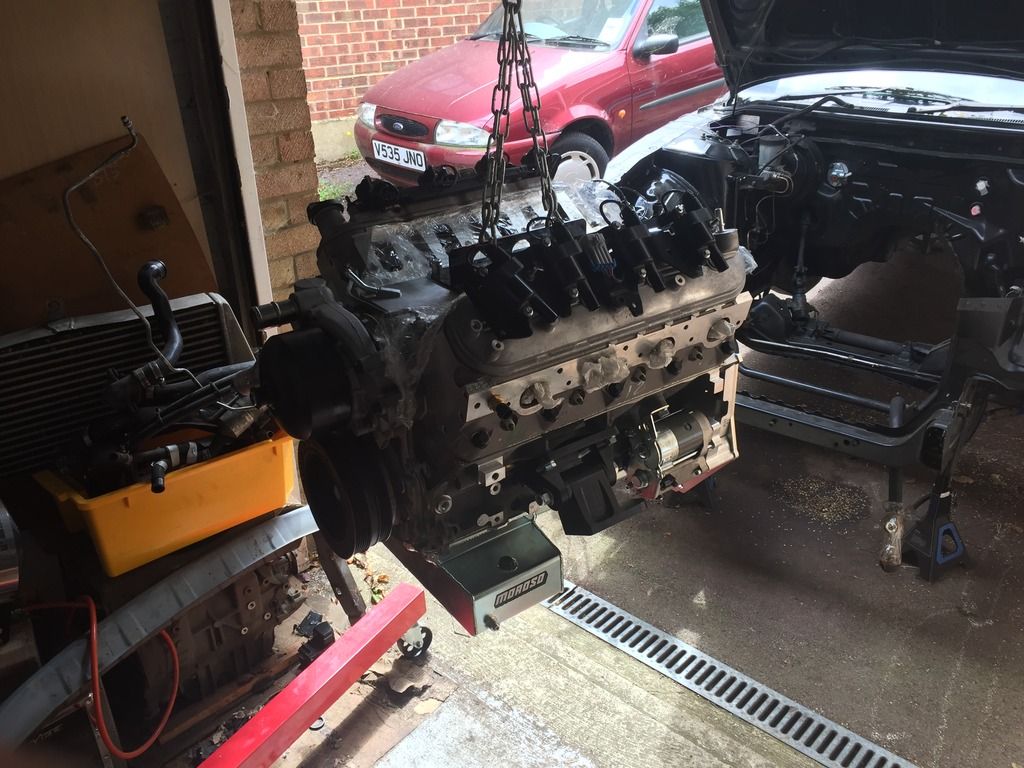

got the engine out a few weeks ago and just running through tiding bits up and preping
final shot befor the front get stripped off.
Empty bay

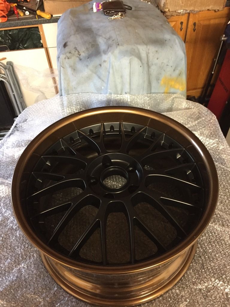

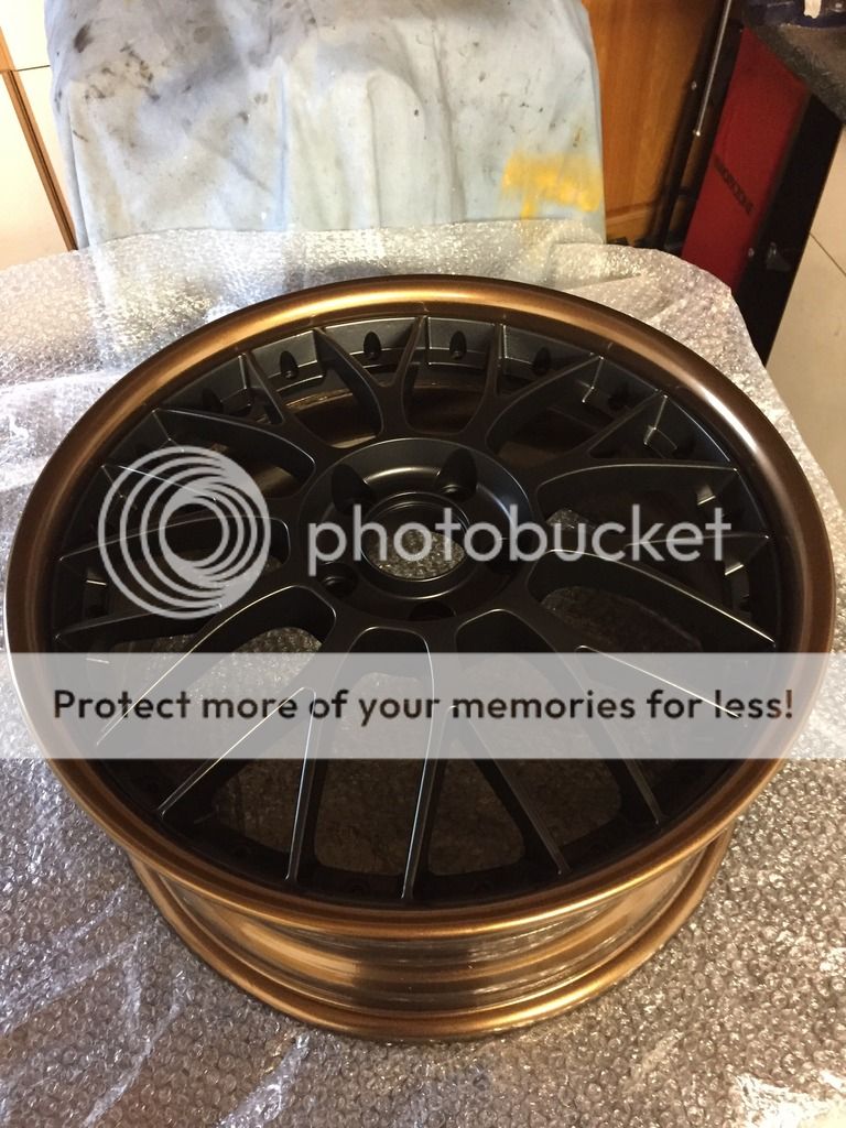

Got my wheels back from the powder coaters
now its a case of sorting the engine bay and collecting the remainder of the parts I need. Putting it all together and seeing what I have missed.

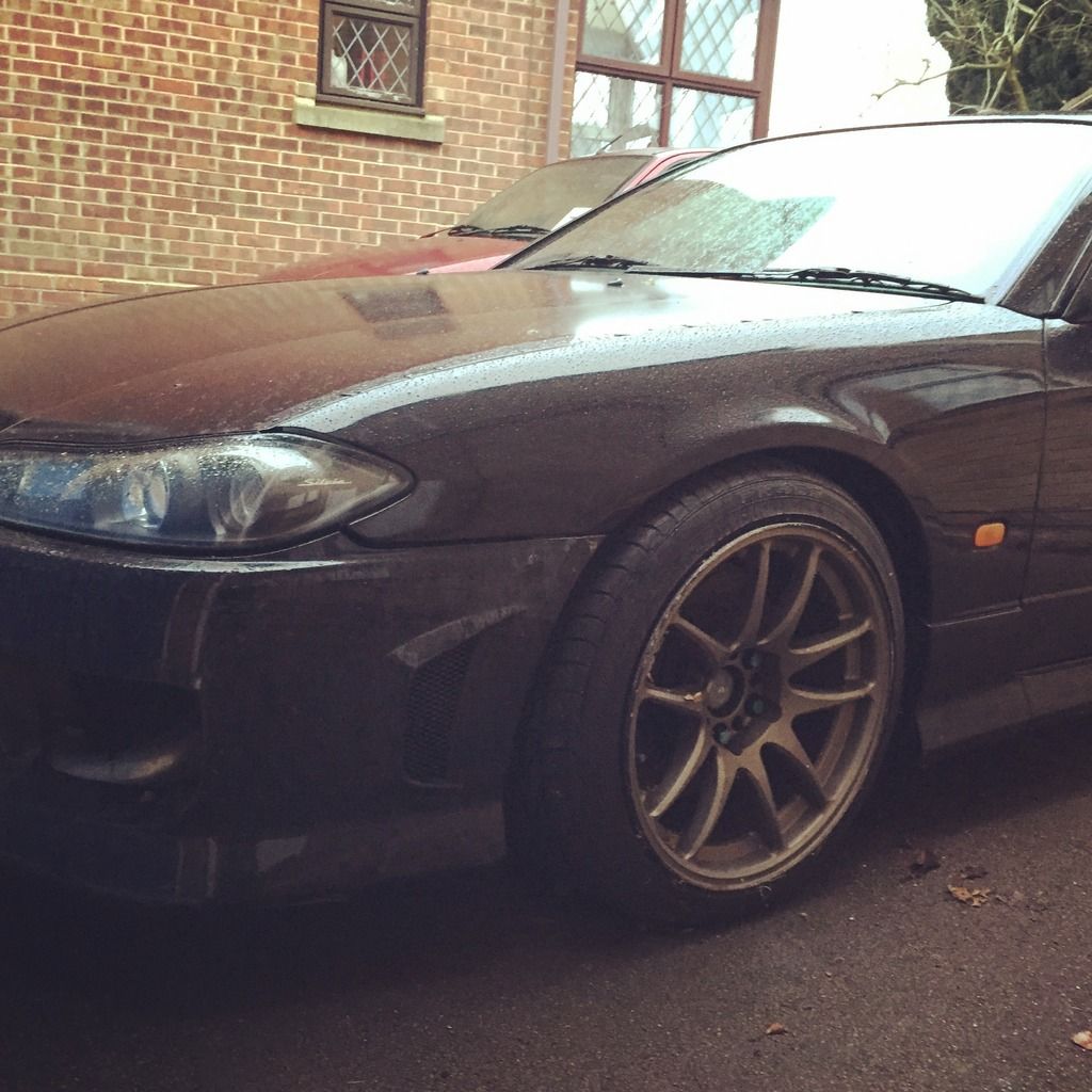

Looks so much nicer than with that aftermarket kit on it. Black suits it. What wheels are those?
13 February 2017
Auckland, New Zealand
Glad you got rid of that Uras kit. Factory kit is awesome.

I think the wheels are zivell speed maybe river side? If that's the spelling... I will check the stamps on the back.

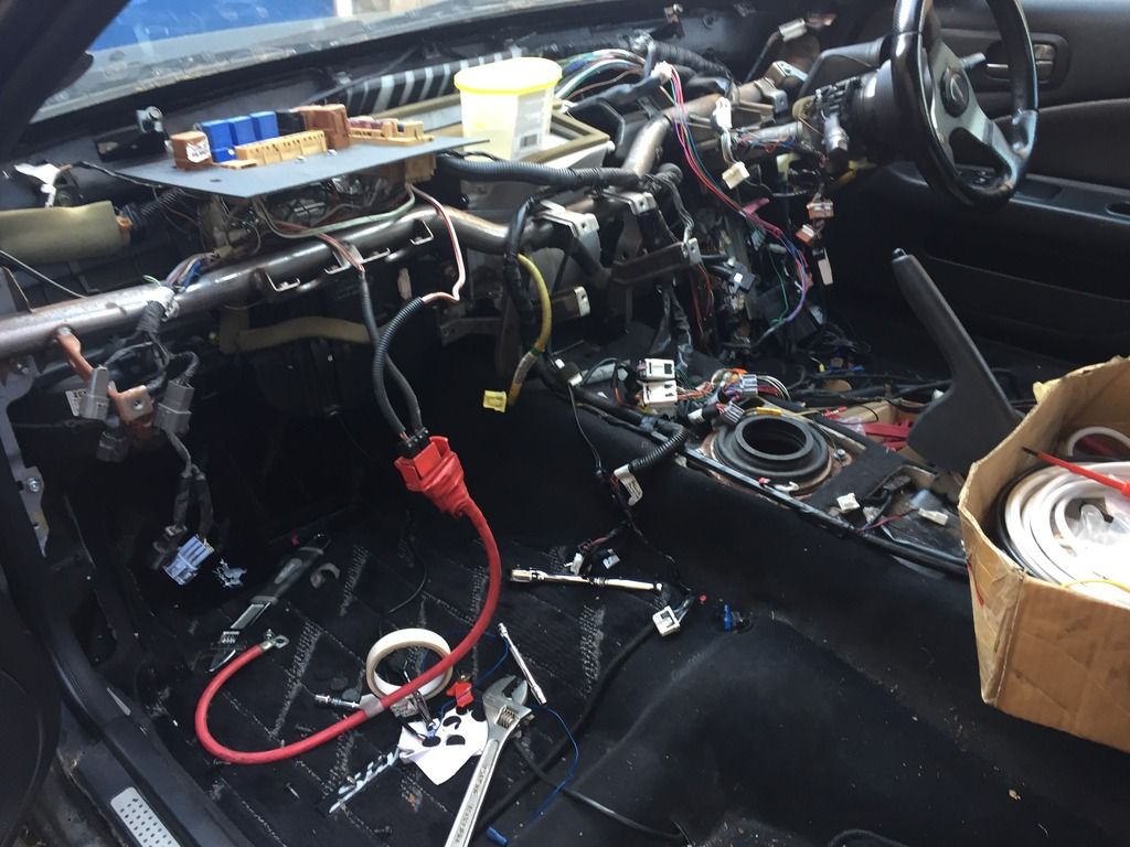

As for the fuse box route I'm not sure, I can take some pics for you but it's not something I did. In fact I want to locate the fuse box behind the dash to give me more room I'm the bay.

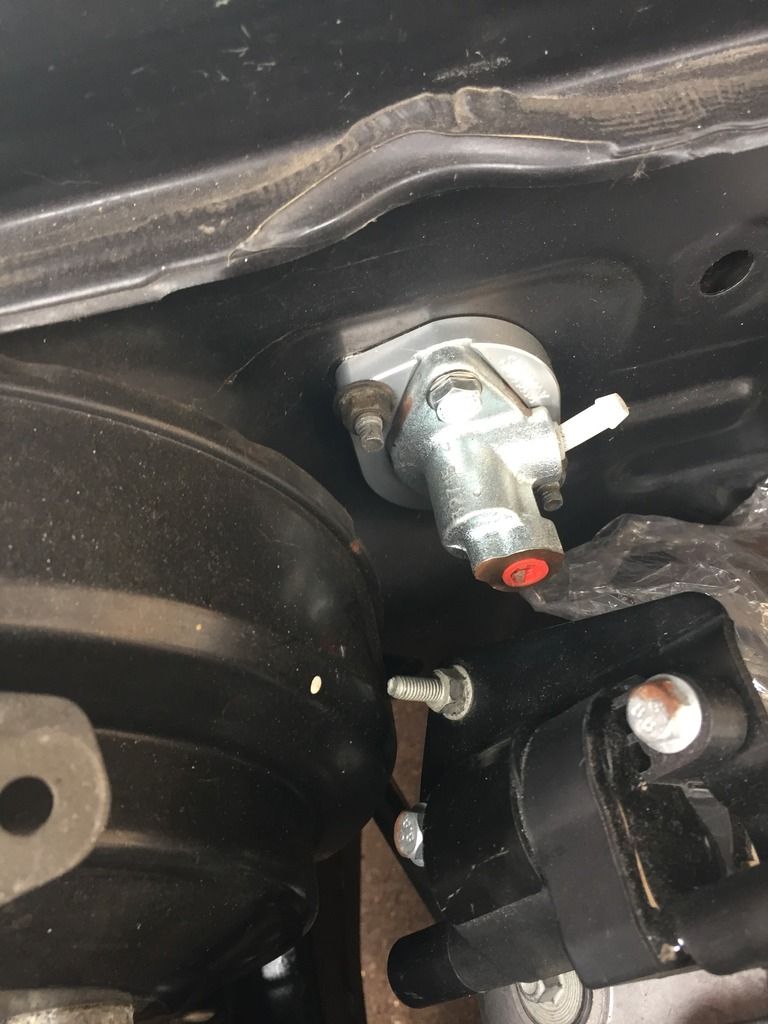

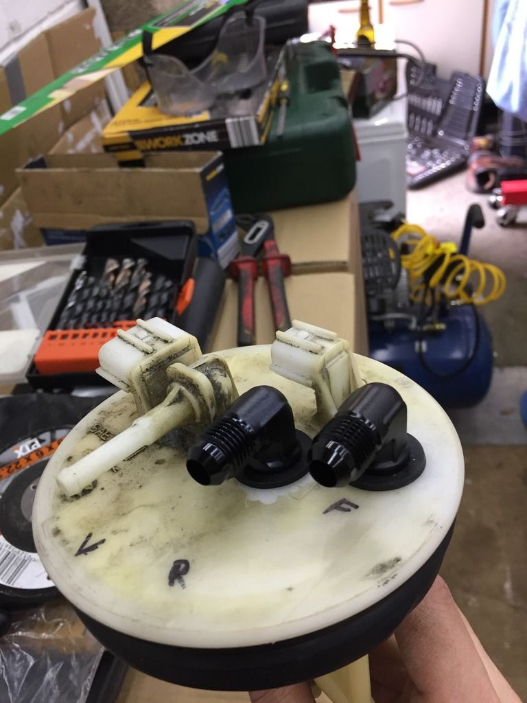

brake pipes re-routed as the ABS has been removed and i was not happy with my orginal bodge job.

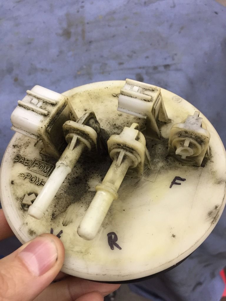

snapped the fuel cap adaptor so updated them to AN-6 adaptors which should make running the new lines a little easier.

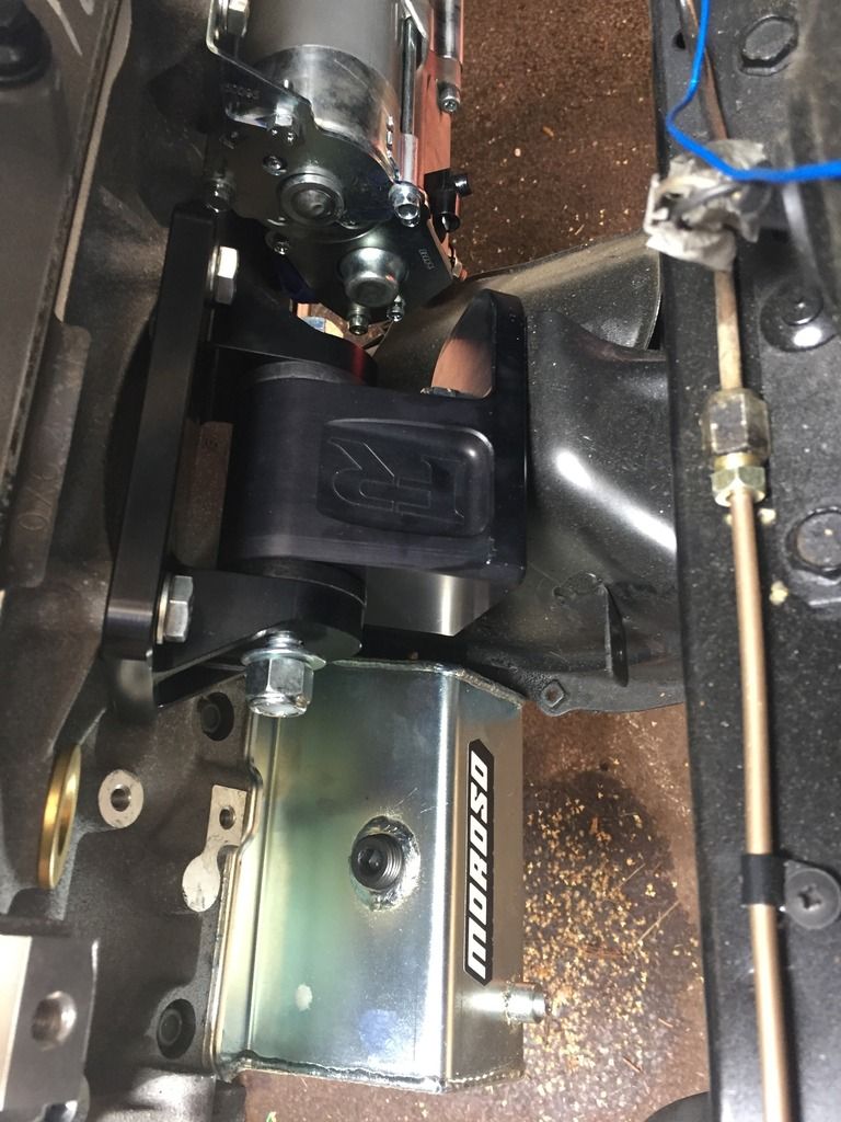

started to relocate the fuse box at the same time as the engine swap may not have been the smartest move but we will get there.

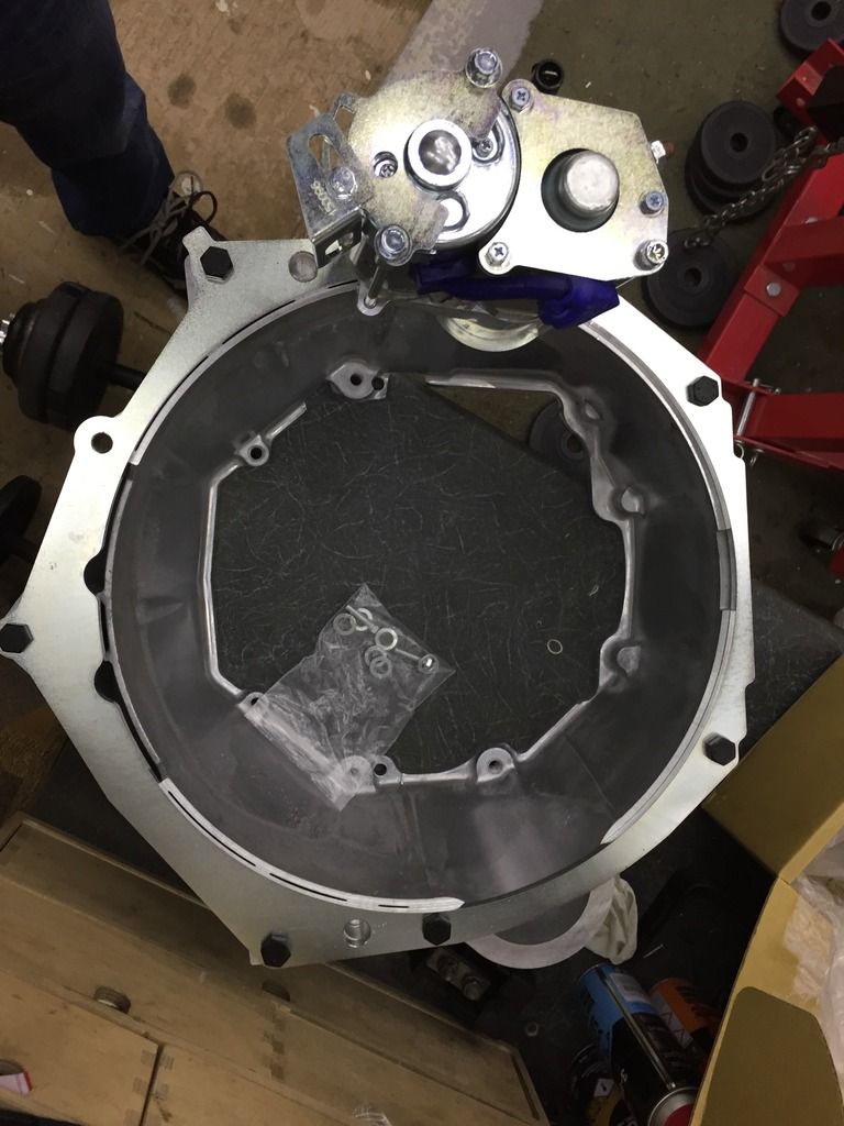

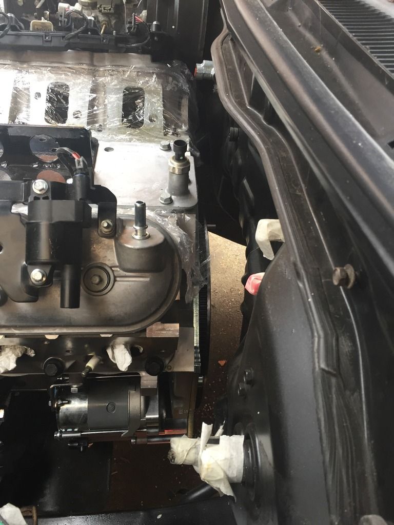

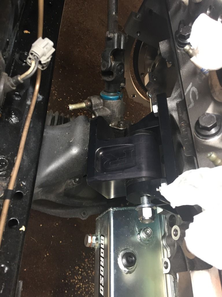

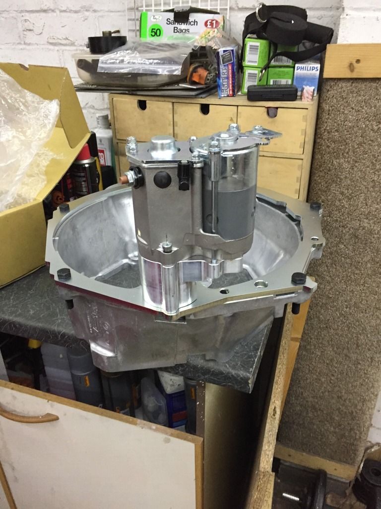

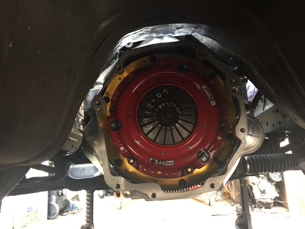

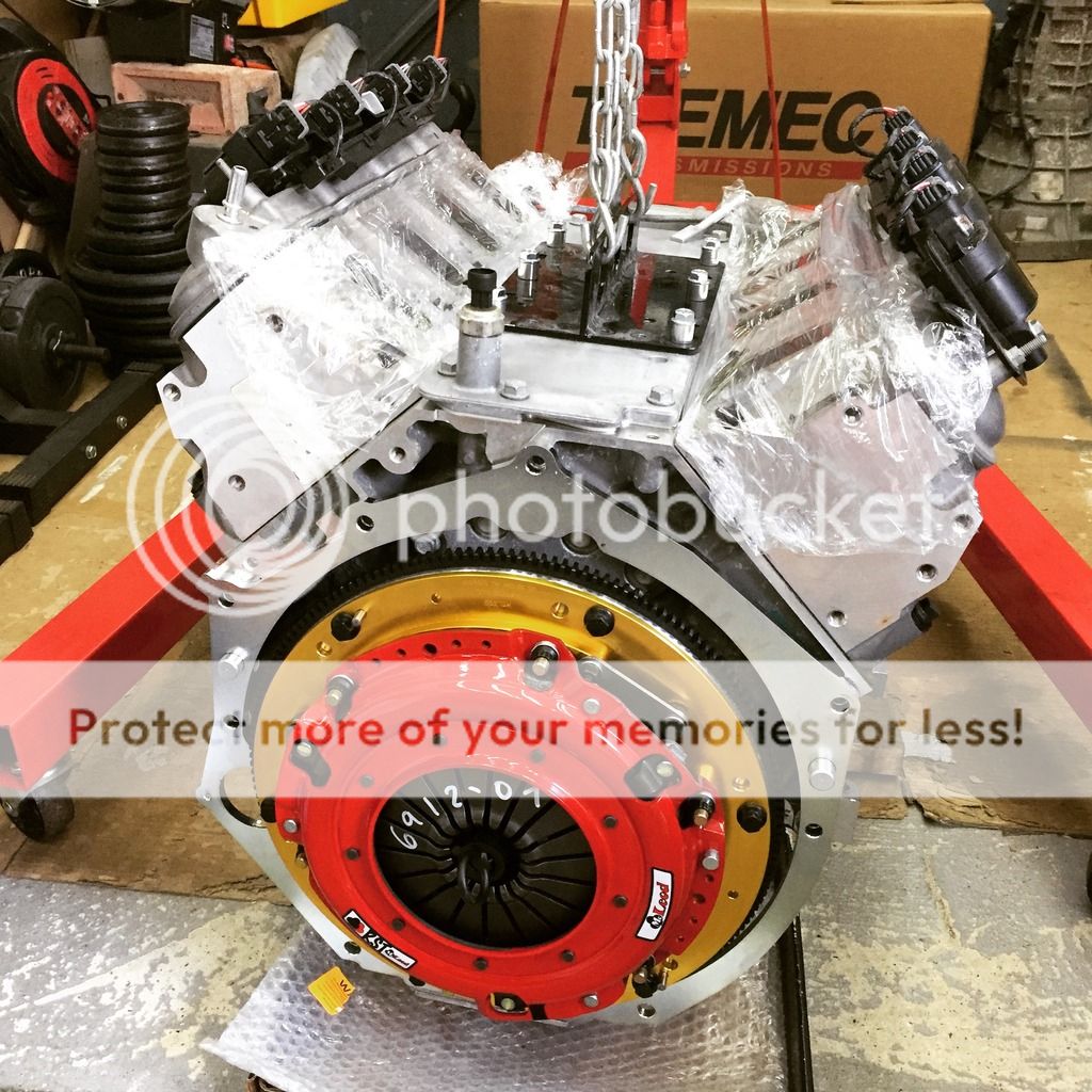

test fit the starter motor relocation kit. bell housing needed cutting a little. this should get me round some of the header and steering rack problems.

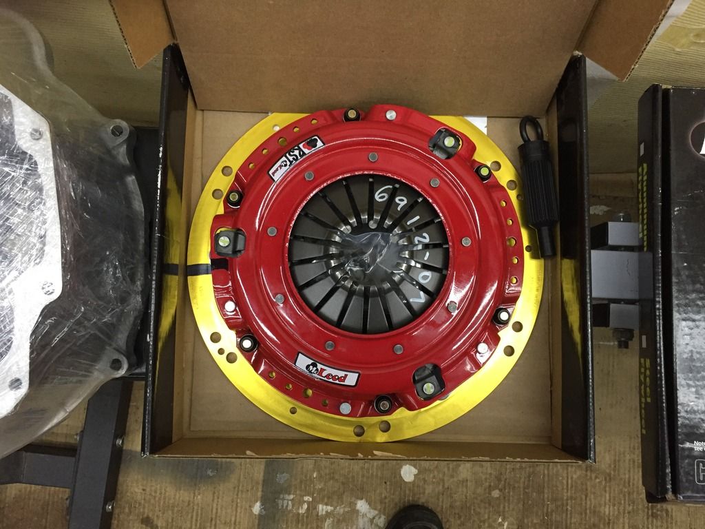

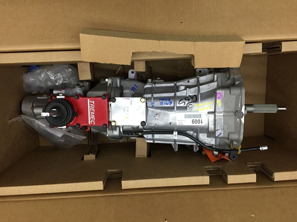

clutch and fly wheel test fitted.

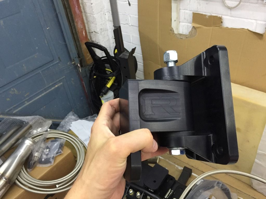

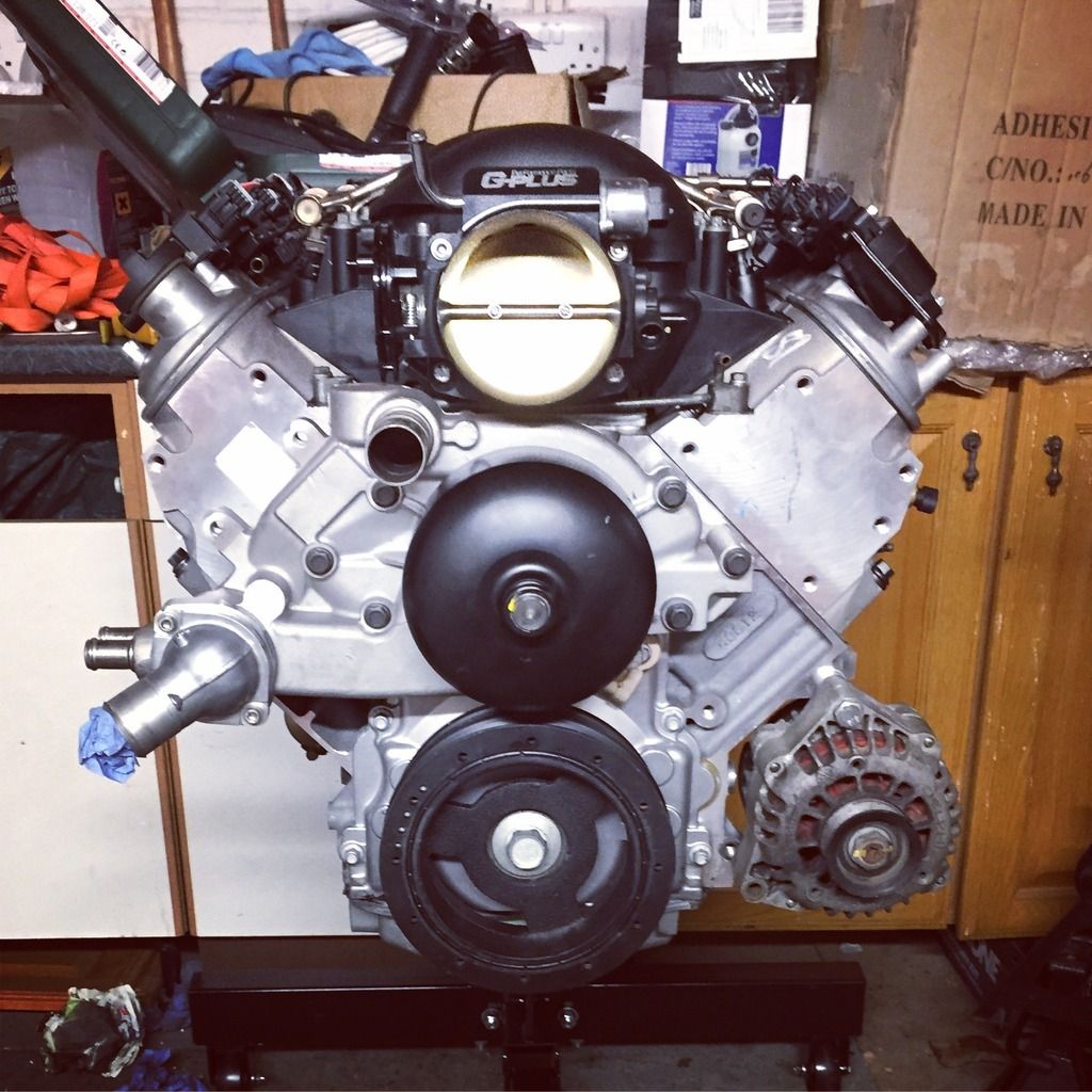

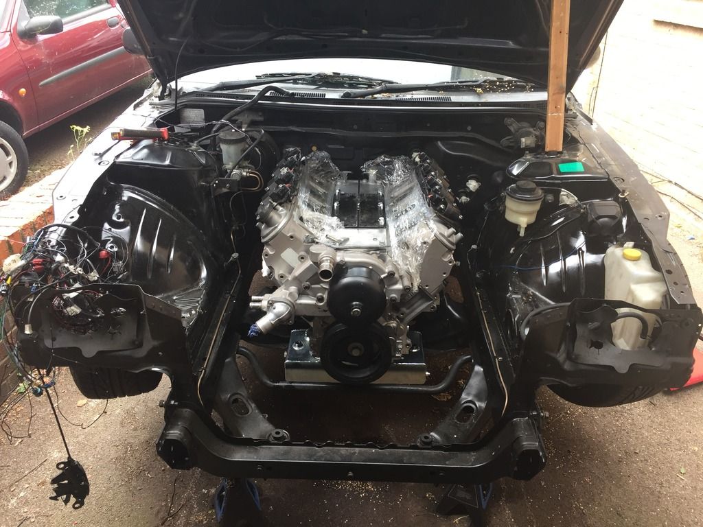

and the beasts new heart itself

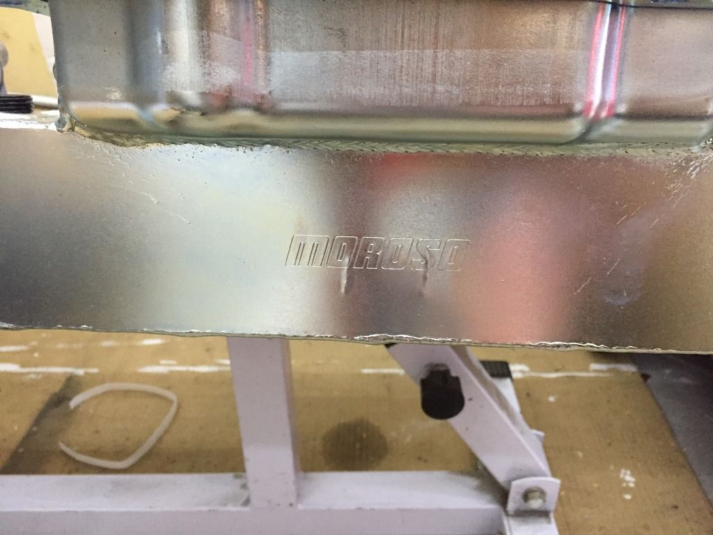

Just waiting on the mounts oil pan and other bits of the kit from fueled racing and we should be ready to go in in a couple of weeks. cant wait :evil:

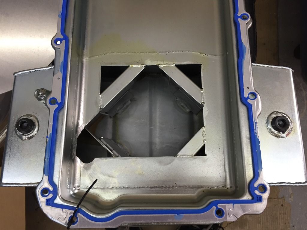

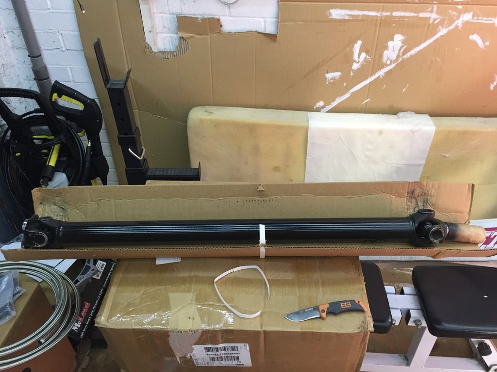

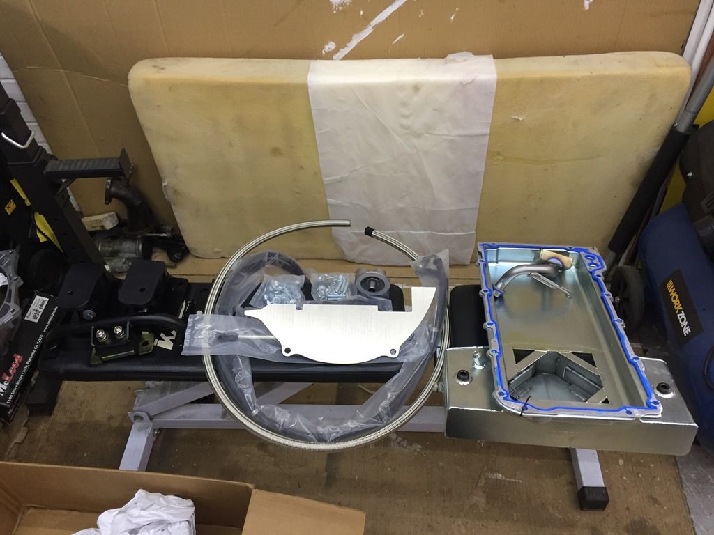

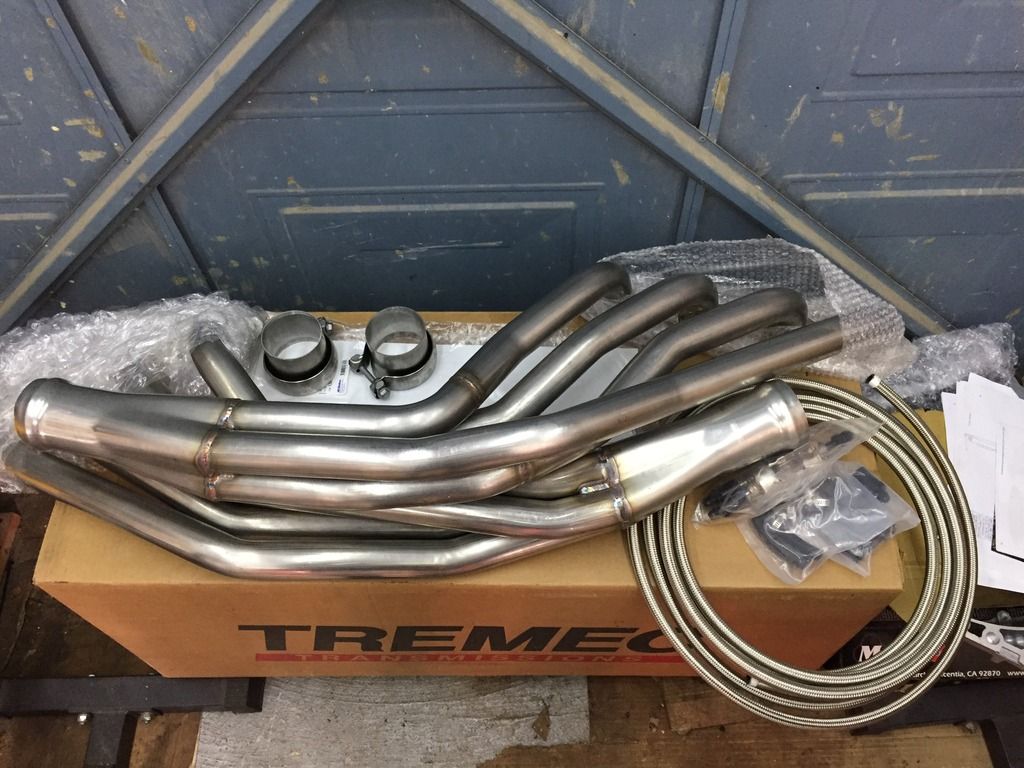

so stuff arrived...
so test fiting started... (please excues the wiring)
touch close and had to loose the pas lines

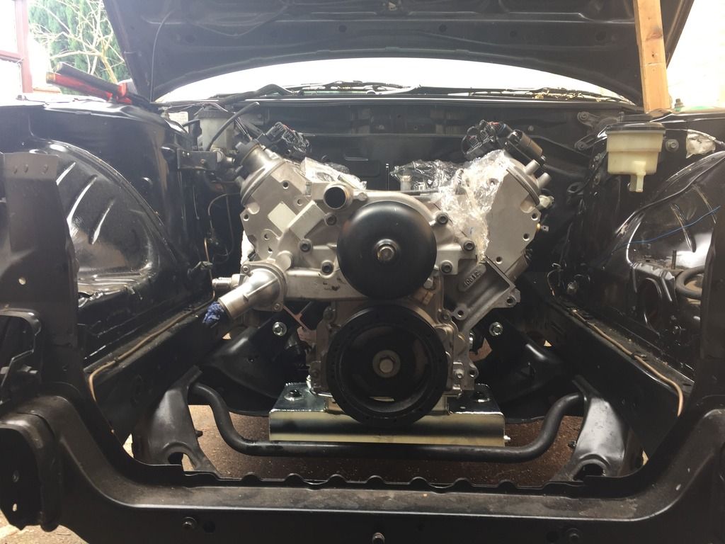

Starting to get somewhere now. Will sit down at some point and redo the photos.
couple of electrical parts on the engine loom to extend and locate. Got to get liquids in it and try and the we can fire her up.
