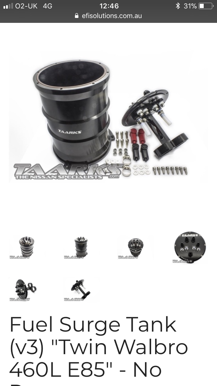

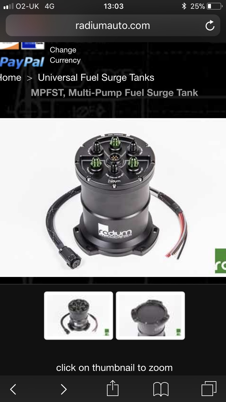

Trying to nail down the final parts of my build just wondered if anyone has experience with integrated ( internal ) fuel surge tanks ?
I’m looking at Taarks and radium mainly atm with twin walbro 450 as they look to be very good quality I spotted ai do one also but not heard much about these
Anyone used or seen either of these in the flesh ? Any other options ?

Pretty much sold on the radium twin internal 450 walbro now after some research. Will update when I get one
