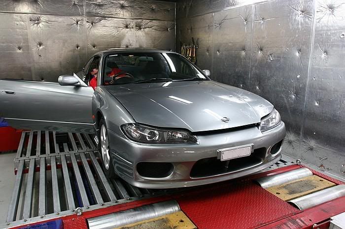

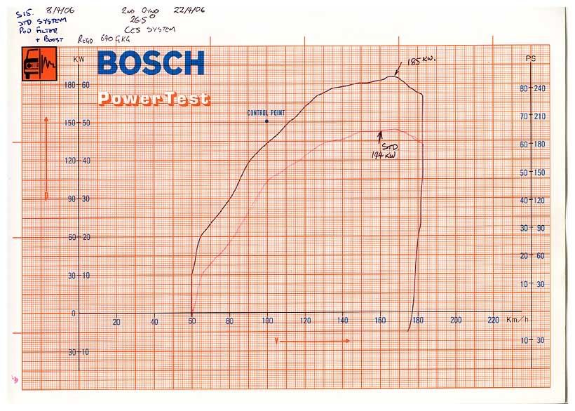

Hi guys, :wave: Great forum!
I posted some images on the old forum but here are a couple of new ones from the first dyno run the car did over the weekend. Gotta love how easy it is for the s15's to pump out more power with minor mods! All I have is a k&n pod and the fbu.
And I thought I'd be pretty happy if the car ran around 120rwkw. Happy for a 149rwkw at the end for a relative standard car at this time.

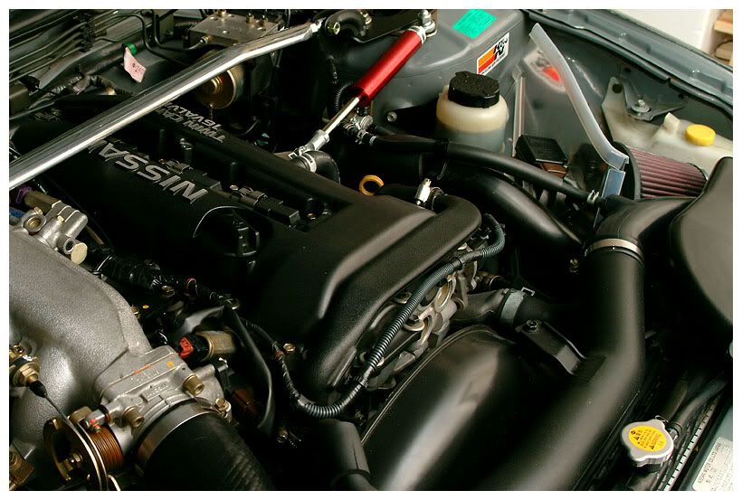

SPEC
2001 S15 Spec R (Australian)
Engine Parts:
- CES twin dump pipe + 3" exhaust
- K&N pod filter
- Bosch 040 fuel pump
- Greddy Profec B II boost controller set @12psi
- Greddy catch can
- Stock turbo (preload actuator with washers)
- Stock WMIC with water spray
- Modified standard BOV to remove the "built in leak"
- Remap standard ECU.

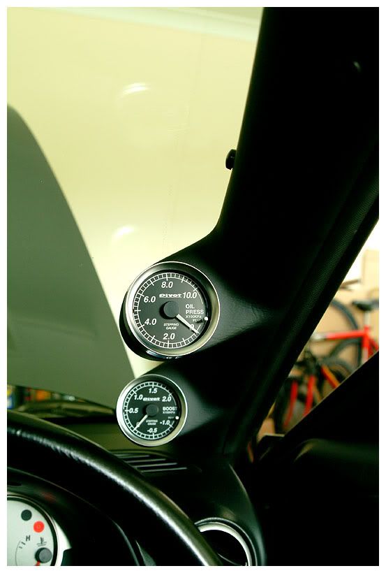

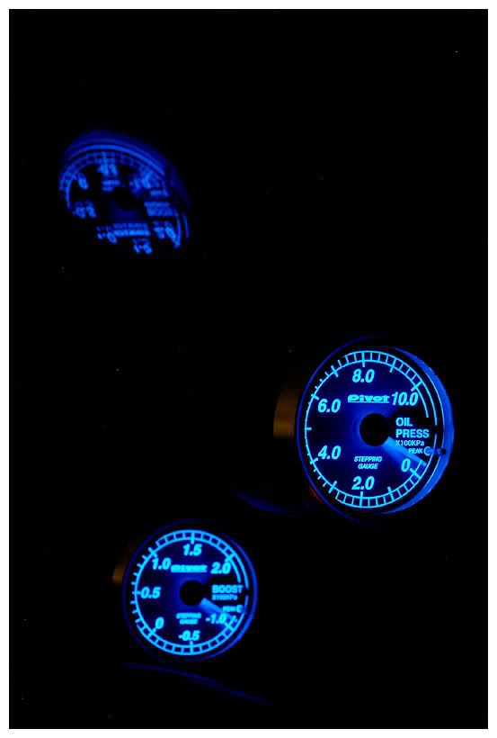

- Pivot gekko boost & oil pressure guage in Greddy A-pillar twin pod
