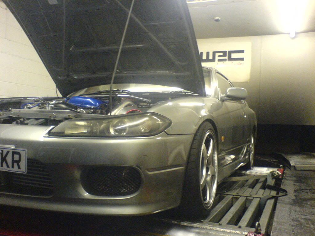

as promised some pics of the tomei genisis engined s15 i built sorry bout pic sizes but brand new to photobucket and this posting pics on forums stuff:wack:

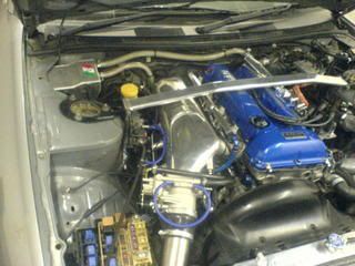

oooh that looks nice, very nice. so come on tell us more what numbers she put down? also thats a wopping big intake plenum, whats it off or is it custom?

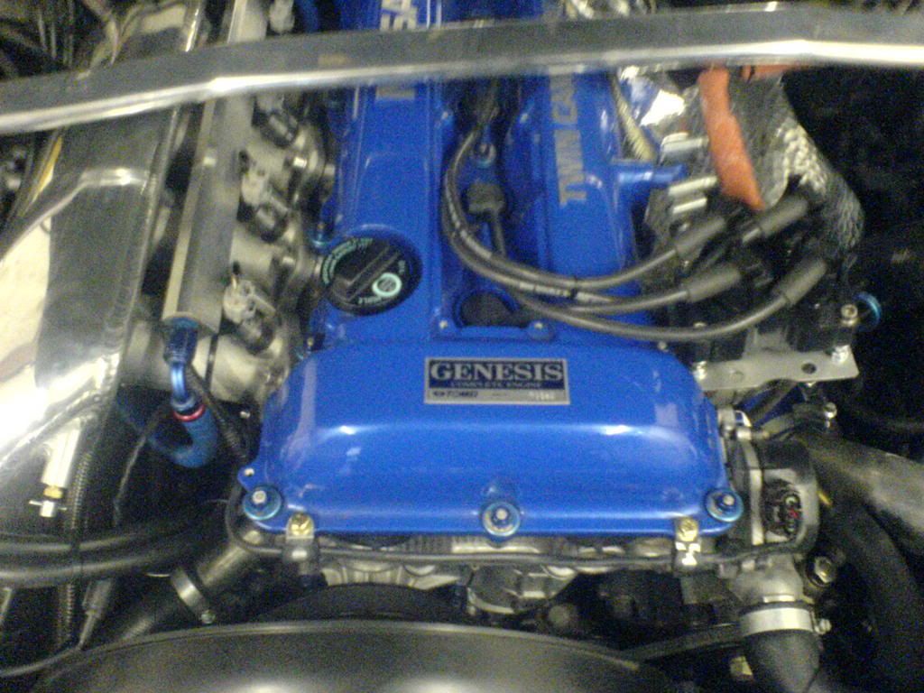

is that distributer im seeing on a genesis?
this is s13 motor?

righty she is a 2.2 as all the genesis motors were with a veilside plenum with nissan q45 throtlle body and blitz 450r turbo kit all managed by a m48 motec ecu .
she made 440bhp at 1.3 bar and 400 lb/ft .
the car is used for drifting and track days .
the coilpack came from norris design

what was holding the fuse box on? can it be moved easily to where you have it there in the pic if you have relocated the battery?
j@garagemac
battery was relocated to the boot and a serise of brakets hold the fuse box in place and the cable from the starter and the alternator were extended .

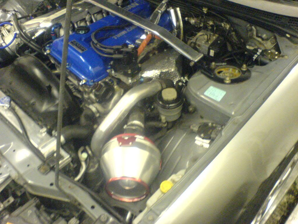

Turbo side looks a bit foreign to me, whats going on there?
j@garagemac
its a blitz 450r turbo kit with custom heat sheild
the kit is based around a k3 kkk turbo with a cast iron manifold
with a 54mm external waste gate with vent to atmos screamer pipe

Nice! engine looks really good
j@garagemac
