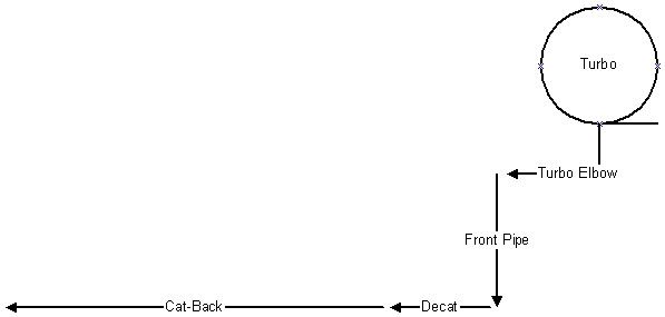

How? Like this...
where does the manifold feature then? Oh god - my stupid brain :rolleyes: .
:nod: Spot on. And you take the mantle of S15OC Paint king :p
Jono
That was a Visio actually! But hey, I'll take that mantle - thanks! ;)
Stil doesn't really explain where the manifold features - is that pre-turbo?

i dont do drawings as i cant draw haha :thumbs:
Engine Block->Manifold->Turbo->Elbow/dump pipe->Front pipe->Cat/decat->Exhaust (usually in two parts).

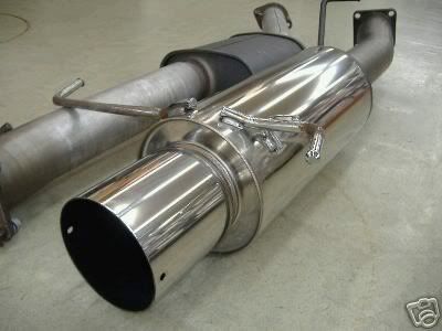

Jono said:
:eek: Is the S word really bad?! Sorry!
Good buy!! but are you sure thats a Silent HKS exhuast and not a Hyper one. Becasue I thought the silent only come with SS centre pipe. They are also seems less restrictive as well, the one you got has a bigger restrictor in the centre pipe compare to normal Silent HKS system.
Correct me if I am wrong Nicely :thumbs: .
Jono
Nicely?
What is it?! what have I bought!? :(
Looks like a HKS Hi Power to me :) The full SS system is the Silent Hi Power.
3 March 2006
363
Manchester & London
Thats is what I thought too. But I am seriosuly doubting that is even a HKS exhuast because I know the Hi power exhasut shouldnt have holes on tip , they are for the bung.
Make sure you asked them because I know a lot of these part trader called these cheap Jap style exhaust HKS "Style" not actually made by HKS.
664
black country
www.coordsport.com
it could be an hks hyper muffler or drager
they had to holes in for the bung.
i did not think the hi power had the holes...although i could be wrong :p
but either way it looks nice and you've got a good deal :thumbs:
