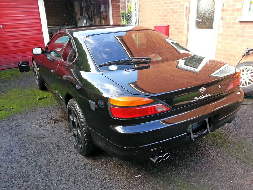

Wow not updated this in ages. It's been in daily use for a while now.
Aligned first day, rear geo was lol tastic.
Had problems getting the wheels refurbed, maybe because of the hollow spokes anyway it took ages and life sucked on the stock 15s. Got them back and AD08R on, traction still a massive problem.
Didn't get on with the BC coilovers, changed to Driftworks CS1, drives just like my old BMW on Monopros, happy days.
Diff installed, big improvement, still not great.
Apex/Hardrace bushed arm kit on, set to -1'15 and 0'20 toe in, way better.
This is where is stands now, still not happy with the steering response. Feels a bit soft and fidgets a lot when driving hard, changing the tension arms/bushes made no difference. Perhaps poly lower arm, rack and ARB bushes might tighten it up?
