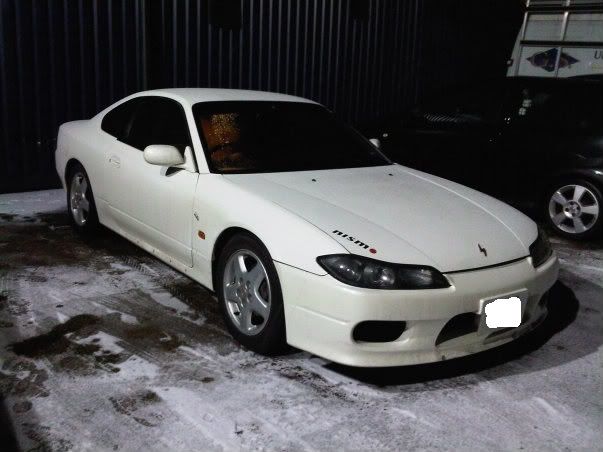

i have rota grids in the same widths and offsets on 255/35 and 225/40's and am running it quite low. rear arches are rolled and front arches have no issues with a 5mm spacer. you will have to run a little negative camber to tuck the rears in nicely but all in all no problems with contact at all or rubbing.@ everyone with Apex Gen2's? Which spring rating did you go for, and how do they feel? After some comfort as well as an upgrade on the Nismo factory option suspension.. Currently i just have lowering springs and it's way to hard!!

I have :Rota GTR alloy wheels 8.5 x 18 et35 front,9.5 x 18 et30 rear,
Nice one Dean, so you decided to keep your 15 then??... ^^Yeah that's what i was thinking, I have it all ready (whiteline setup, with -1.6o on rear lowered and arches rolled.. just need to add coilovers, however put it off for a while due to the expense.. The ride currently is a bit harsh, especially since the snow as the roads are **** - mini craters not pot holes!!i have rota grids in the same widths and offsets on 255/35 and 225/40's and am running it quite low. rear arches are rolled and front arches have no issues with a 5mm spacer. you will have to run a little negative camber to tuck the rears in nicely but all in all no problems with contact at all or rubbing.![]()
