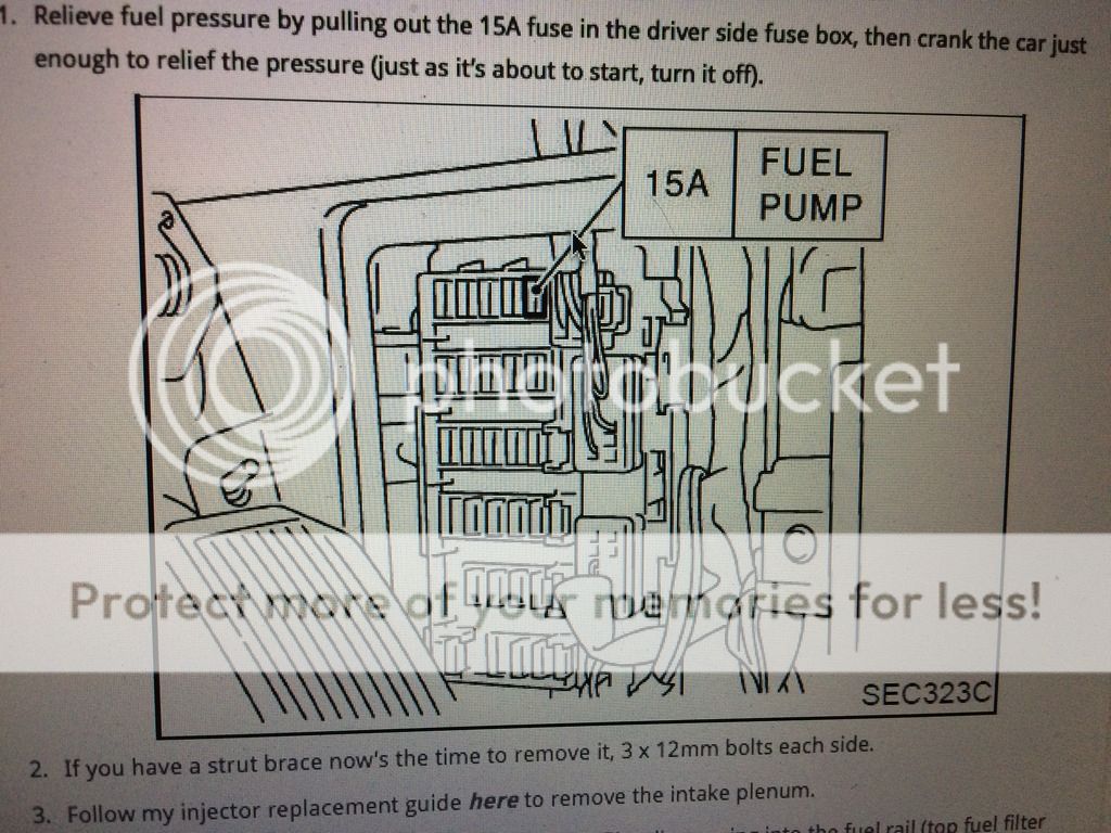

to drain the fuel from the system, start the car and then pull the fuel pump fuse

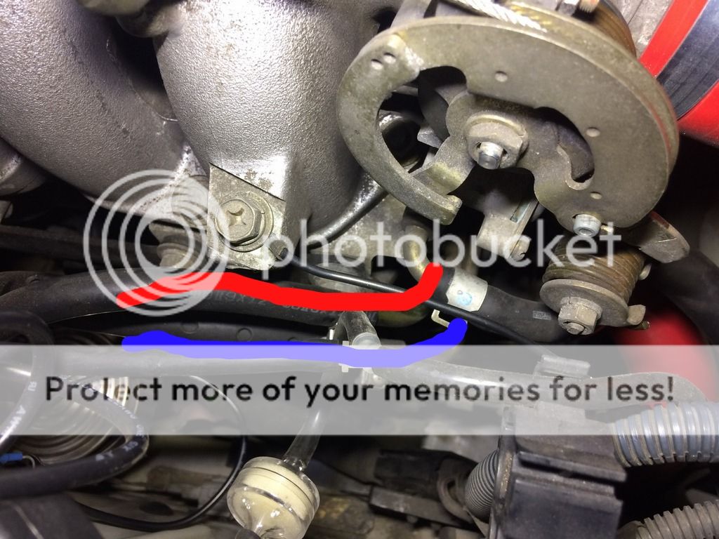

there are two hoses that go to the fuel rail which attach to hard pipes under the throttle butterfly. the top one comes from the fuel filter and is the feed and the bottom on is the return. interestingly the FPR is on the end of the rail and looks like it is AFTER the injectors so it controls the flow by causing push back pressure?
so the pipes below, red shows feed from the filter and blue is the return

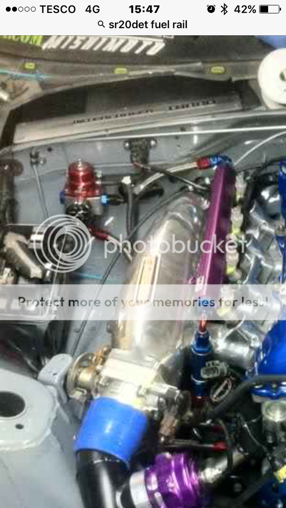

Also, on the aftermarket FPR which is like the one below, I still can't work out how it plumbed in
is the bottom fed from the filter then obviously the side goes in one end of the rail then the other goes back to the return pipe? sorry for all the questions I just can't find jack all on this

On that pic, fuel goes in the rail at the front, then from the back of the rail to the reg in the side, return to tank out of the bottom. The reg is always after the rail, regardless of which way the fuel flows in the rail.
Pump
Filter
Rail
Regulator
Tank
