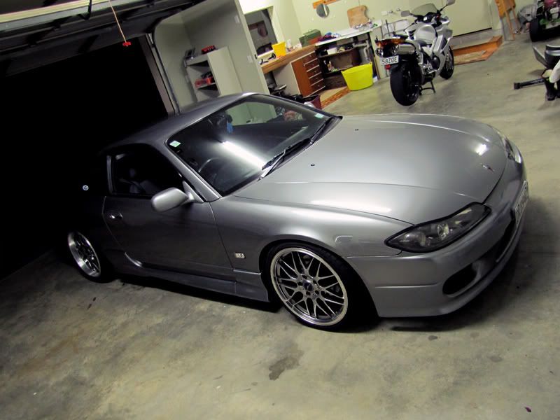

But im from NZ and have a 99 S15
Going to lower it another 15mm in the front annnd 20mm in the rear and it should be at a perfect height , followed by end caps and a front lip off a type r integra :p and a laurfen wing to give it that long sleek look.
Went for the DE+T route as i stumbled across some cheap parts, have a reliable 180kw atw on 10psi but aiming for 200+kw at 14psi :D. It gets used and abused and runs mint.. so far.

Hey welcome, nice car! What wheels are those?
G
Glen
They are Stern wheels from japan :D.
