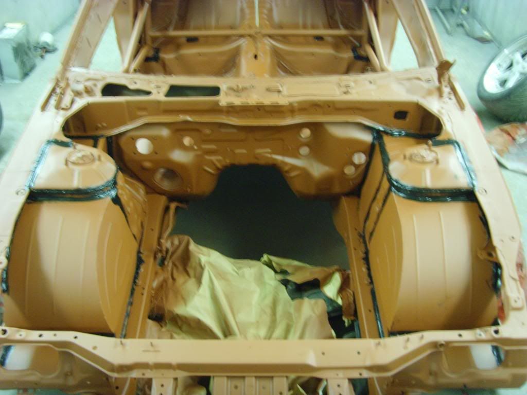

Tubbed arches for maximum lock

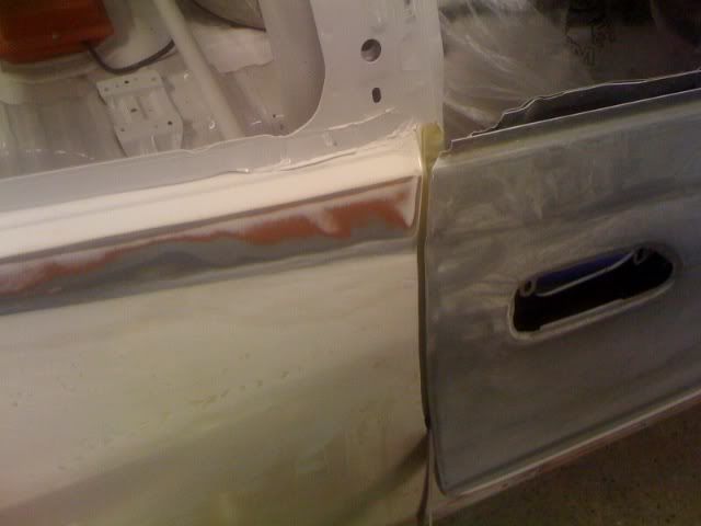

25mm Overfenders, test fitting before we cut out the rear arches
Of to the paint shop for primering inside and out :nod:

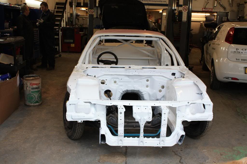

Been primered inside and out and the final white coat and back at the workshop for all the goodies to be fitted

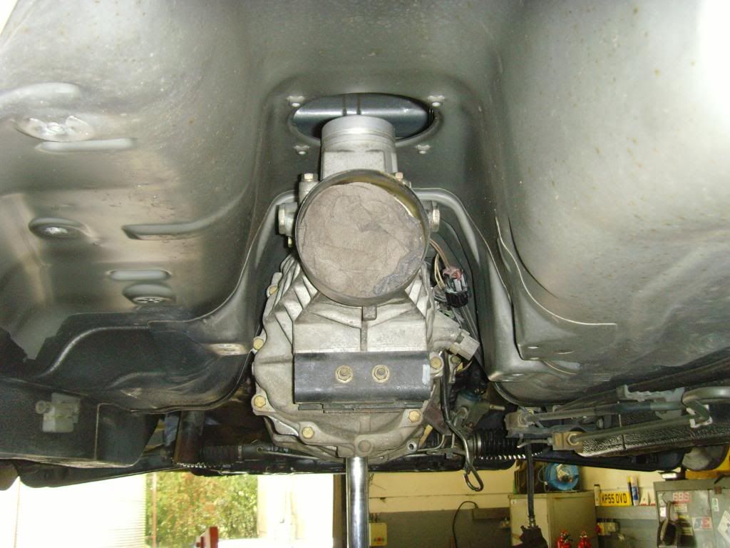

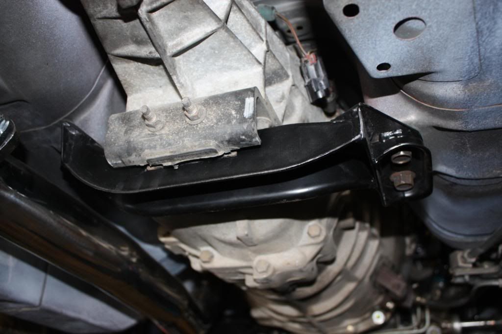

With fitting the RB25 engine we decided to use all Skyline running gear and bolted both front and rear subframes on to the car, all we had to make was a custom gearbox mounts
Final check with engine before this ones goes for paint

Custom Gearbox mounts

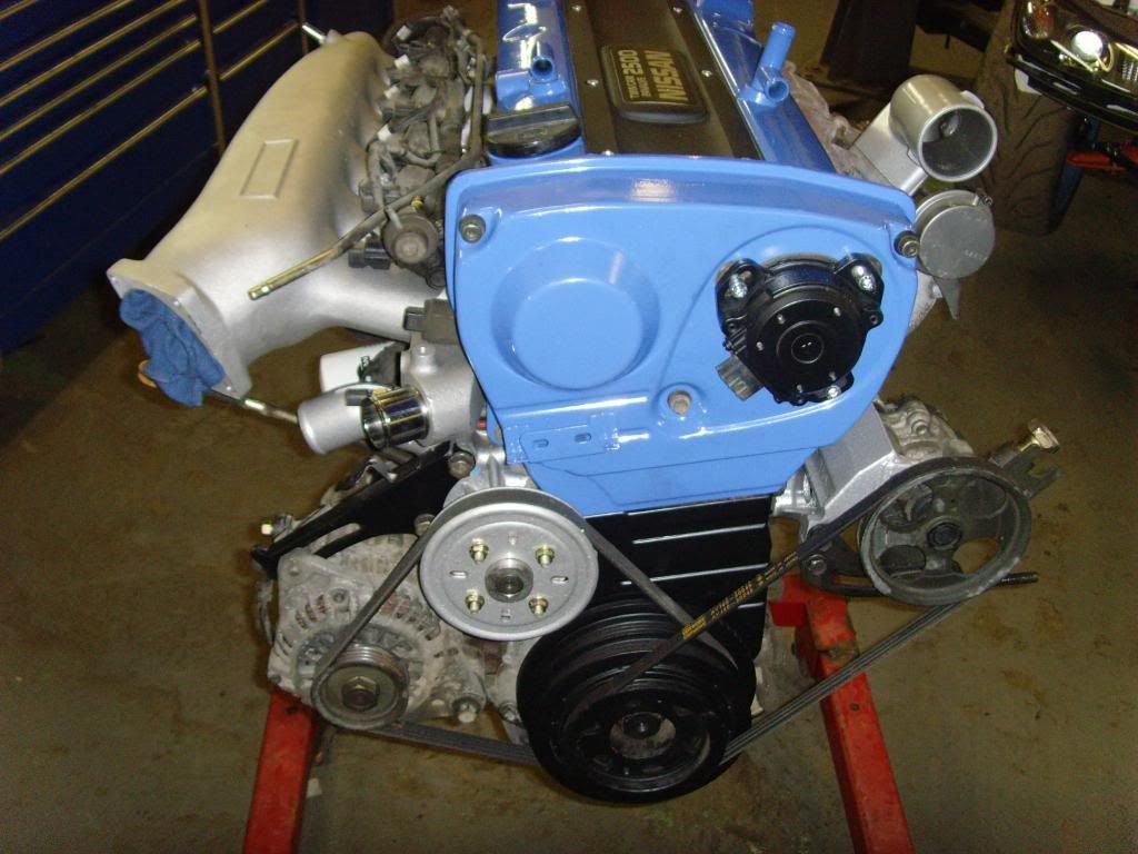

RB25 all ready to drop straight in

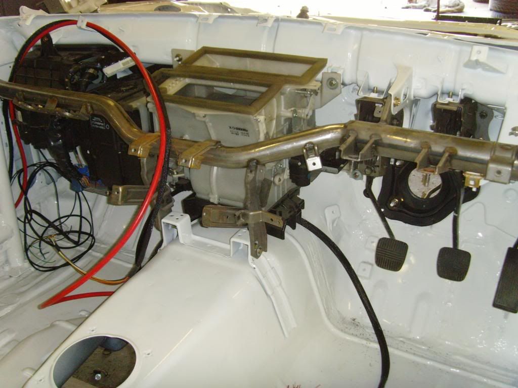

Ditched the standard wiring loom and opted for custom made looms to save on weight and eliminate any electrical problems that may occur in the future by only fitting the bare essentials.

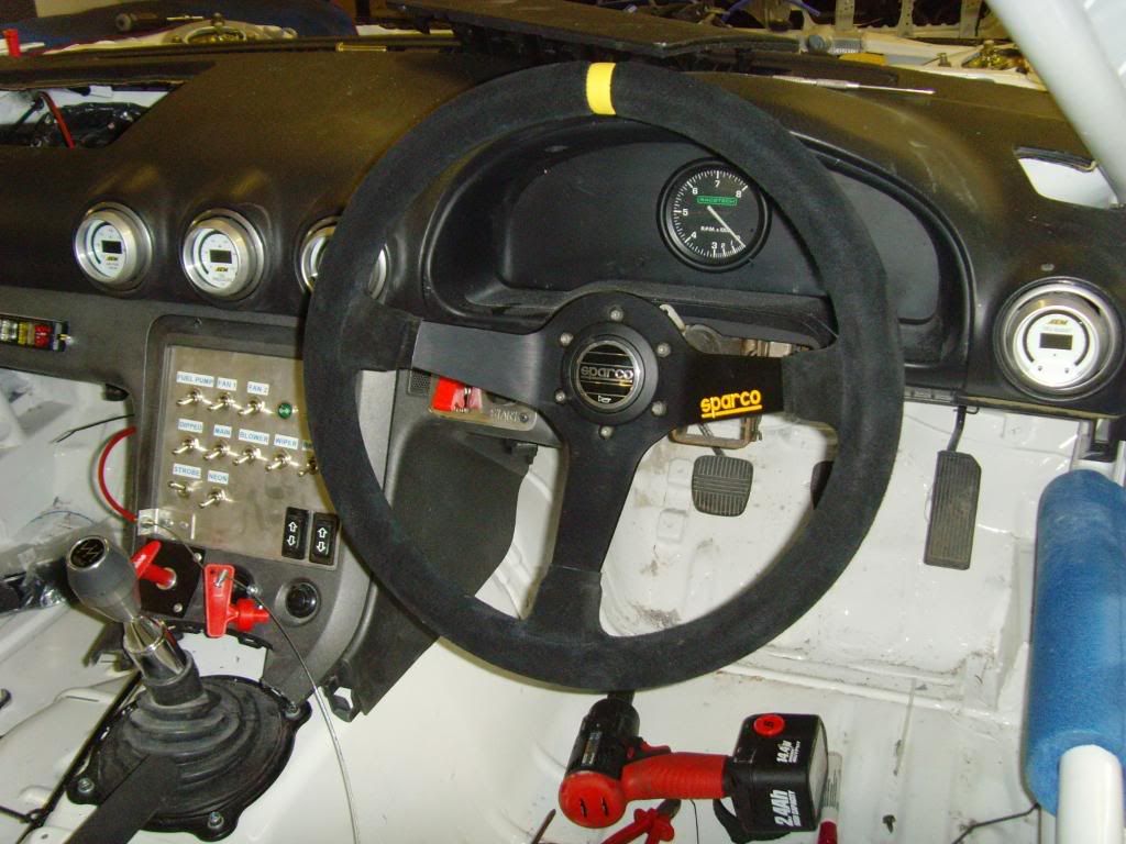

Dash all in and we used AEM gauges and boost controller, just need finer adjustment to the gauges to let them sit further back in the dash.
Everything is on a switch as you can see with the switch panel

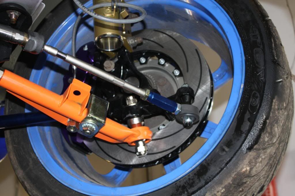

We have used Skyline front and rear subframes, Skyline steering rack
Kazz diff, Solid Bushes, Japspeed coilovers and adjustable arms, DW front and rear lower arms. D2 brakes 8 pots front and 6 pots rear
Nice new extra lock hubs from Japan ;)
Nathan and Andy getting as much lock as possible

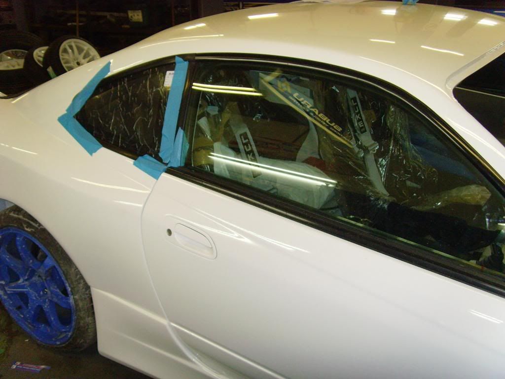

Poly carb windows and we used the orginal seals to make look factory

I have never seen polycarb windows done like that before. Looks like factory items. :thumbs:

WHy did you bother using the R33 rear subframe when the S15 one is stronger and has added bracing?
Surely it would have been easier to just swap the diffs and shafts?
Other than that, nice work.
Oh and you missed the steering gaitors off Paul ;) :D
Matt the gaitors are not on because it's not finished :rolleyes: just getting maximum lock then they will be put back together.
We used the R33 gear as he will be carrying R33 spares to all the rounds and 3 cars will be using the same running gear
