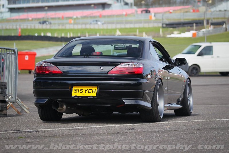

Went to the Fast Show with The Other Guys, had a decent day, great weather!
Car came out great after its full correction. Paint still needs a little more fettling :wack:
Fast Show by LiamB91, on Flickr

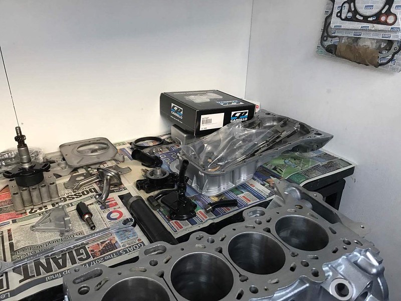

So once this was all sorted, as said, i went allout and got a motor built by DY engine services, DAVE YOU'RE A DIAMOND!
Build pics <3
cpsand block by Liam Browning,on Flickr
machiningby Liam Browning, on Flickr
blockby Liam Browning, on Flickr
Weighingby Liam Browning, on Flickr
moreweighing by LiamBrowning, on Flickr
builtup by Liam Browning,on Flickr
Morefancy work by LiamBrowning, on Flickr
Fancyby Liam Browning, on Flickr
Partseverywhere by LiamBrowning, on Flickr
morebits by Liam Browning,on Flickr
Squishpads removed by LiamBrowning, on Flickr
3angled valve seats by LiamBrowning, on Flickr
