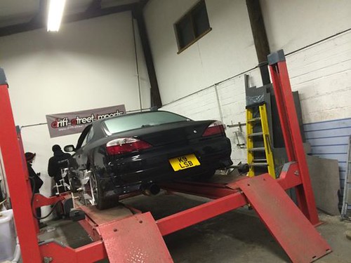

After/ever since i change the suspension setup, the car drove horribly so light on the front, so looked into it. Found the problem as the alignment was miles out.
So bought full driftworks arms kit and had that fitted along with full alignment for fast road driving by Drift Street Import (recommend these guys)
Alignment time by LiamB91, on Flickr
Then it was time to get the car clutch problem sorted so the car went back into Drift Street Imports last week for alot of work :)
