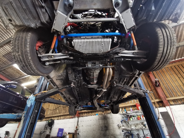

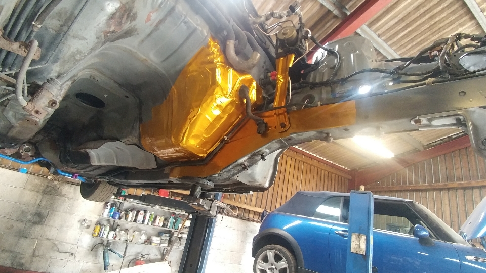

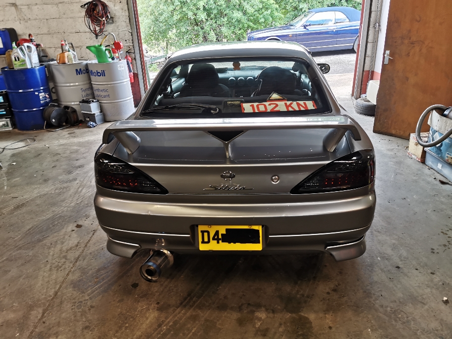

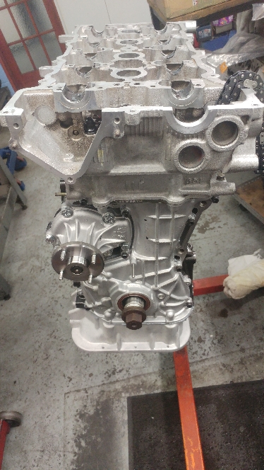

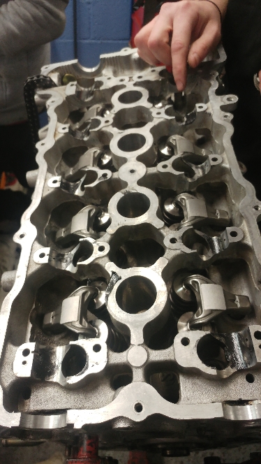

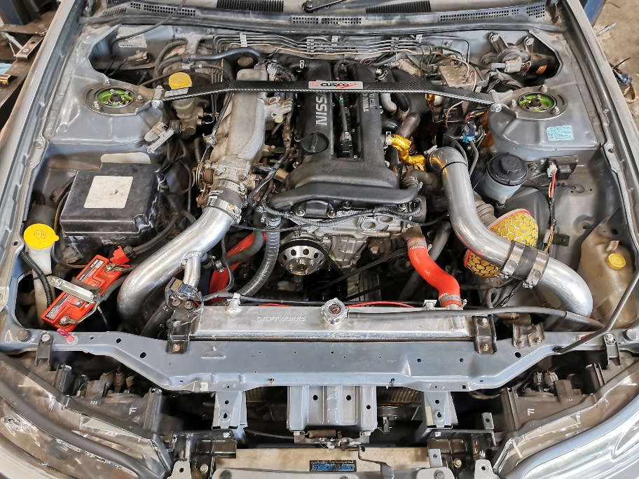

Hi everyone this is my 1999 s15 which I bought 10 years ago completely stock. Over the last 8 years I've been buying parts and building it over the last 2. I hope you like it.
Sent from my VOG-L09 using Tapatalk
26 June 2020
13
3
South East
Cheers man.

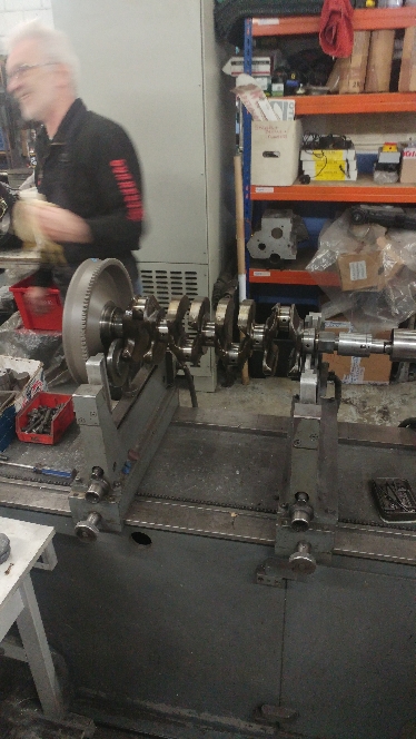

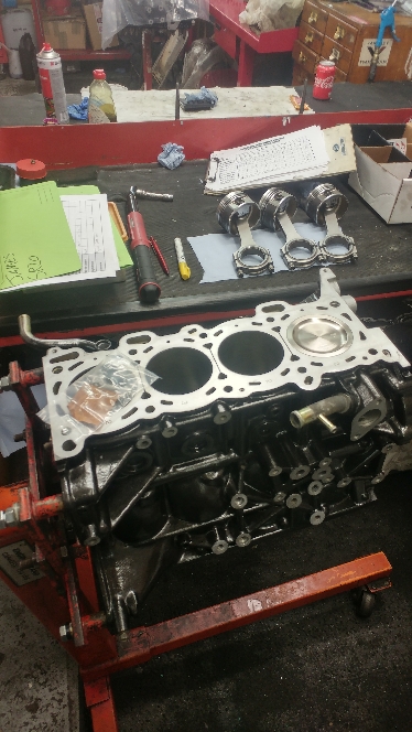

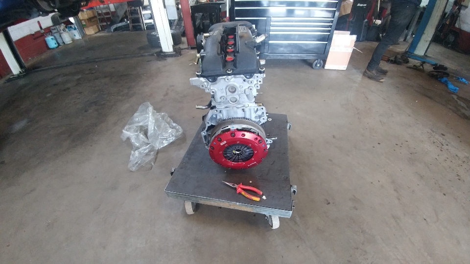

It has 272 bc cams
Bc titanium retainers and springs
Tomei over sized valves
Bc valve guides
Ported head
Cosworth headgasket
Headstud kit
Wiseco pistons 86.25 bore 9.1 compression
Maney con rods
Race bearings
Balanced crankshaft with flywheel, clutch
Gfb solid crank pulley
740 DW side feed injectors
the engine had new oil pump, water pump, timing chain kit and gasket set at time of build.

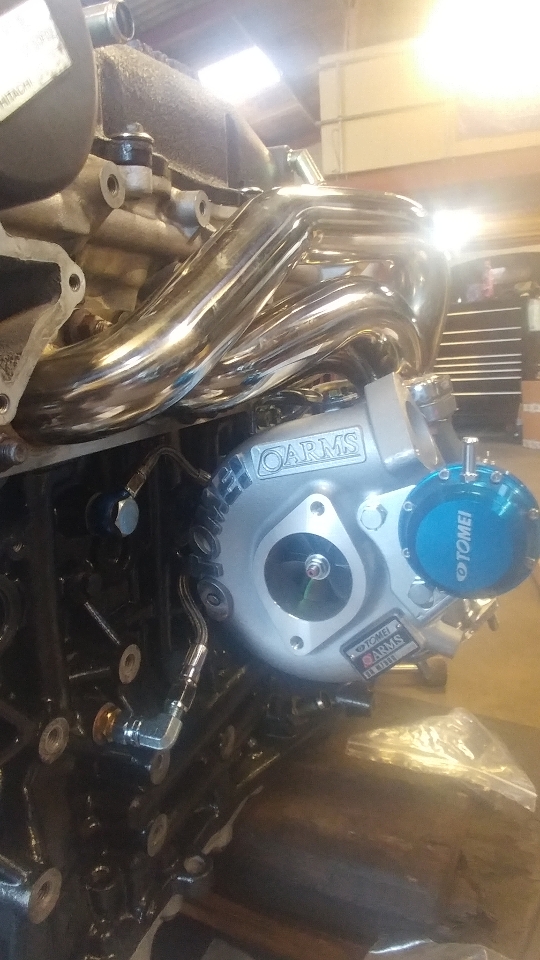

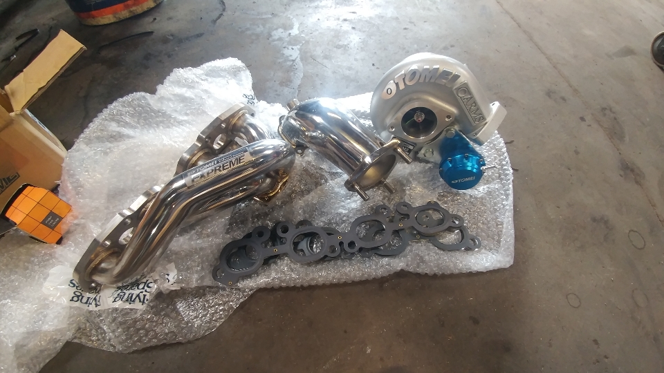

Nicely spec’d dude ! Which size tomei turbo is that ?
Seem to get some Nice results with those
Sent from Big Bear Kustoms Ltd
26 June 2020
13
3
South East
Cheers guys. it's the smaller Tomei m7960 turbo and Lewis to answer your question. Only 300 at the wheels went to get it dynoed but had an issue with the cams so hopefully once this issue is sorted will be able to turn up the boost with no worries. Will keep you all posted once it's 100% up and running.
