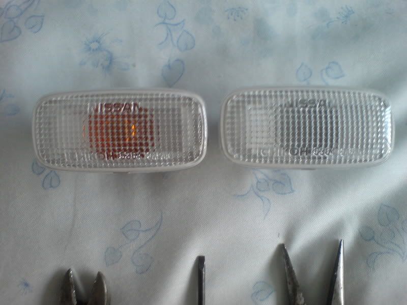

Looking at them i think i can get the orange part out i'l let you's know if i do.
P
Paul D

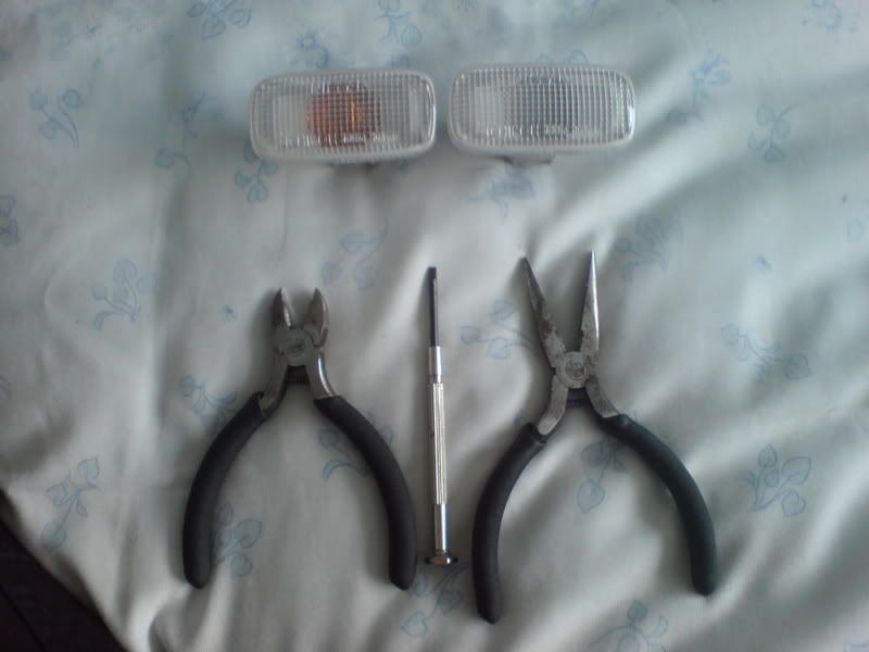

Right had a quick go and its easy. The tools i used are in the pic if anyone's interested in doing it to theirs.

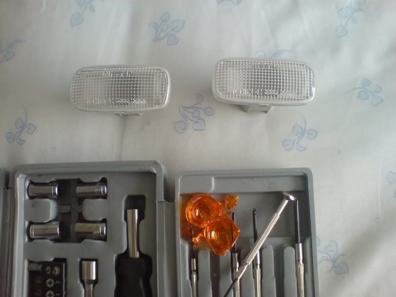

All you need to do is break the orange part engough to pull through the hole where the bulb goes. If you can get the orange globe to the top then use sidecutters to cut it and it will twist out :D
Here's pics
Now im going to buy some of the chrome bulbs off ebay for a couple of quid and jobs a goodun
