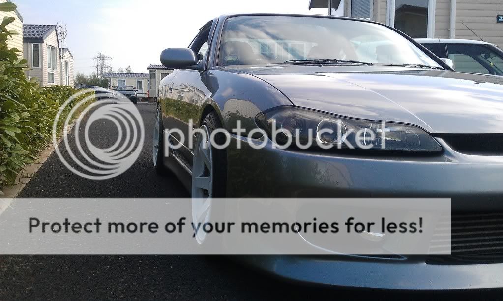

Anyone have any pictures of standard s15 front wings rolled/stretched to fit slightly wider rims? Have been looking around on differant forums and can't find anything?any help greatly appreciated

What sort of size we talking buddy?had my wings rolled to fit 9" et20 on the front but you can't see that from outside. Just rolled the lip flat on the inner arch. Assume you mean flared arches?

18x9.5 + 20mm spacers, just the standard wings rolled
18x9.5 ET30 + 20mm spacer (215/45/18)
