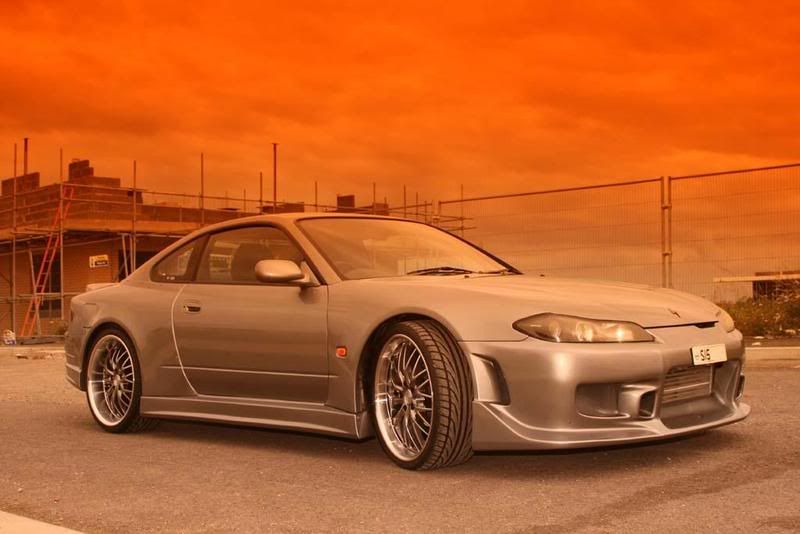

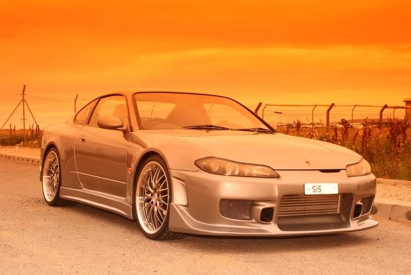

heres a c-west widebody kit we supplied to a uk customer a couple months ago not bad job i think hes done quite a smooth kit

BTW. how much is that kit?
are the wheels 19"?

i forget the price now the customer lives in the uk and we did it at a good price was about ?1950 including vat and postage it was a kit we had laying about for ages and taking up valuble space so gave him a good deal it should cost more,
i dont know if the rims are 19s or not the customer just sent me the pics i posted and a email to say thank you very much

Hi just spotted my car above on this site so thought I would register and fill in any questions.The kit is superb and fits like a glove Invo-Tec where I got it from were excellent and i would recommend them,the wheels are 20" and 10" 285/25/20 on rear 8.5" 245/30/20 on front and are from Wheelmania in Rochdale,UK,as for cutting away the archer I just cut sliced them upwards then bent the excess up into the inner arch took no longer than an hour to do both sides.Any more questions ask away will answer when I can.Glad you like it thanks for the comments.

Ye fitted it myself,the C-west kit is absolutely brilliant it fits perfectly I only had to fit a bracket off the original bumper to the C-West one and the cutting out of the rear arches which is a bit of a worry when you do the first cut but the end result is well worth it,slicing it and bending it up I thought was the best way to do it as it keeps all the integrity between the inner and outer arches.

Rears are as stock but the fronts took some work, cause of the size of the wheels I decided to leave out the arch liners and completely cover it with underseal just need to make a plate to go at rear of arch to stop crap being thrown down towards the door area,when its done will post some pics lots of hammering on inner arch to stop the wheel rubbing on full lock but if you take your time it looks ok.

The S15s that did wide body conversion I came accross had to cut the rear wheel arch lip off by some 1.5" to accomodate wider track on tyres that would otherwise hit the arch when the suspension retracts.
That means that the rear inner arch will be exposed after the outer arch lip cut and welding will be required to close up the exposed portion.
I had the chance to place my hand into the rear wheel arch to feel the contour of the Garage Defend S15 that had widebody on it during a recent car show. I could feel weldings definitely.
Since you did all work yourself, it would be great that you can tell us if it were necessary to go throught welding after cutting the wheel arch?
If I understand your earlier post correctly, you only had to slice the rear outer wheel arch lip into a few sections (cut depth?) and then bend the sliced sections upwards and inwards into the wheelwell to clear the wider track required for the new wheels and rear fenders to go onto the car.

sillbeers15 Y
