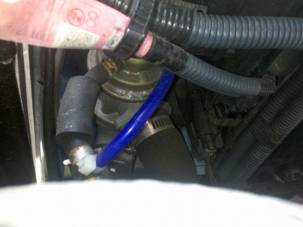

how and when should you modify the stock bov?
Do it any time,just means it will hold higher then stock boost.
Remove the blow off valve from the base, 3 screws from memory and just to the side of the diaphram you will see a small hole. Block that of with a small screw. Once I did that I cut the head of it off with a Dremel so it was flush.

I wondered what that does, is it just a bleed off hole?

It's simple but effective, and if you can use the OEM product it has to be a good thing.
