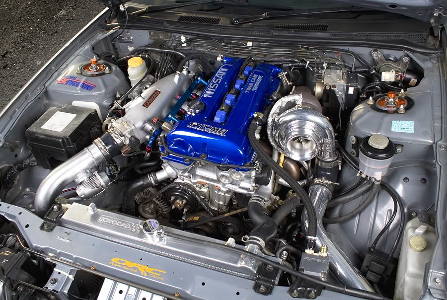

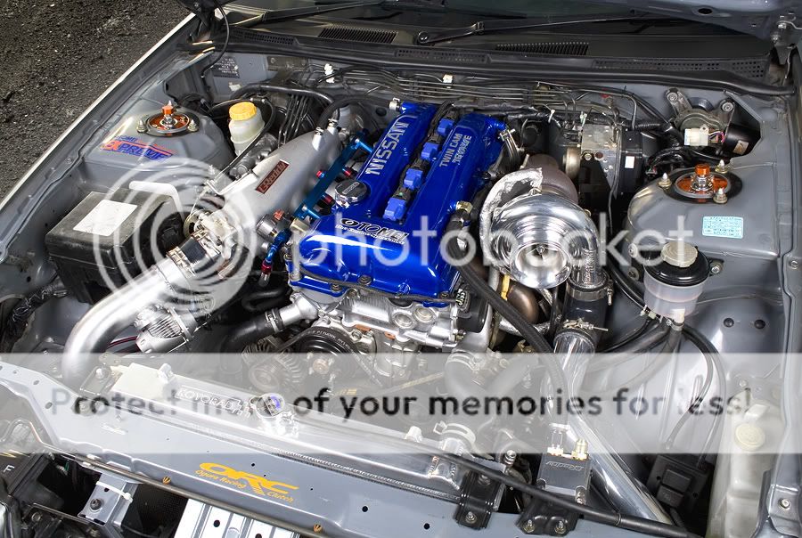

This is my 600hp Mod list, I'm sure there are things missing but thats the main stuff.
Standalone:
Tomei Reytec MAP Based Standalone
Head:
Headgames did the head, Port Polish, Multi Angle Valve Job, Combustion Chamber Clean Up, Port Matching, polished combustion chamber.
Supertech Dual Springs and Ti Retainers
Supertech Locators
Supertech Valves
Supertech Valve Guides
Tomei 270/270 Cams
Block:
CP Pistons (9.0:1) 86.5mm Bore
Eagle Rods
Cosworth HG
Honed
Line Bored, and all new nissan bearings etc.
ATI Crank Pulley (Not Pictured)
Turbo:
Precision Turbo HP6262 Billet Turbo
Peakboost Manifold
Greddy Intercooler
Tial MVS Wastegate
Blitz SBC ID-III Spec R Boost Controller
Custom 3" Downpipe
Custom 3" Exhaust
HKS Muffler
Intake:
Greddy Ver. II Intake
Tomei 70mm Throttle Body Kit
4" Turbo intake pipe and K&N Filter
Iginition:
Spiltfire Coilpack
NGK Iridiums
Fuel:
Injector Dynamics ID-1000cc SAturated High Impedence Injectors
Greddy Fuel Rail
Aeromotive FPR
Walbro Pump In tank
Bosch In Line
Money Shot:
