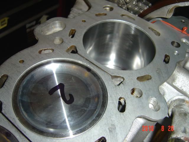

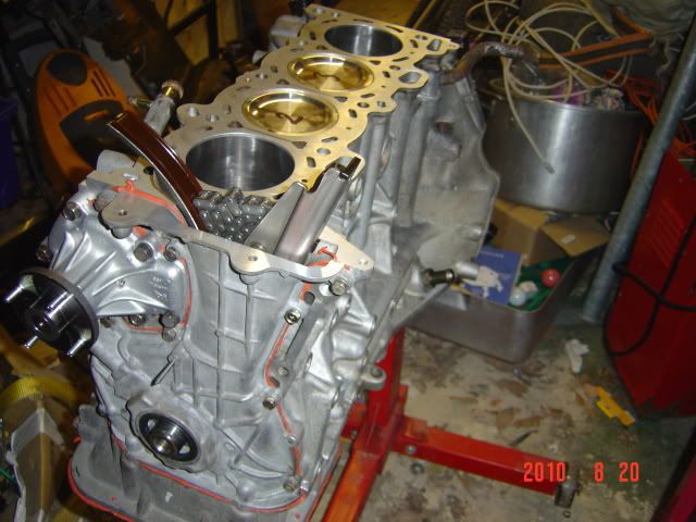

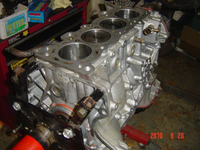

What we have here is a fully built bottom end, By Horsham.
Bored out to 86.5mm
honed
decked
ACL race Bearings
Stco Crank
Stock Rods
CP Pistons
New water pump
New oil Assy
New crank seals

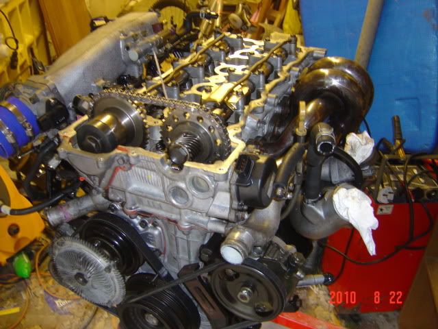

She Lives!
Fired up Yesterday, idle for about 15 - 20 mins to allow the cams to settle in and me bleed the coolant and power steering.
I then made a cuppa Tea which allowed me to check the oil leval before going out and bedding the engine in.
I'm now 70 miles in, and cars is ready for her first oil change!
Remap with Z32 and Nismo 555's with Horsham in 6 days, so will need to rack some miles up ASAP! :):):):)
