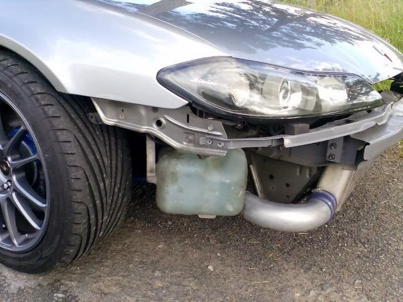

as as for fmic i went for the greddy spec m one which didnt need any mods to the actually body off the car only hitting each side near the side of the ic just bend them back or cut them off either way will work...and fitment was good as for price a little bit more expensive than others but i didnt wanna cut the bar behind the bumper...
the kit comes with bits to turn the bottle washer around and bumper will need trimming a bit aswel...

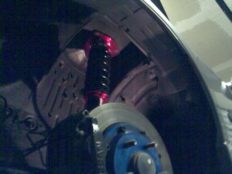

Finally got round to fitting the front coilovers, so thats them swapped all round :thumbs:

hey man how do u find ur 310mm brake kit is it a good job?
Yeh it was quite easy to fit, got a few snap here from when i did it, seems like ages ago now :) -

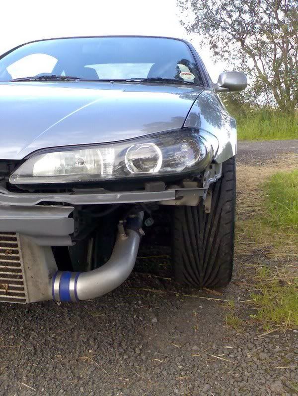

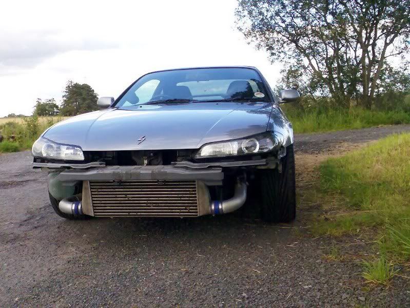

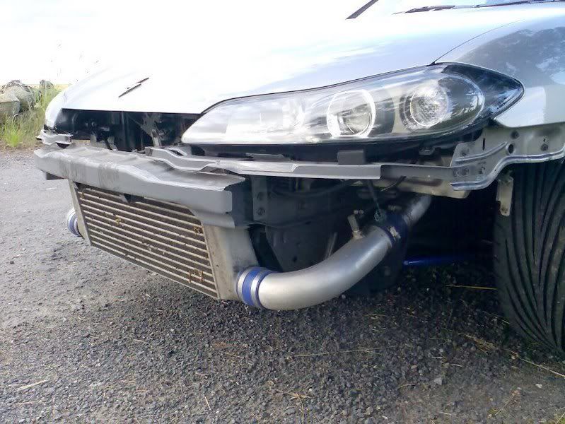

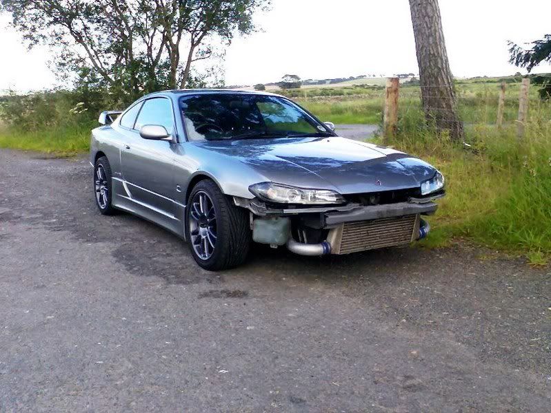

Went out for a a little drive to make sure nothing was rattling etc, had the bumper off so i could get the jack under the front of the car -
Washer bottle shot for Yako :wave:
The FMIC is covered in butterflies and large moths, so will need to pick those out sometime :D
