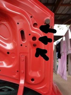

Hey guys. I just bought an aero wing, which my car didn't come with from the factory, but I noticed the boot has three holes stamped which look like they would be for the wing? All the boots would've had that I assume. Is this where it bolts on? I'm deleting the middle pillar, so I'm not worried about the middle. My car had the Aus & NZ 200SX spoiler originally.

Yeah that’s right, just the top two though. Maybe the bottom one is just another access point but it’s the two larger ones which are used.

Thanks. So does that middle plastic bit in-between the bolt threads sit in a grommet or something? I was hoping I could drill the hole for that from the bottom too.
I almost need a template or something, so I can get it perfect.

Not sure which bit you mean, could you take a picture?
It was ages ago that I took my wing off (needed some sealing) and mine had some rubber gaskets the same shape as the bottom of the support that went in between the boot lid and the wing supports.

Makes sense they would have little rubber rings for the bolts, as it would rattle without them. Not sure where I could get those. It's taken me months to find these aero bits locally.

Oh yeah I see what you mean. Mine didn’t have that... mine doesn’t even have the hole for it so I guess my spoiler was an add on too.

I was also wondering, when you open the boot, are the bolts in the exact center of those holes? I was thinking if they're right in the middle, I could get whatever socket size fits in the hole, and mark out the center like that?

BUT, I did have a look at the bolt holes and they are in the centre of the pre-formed large holes in the boot lid. If you can mark a hole perfectly in the centre of that you should be fine.

The Angry Saxon is spot on, just drill in the centre of those two holes on either side of the boot lid

Yeah I used sockets that fitted in the holes, and marked the centre with a pen. It turned out well, perfectly centred.
Now I'm just patching up the hole with fibreglass, and just need some bog for a thin layer to finish it off.
