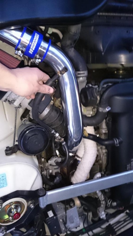

I eventually got the intercooler fitted but have a few issues to work out and hoping someone might have the answers.
Question 1: What does this hose do? and how can I reconnect it? do I even need to?

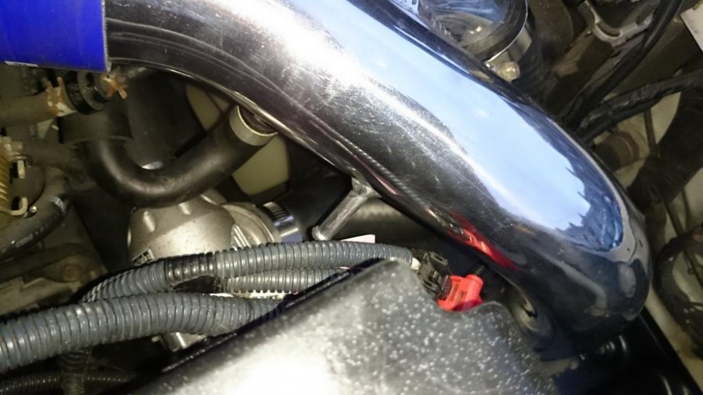

Question 2: Whats this bit for? do I bung it or is there something I'm supposed to connect to it?

Connect 1 to 2 with a longer piece of hose. That's your stock boost control valve so it needs a boost signal.

and yep as the 2slowforyou mentioned above you connected the hose you have in your hand to the bit sticking out of your cold pipe, obviously with a longer bit of silicone hose, ( 4mm inside diameter is what your looking for )

4mm ID right through? the original hose looks bigger for some reason.
