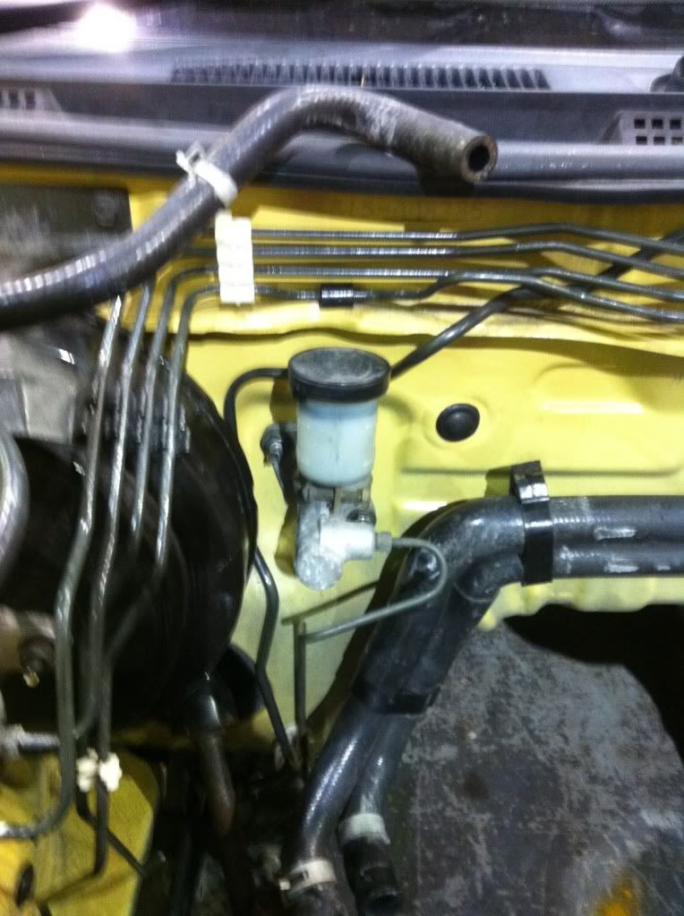

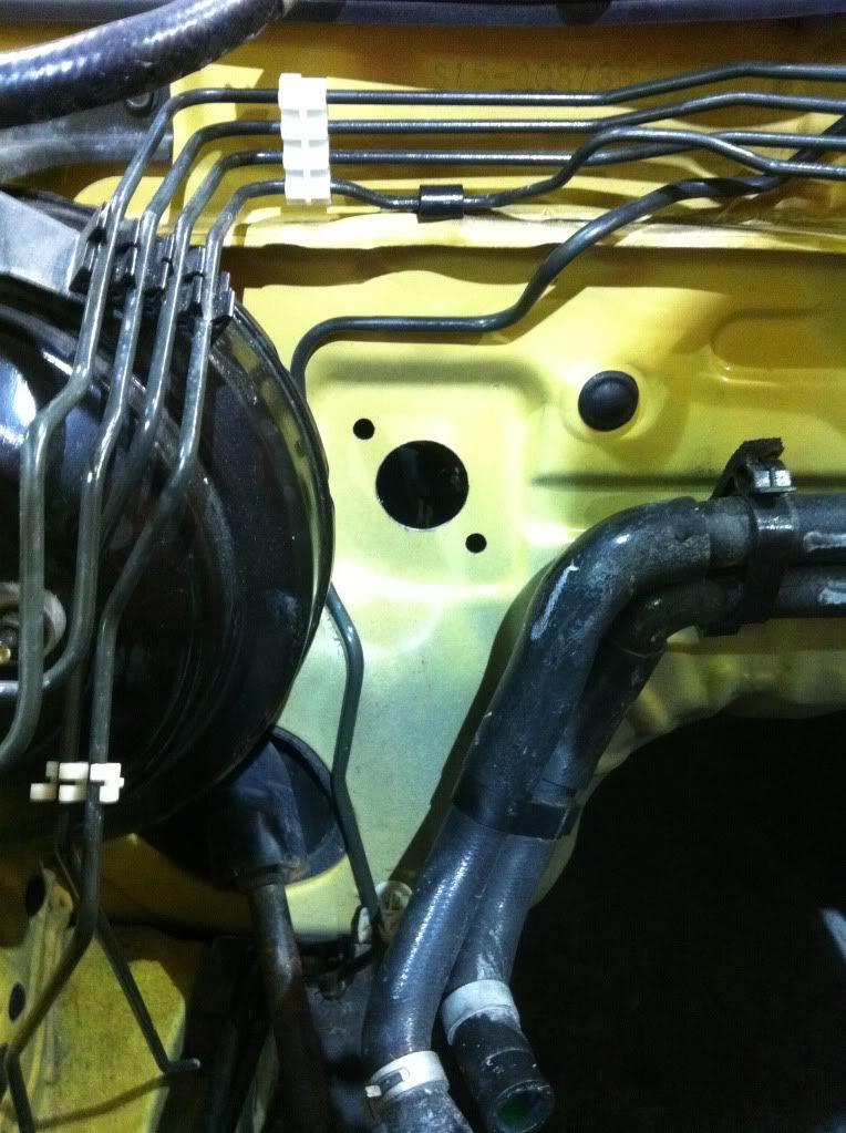

looking good mate - the clutch master and pedal install should just be a case of removing the system from the s14 and then measuring the exact position/making a tracing or template of the holes in the bulkhead, then transferring them over to the s15 ;) dont bother with the compensator pipework between the master and slave, just buy a one piece braided line for 25 quid to make it easier :) i'd imagine sorting the wiring will be the most awkward thing of the whole conversion....

Actually when I did my conversion from auto to manual, when I removed the dash and firewall heat proofing, there was a template already there for the cutout of the master cylinder. Was easy stuff really. Template was to the inside of course.

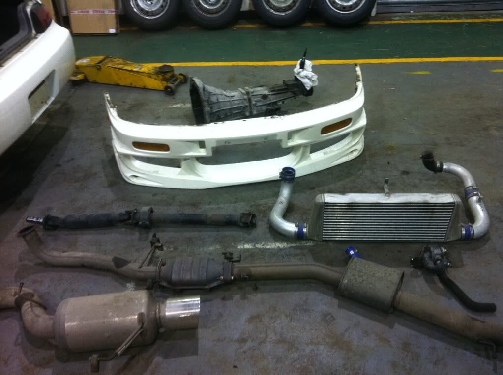

Just a quick update of my project, finally started stripping the S14, started work on it on saturday afternoon after work and managed to get the engine pretty much ready to be lifted out by 6pm got the gearbox off, prop, exhaust, radiator out etc so will hopefully be lifting it out monday night? will keep updating as i make more progress

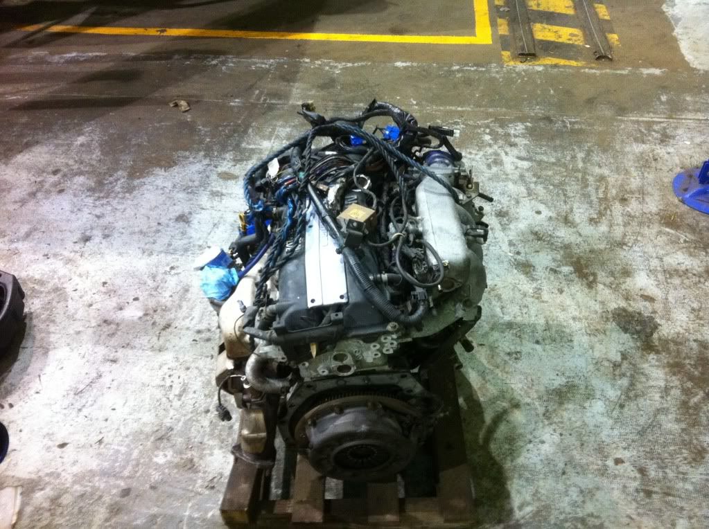

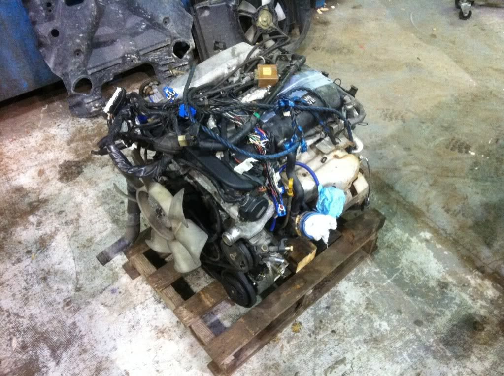

Another quick update, took the engine out tonight, it was quite easy really just a few more things to get from the s14 now like the clutch pedal and master cylinder etc. will start work on the s15 soon

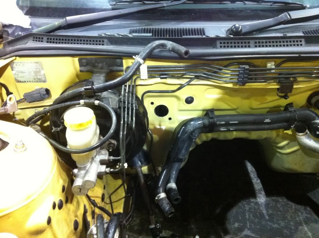

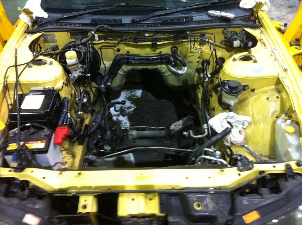

Just another update of the on going project. Got the engine from the s14 all prepped now, new clutch, waterpump and thermostat, all belts replaced. Replaced the bearings in the gearbox, so set upon the yellow S15, got the exhaust system, prop shaft and gearbox stripped last night along with the wiring loom and ecu, so tonight i stripped the engine down and took it out, drilled the holes for the cluth pedal and master cylinder and installed that, and then dropped the sr20det into it. Will be slowly building it all back up this week so wont be long now, having a few problems with the wiring as the s14 didnt have abs, ive had to strip the loom from the sr20de and take off the abs and side light feeds that are attached to the engine loom, will keep updating my progress.

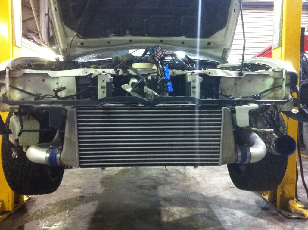

Finally got the engine and box in now, all running so just a bit of tidying up to do now, i will add more pics when its finished and setup! its been a lot bigger project than i thought it was going to be, had to get the prop shaft shortened slightly and re balanced, the amount of wiring has been the biggest problem but im nearly there now!!!

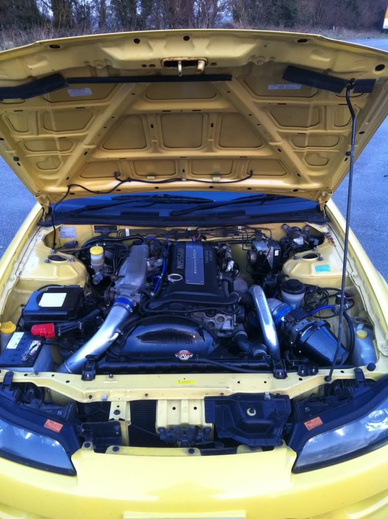

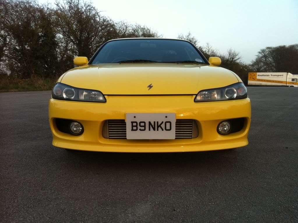

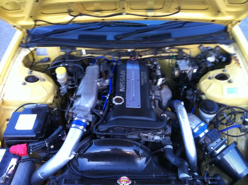

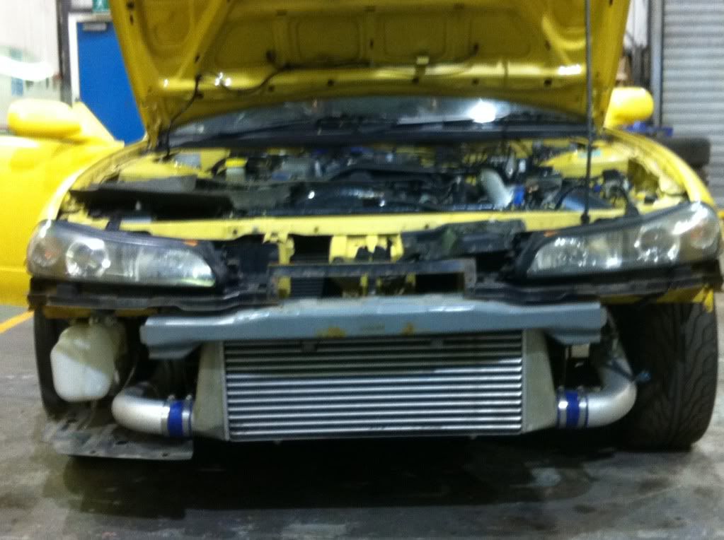

HI people, havnt updated my build for a while so thought id put my latest pictures and spec's on, and just a general update of how its progressing.
Spec so far is:-
Power FC mapped to 0.8 bar
blitz intercooler
blitz nur spec cat back system
3" downpipe
apex short shifter
Apex Turbo Elbow
depo boost gauge
Apex de-cat
Apex rear Camber Arms
Strut brace
Tegiwa engine damper
Tegiwa bmc Stopper
HKS air filter

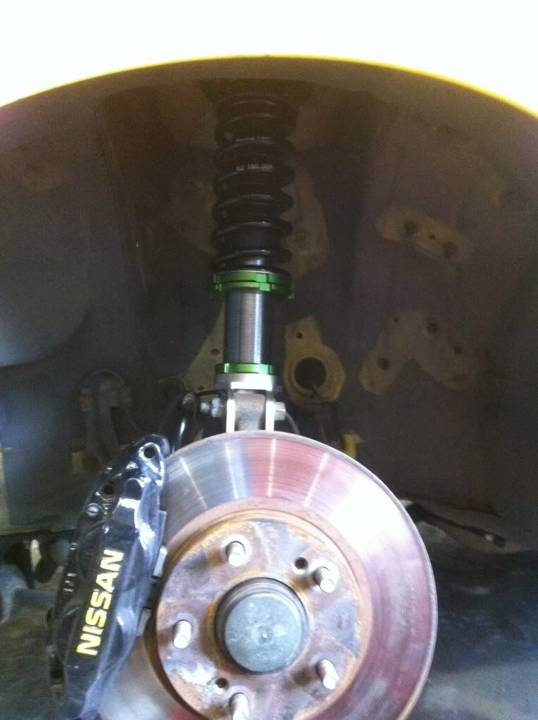

Racing Logic Coilovers (these coilovers are awesome and i would recommend them top anyone, my friend is a supplier if interested)
Buddy Club P1 Wheels, Rear 17x9 Fronts 17x8
Aero rear spats (bought from carbonkit from the forum)
Had the car rolling roaded at Protuner and got a healthy 280bhp at the flywheel and 236bhp at the wheels. Thats just the map that was on the s14 i imported from Japan, greg at protuner reckons i could see 300bhp with a re map easily.
Also ive got an aero front bumper to fit (fibreglass) which is the next step of the project ready for JAE.
Here are some pics, sorry about the quality but its from my iphone
