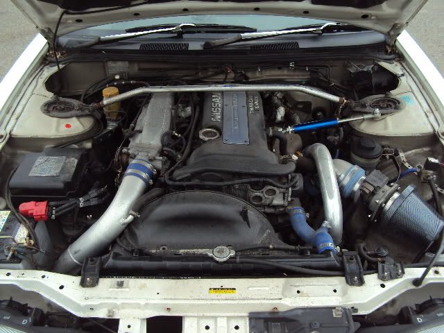

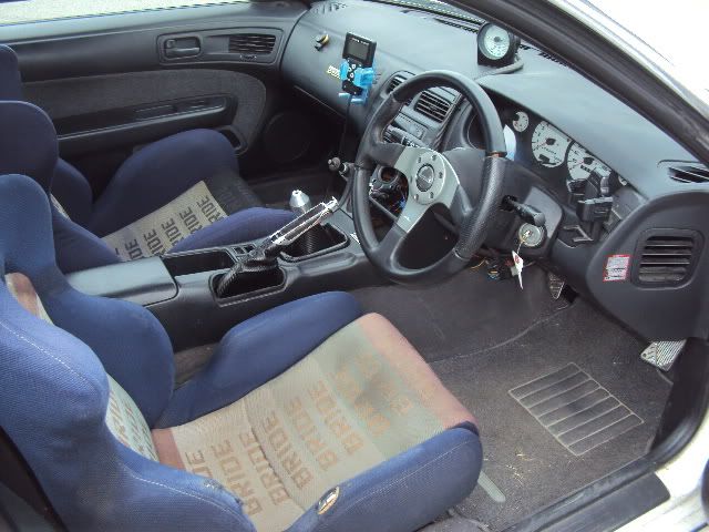

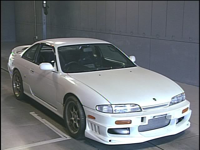

This is the S14 ive got for the conversion, the mods are:-
Apexi FC Power Commander
Front Mount Intercooler
Coilovers

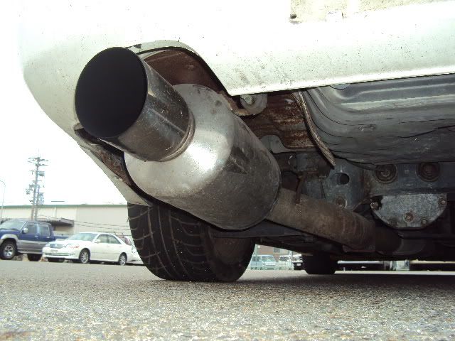

Full exhaust system (with some sort of exhaust flap)
Bride seats (not in great condition)
Boost guage
Turbo timer
Enkei racing s alloys i think
Any comment welcome sorry for how long the post is, this is the S15

You've done the right thing getting the s14 as a donar - pretty much everything you need for your conversion is on the 14. The coilovers, brakes, engine, box, clutch and brake pedals and engine loom can all be used straight swap. No problems with the speedo coz the s15 pulls its speed info off the abs sensors on the front hub. The only thing i can think of that wont fit is the exhaust(you have to get it shortened or vice versa). Good luck with the build!:thumbs::thumbs:

Exhaust will need adapting slightly. Brakes will swap over, as will the coilovers. The passengers bride looks good too.

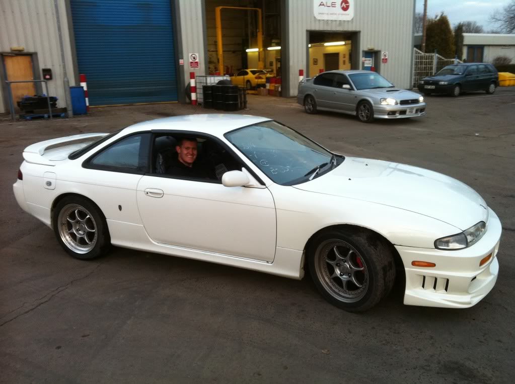

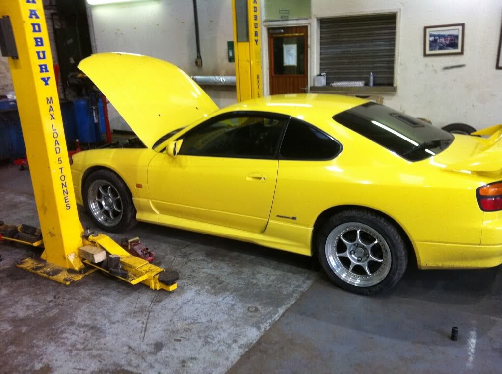

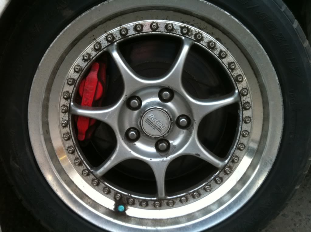

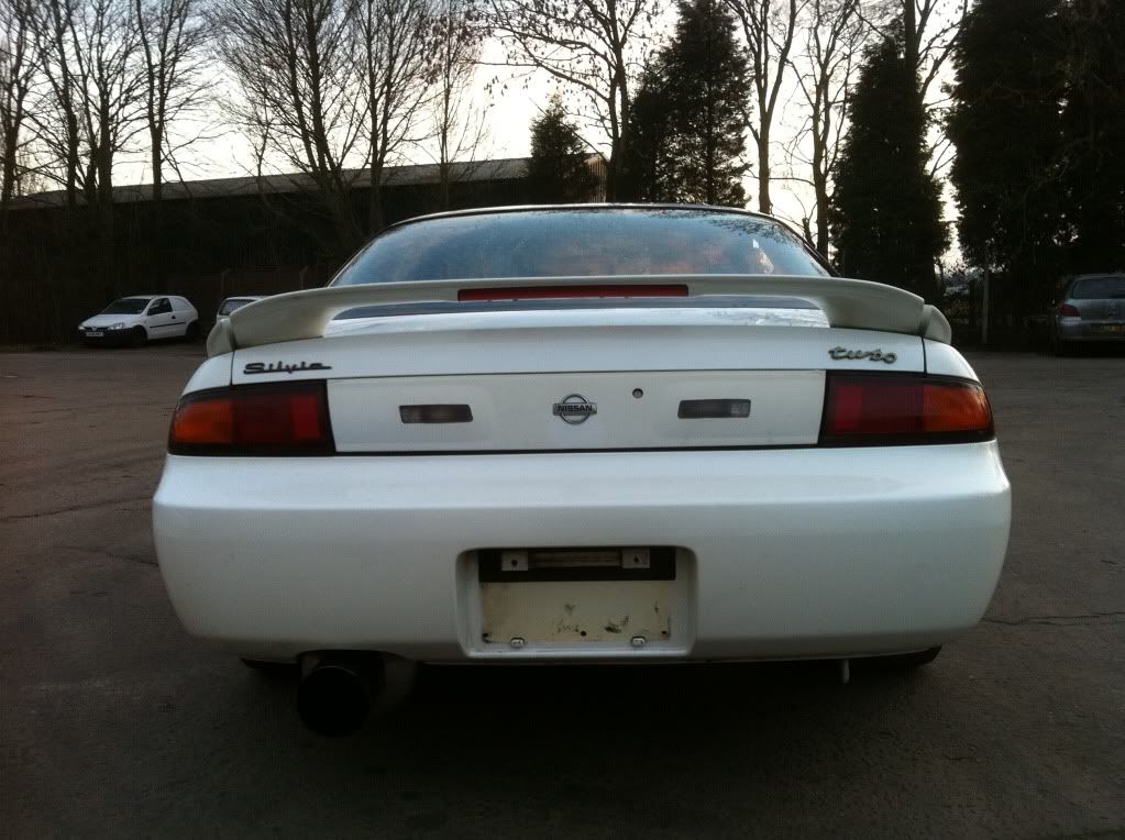

just a quick update about my project, car arrived from japan on wednesday and was delivered to my work in a 40 ft container with my brothers s15 spec r and my friends evo wagon! gona start work on it this weekend, driven it today and it feels really fast, hard to keep it in a straight line? im pressuming it has got a 2 way diff in of some sort? I found out it has a near new blitz intercooler, and big brake upgrades front and rear. Not sure what bhp it is but it seems to be boosting 1 bar but havnt driven it on the road. here are some pictures and will advertise all the bits i am selling soon.
picture of the s15 with the wheels on its running 255/40/17 on the back so looks cool
