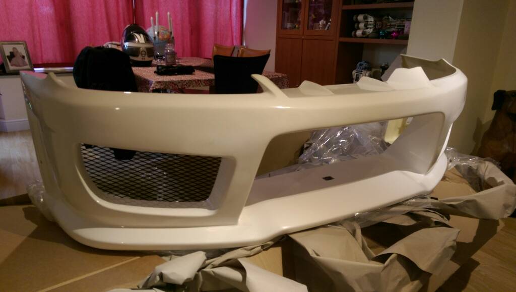

Finally arrived :)
Looking forward to getting it fitted!

Nice choice! I've got there old demo car with the whole Kit :thumbs:

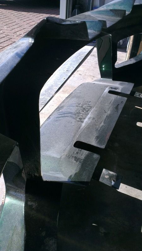

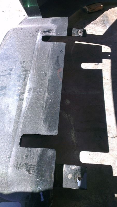

ok so here are the photos I promised you :thumbs: please excuse the dust, its 2 years worth :D
this is why the two slots are cut out, to avoid the intercooler mounts on the bottom but to keep the bottom bumper mounts, without these I think you would have issues with it moving around quite a bit, I could have cut more out between the tabs but I wanted to keep as much of the bumper as I could, the intercooler just about slides over the top of the part with the slots in it so its tight ha

having an under tray wont make a difference, I have one (not fitted in photo) and it doesn't support the bumper in any way :nod: my advice is try your hardest to keep the two bottom mounts if you can, if not make some brackets up to support it :nod:

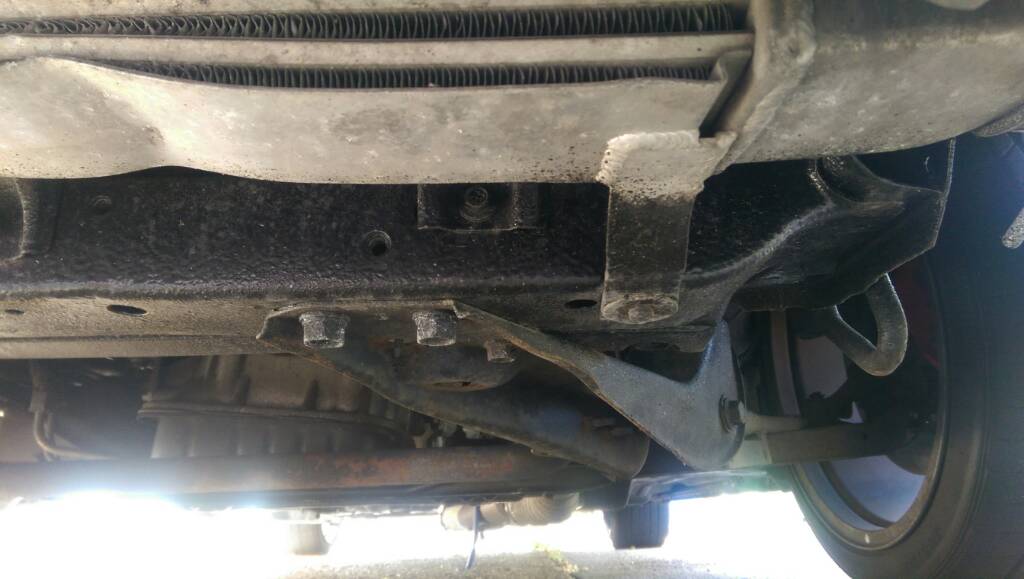

Oh sorry do those two bottom mounts bolt to the subframe or bumper bar or something then?

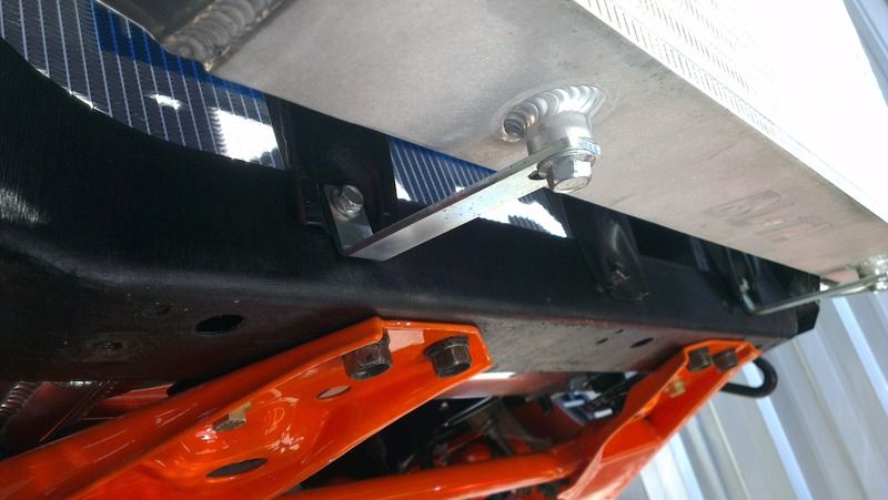

They bolt to the front cross member, you can just see the threaded hole on the picture of my intercooler mounts :)

Looks like my fmic mounts to the same point as the cs bumper...

Hmm and probably means the damages bit of my fmic will be on show. Might have to put the mesh across to hide it.

Yeah it does use the same so you should be fine :nod:
