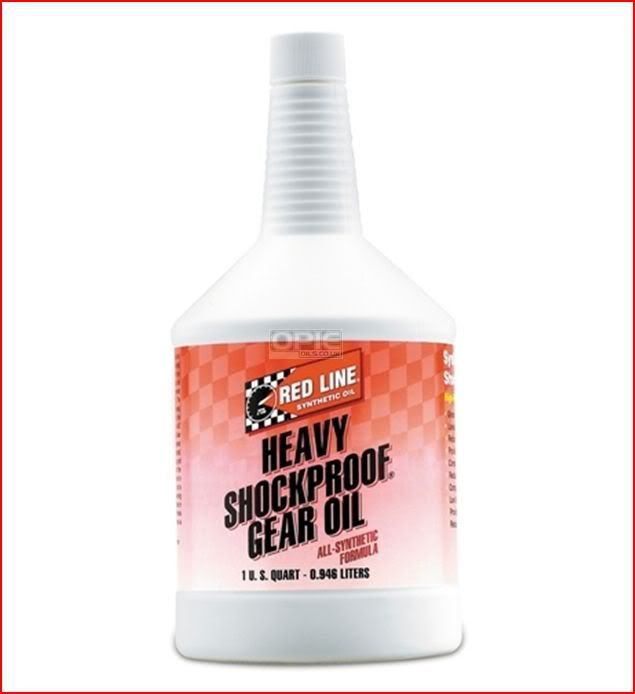

whats the best oil should be used in a 2way diff
if it makes difference its cusco
thanks
NP mate. Thats what I and some other members use in our standard diffs. I imagine it'll be fine in your 2-way too, unless Cusco recommend anything specific.
